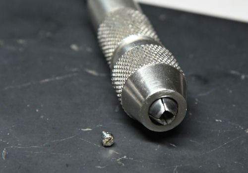

Over the last forty years I have serviced hundreds of the SRT series cameras and to remove the dot I use a simple technique that I learned long ago from a Minolta factory technician. Attach a small pin vise to the outer chrome bezel, turn counterclockwise and the bezel and screw will come out as one piece. Push the threaded tip of the screw on the bench while holding the bezel and the screw will come out with the red dot still attached and it can then be removed if it has not fallen out already. Photo attached is of my pin vise that is used for the Minolta SRT series. Yes, I have a stock of the red dots from decades ago but using this technique I can't remember when I last used one.
Well, the bezel and screw are separate pieces! That explains a lot because I never did try to separate them. Then the dot can be forced out but only AFTER the screw is out. Or ... maybe if it is half out of the camera's thread, you can then force the bezel down to force out the dot. Now, I have a much clearer picture and I am thankful that all repair men have not yet died!!!! - David Lyga
