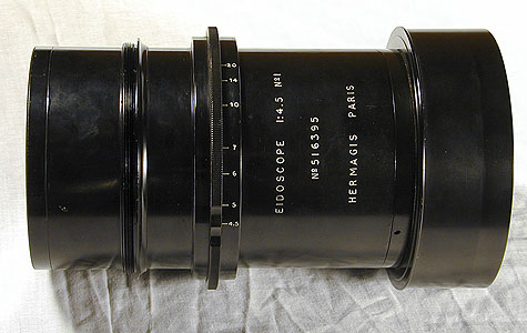

Well, this discussion has taken a life of it's own. Ralph, I'll guess you ripped a lens from a Holga and put it on a 4X5 board?
I've only scratched the surface but have discovered there is a bottomless pit of different looks that can be had from the different ancient lenses. The Petzval "look" is only one of very many. The task ahead is to really learn the strengths of each type well enough to know which tool to grab for which job. I'll admit that just now that seems daunting. Will I live long enough?
Here's a portrait of my friend Leroy done on Sunday afternoon. This was done with a Hermagis Eidoscope. It is a design very like the more name recognized Pinkham & Smith. It is 2 doublets like an ordinary Rapid Rectilinear but it is purposely uncorrected to cause the most beautiful diffusion. Unlike a Petzval, it is diffuse equally across the scene. You then stop down to your choice of glow. Here I used f10 which has nearly eliminated the effect. That seemed well for Leroy.

Jim,
What is the focal length of your Eidoscope? I have a 480mm version of that lens in mint condition that I've used a couple times for 11x14 wet plate work. It makes a beautifully diffused image. The highlight glow is amazing. Here is an example, but again, much of the effect is suppressed in a small jpg. The lens is a beast, but worth the effort.
Mine is a #2 which is 15 or 15 1/2". (here we go again driving the prices up,) Trashy worthless lens that Eidoscope.

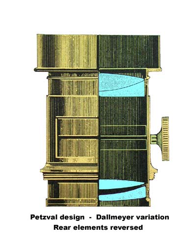

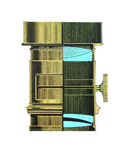

The Eidoscope is, as I recall, essentially a RR. In otherwords, as Jim pointed out, its the same design as a P&S Visual Quality no. 4. The RRs have really nice aberrations when the maximum aperture is taken wide. Note that the Hermagis Portrait is a Petzval. I do recall somebody posting pictures of naked women on the LF forum with one of them.
Kerik, the 3A is a modified Petzval, with reversed rear elements. After the patent was up Wolly copied it as the Vitax, although for some reason the Wollies I have used seem to have serious flare problems, while most of the Dallmeyers do not. See attached diagrams for details (culled from somewhere on the web, so my apologies if I am stealing...)
The Verito is essentially a Meniscus lens, like the Kodak Portrait or the Rodenstock Imagon, with a single element out front which serves to shorten the lens and reduce some of the aberrations. I have never done it, but the Verito can be used as a "convertable", just remove the front element.
In any case, I think we should all walk away from this thread remembering that not only do Eidoscopes suck, but in fact all SF and Portrait lenses are useless pieces of junk...
