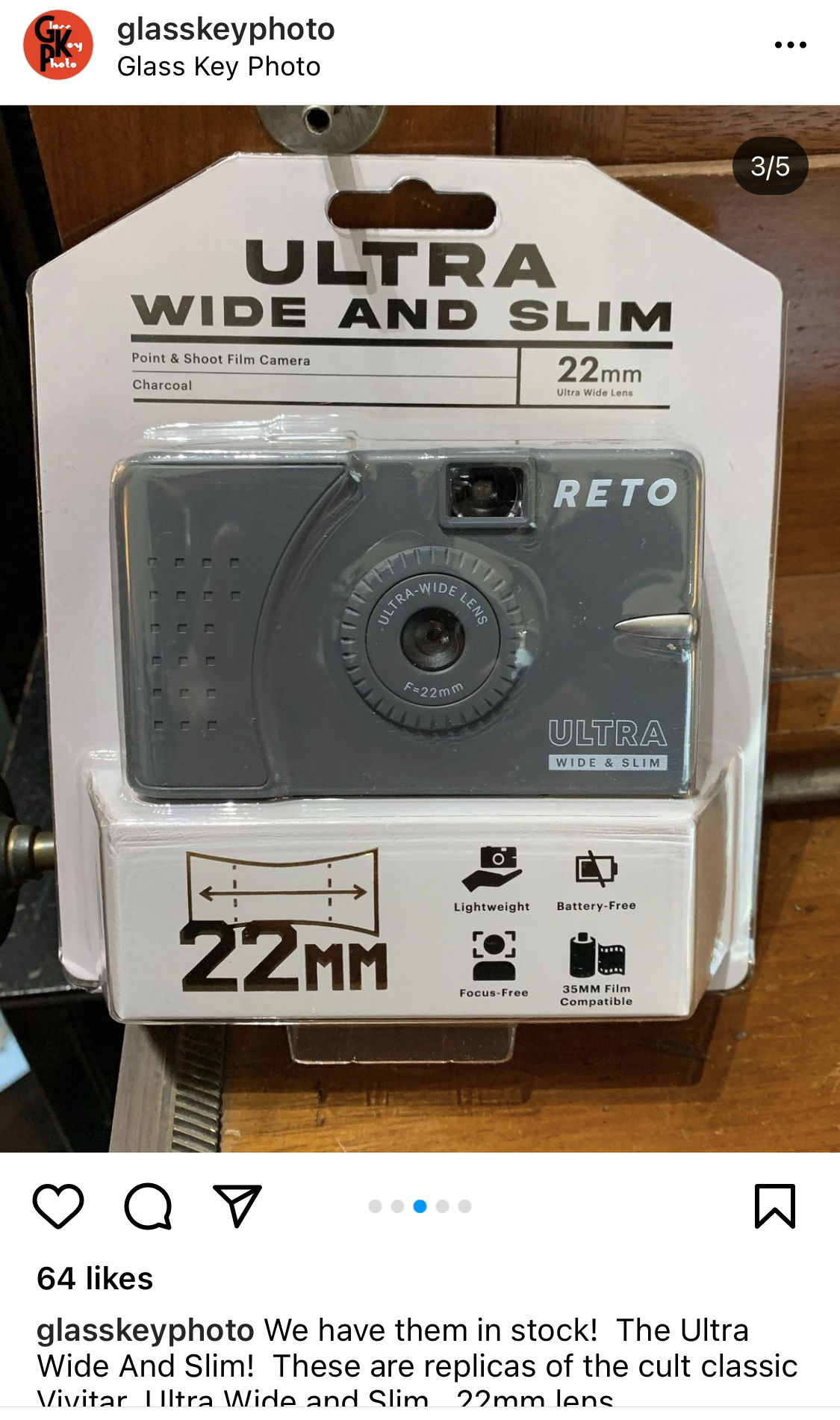

Best would be to bring a real good camera and a plastic piece of junk that can take the same film in case the good camera breaks. Never use the junk camera unless you have to. But don’t bring two pretty good cameras and switch back and forth..
Olympus XA, I was stunned at the Generalife and Alhambra in Granada how it conveyed the subtle color variations in reflected light on white walls. Contrast, sharpness, color, all very nice and it slides so smoothly in your pocket
This would be what I had in mind! Plastic and lightweight. Use it when that Nikon 35ti or Ricoh GR won’t operate. Otherwise leave it tucked in a corner of the pack.
