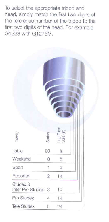

Here's a screen shot from an old pdf file that I had... If it comes through and is readable, it should explain the numbering system of the leg sizes.

That's a helpfull image,
but it seems that that Number that has come up several times in this thread is absent on the older gitzos...
or are the sellers looking in the wrong place?
Where is such a number located on the tripod?
How can I know what does two are ????

The cr3 appears to be a reporter, the #2 refers only to the head.Same situation on the other 3pod, except they're Studex legs with a #4 head.
The really nice thing about the Gitzo cremalliere center columns is the gearing is so low There's not a problem if you let go of the crank. The camera will just sit there rather than dropping to the end of travel.
The most accurate way to determine capacity is by the leg diameter mentioned in the above post.
Head capacity can be gleaned from th Gitzo web page.

That was my guess too.
number 1 a reporter and 2 a studex.
If I understand it correctly I could ask every seller to give me the diameter of the thickest leg, and then I can derive wether it is a reporter or a studex or whatever, by checking the diagram posted three posts earlier?
So the left tripod on the image above should have a 1.125 inch leg, and the right a 1.250 inch leg.
Is the right a cremaillere too? it has a geared column...
Is my conclusion right if I would say the left tripod is too small for my current pentax 67 en future 4x5 plans, and that the right tripod will do the trick?
Hope to get an answer to my question, I feel like this thread will get me there. Great!

I've just measured the top leg diameter on a Crem 3 and its 1.250 inch. That will serve you well. Incidentally neither of the 2 tripods in your pics have the very useful multi-angle leg spacing.

A way to identify Gitzo models from pictures - On 300 and smaller series the locking collar for the center post is a rubber covered one under the top of the tripod; you reach in between the legs to get to it. The 400 series has a cast metal collar with two "ears", located on top of the tripod. The second of the pictures you posted appears to be a 400, with the "eared" collar showing rather well. The first pic is a 300 or smaller - no ears on the collar (it looks like the collar is hidden behind the front leg). The 400 series uses a rubber collar to lock all the leg sections, just like the smaller series Gitzos. Finally, the 500 series uses the eared centerpost collar, like the 400 and in addition, the top leg lock collar has two ears rather than a rubber ring. If you look at enough pictures on eBay, you will start to see these ears on the different series tripods.
Some of the older Gitzos didn't have a number on the tripod, although I think most heads had a cast-in number. However, the heads are interchangable, so it is possible to find a 300 or 500 series with an R4 head, which an eBay seller is likely to list as a 4 series Gitzo.
I can't find my older Gitzo catalog, but as I recall, each series was available with 3 or 4 (and maybe even 5) leg sections, and long or short leg sections.
I have two Gitzos - a 500 series and a 300 series. I like the 300 as to weight, but I do not like the centerpost lock between the legs. I much prefer the ears of the 500; it is easier to reach, and locks down better. If I had to start over, I would probably choose a 400 series based on this. Both mine have the rapid non-geared center column. I can see the geared version would be nice for a heavy camera, but for 4X5 or 5X7, I think the non-geared is fine and slightly lighter weight.
I agree the multi-angle leg spacing is a very useful feature. Sometimes if you are in the field right next to a large rock or low wall, you can angle one leg up to set on top. And of course sometimes you need to angle all 3 legs out to get low to the ground.
Finally, I very much enjoy the fact you have continued to ask follow-up questions in this thread. Because Gitzo offered so many options and combinations, it is a confusing subject. The only way to learn is to keep questioning. I'm looking forward to further questions.
