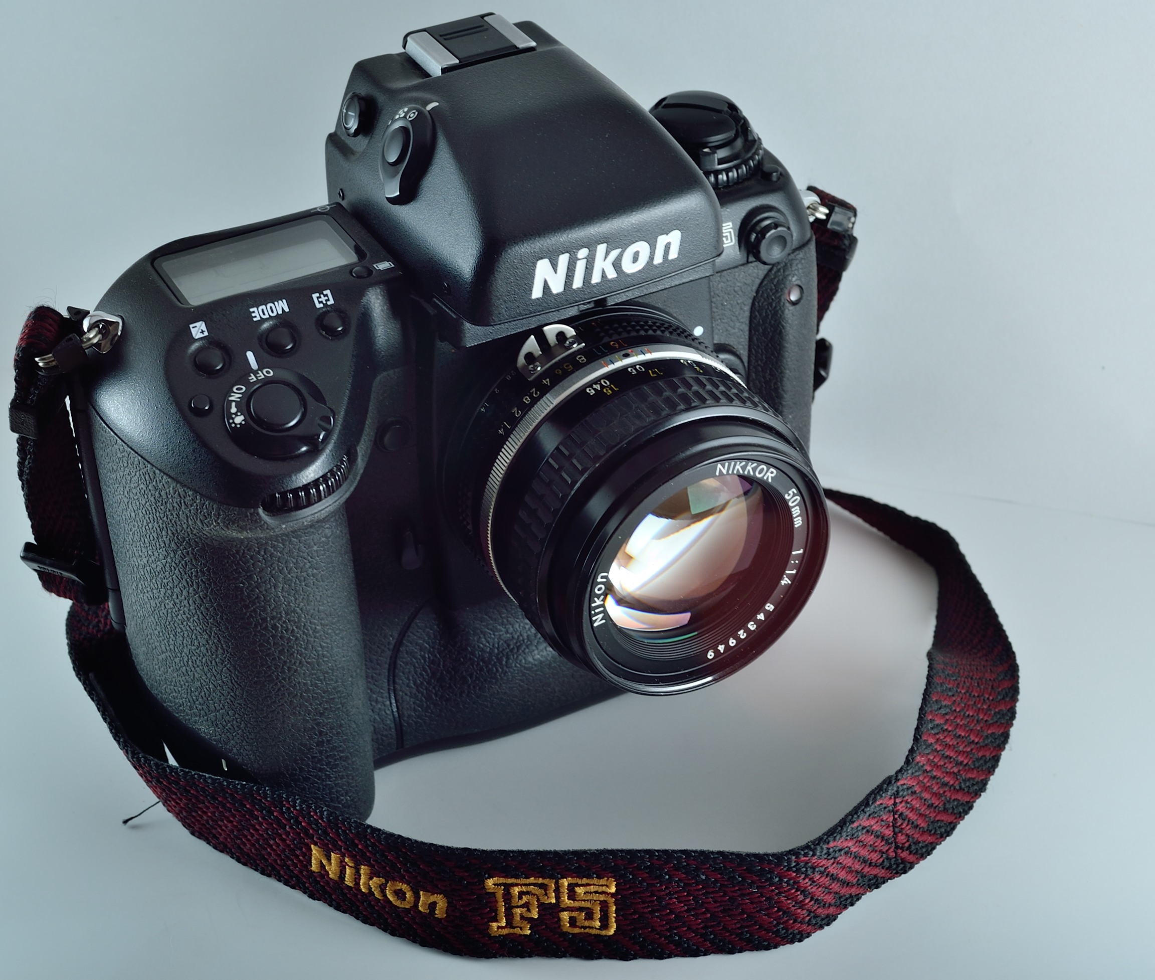

I paid $350 (I think) for this body sans glass from a member here.
