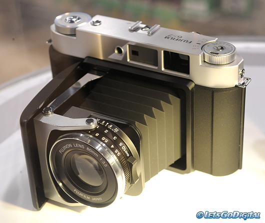

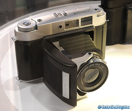

pictures
here are some pics of the proto...6x7 80mm 1:3.5.
I think it is safe to say that it WILL be 6x7 with an 80mm 3.5 lens....they would not be showing this unless they are in the position to ramp up production.
My guess is under $1000 USD....this could be HUGE in Asia.
I could see it at $750USD, judging from the pictures below.
There is a reason they would even attempt such a camera...there must be demand. They will make no money selling to collectors and people that can afford $1500 fixed lens cameras.
Voigtlander has proven the low price point business model for entry into a "dead" market.
