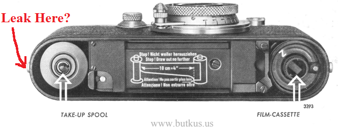

And the leaks are on the bottom edge of the film, when in-camera, which could be a light leak around the edge of the base plate on the IIIf. The fact that the artifact is not in the same place on each frame argues against a leak along the straight part of the back. If the leak was at the take-up end of the camera, the leak would move in position and get longer and/or farther apart as more film wraps on the take-up spool.

Yes the OP is moving the goalposts, the photo of the lady walking up the path was cropped in the first post or we'd all have seen the orange flare. Nevertheless he's interested in the blue band although I suspect both will be connected. One area that may possibly cause a multi directional leak besides the rivets (post #29) is if the end of the tripod socket has been popped open by using too long a screw.

I've seen it suggested frequently to tape up the camera body successively, taking notes, advancing the film and moving it around in full sunlight (for extended time) for each step/area of the body to identify the leak(s). In your case an intermediate step should be checking the cassettes in a similar manner.
