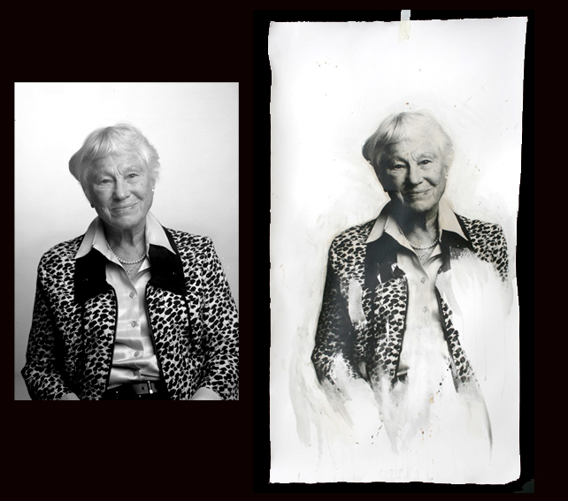

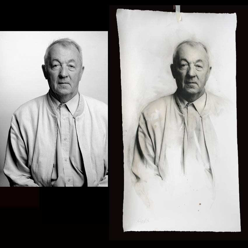

I have now photographed the sweet couple (Frederik and Birthe), and just finished applying liquid emulsion on rather big heavy paper (50x100cm)...
So far so good - now comes the difficult part: the bromoil printing...
first of all, I have never done such big bromoils before - and just the bleaching out process was quite a challenge, as my trays are not nearly big enough (and the chemistry used is rather poisonous.......)
But I think I managed /still alive). The bleached image looks little strange - I am hoping it will be ok - or I have to start all over..
I made a faint pencil drawing around the main areas I wanted in the pictures, and then I applyed the emulsion kind of rough and "random"..
I have taken a snap of both the original straight portraits, and the pictures as they appear as liquid emulsion prints...
Tomorrow, I'll see if the oil will work with me or not.. and submit my results - good or bad...

I have that book too... but it doesnt explain what happened - normally the whole image more or less dissapears - here some silver remained and some parts looked quite yelloish in colour..
I am working with liquid emulsion, and as I remember W Crawford was talking about "normal" papers...
I think I might have put too much emulsion on the paper at places... then yelloish patches will appear.. (the light can't penetrate all the way through the emulsion - leaving unexposed (and fixed?) silver in the image....

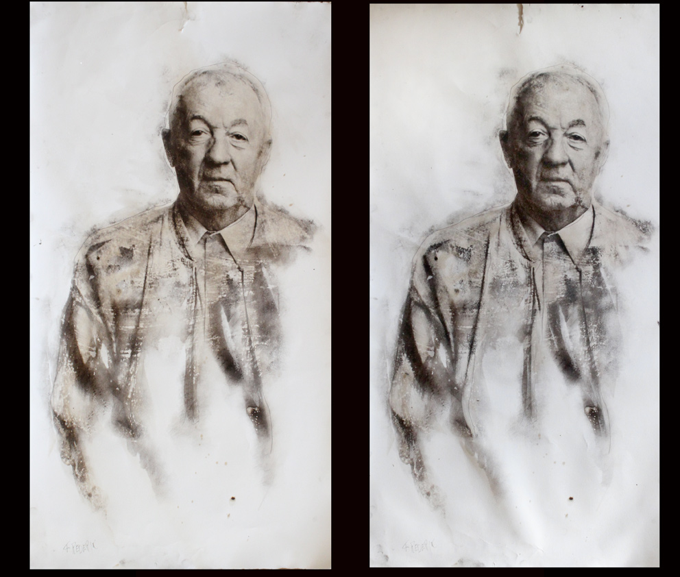

well - yesterday I inked the images for the first time, and as I deared, the inking was hard work....
(BTW: I don't use brushes for liquid emulsion bromoils, but spunges..)
The images turned out too flat - so I left them to dry over night, and now I have just added some more blacks into the images..
Too much? I am unsure (the images submitted here are actually higher in contrast than the originals..)
Maybe tomorrow, I'll add some warmth to the images.. maybe some more pencil drawings, or maybe I'll tone them in coffee (I think the white background is a little disturbing - makes the contrasts higher..)
Again: time will tell - I havn't given up .. yet......:whistling:

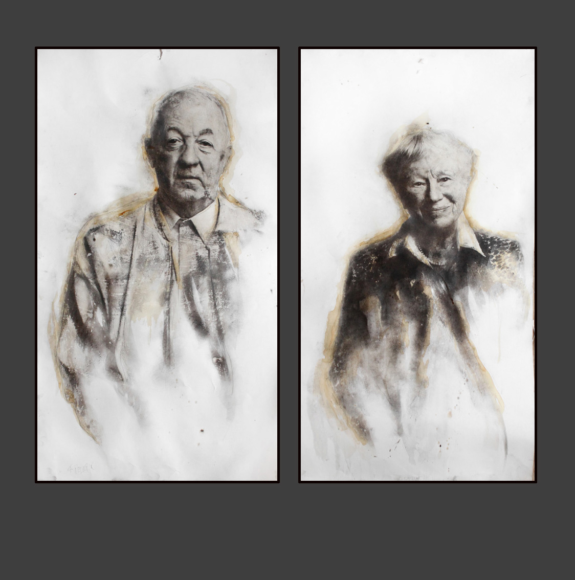

almost there....
(I uploaded the image in the gallery too...)
now added some strong coffee to give warmth...
so what about the background - that's my main concern now..
Leave is as is, or change it and then maybe destroy the whole...:blink:
