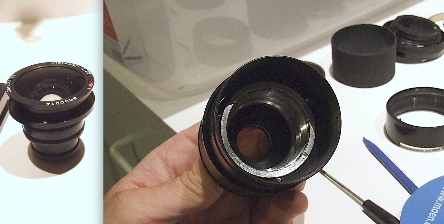

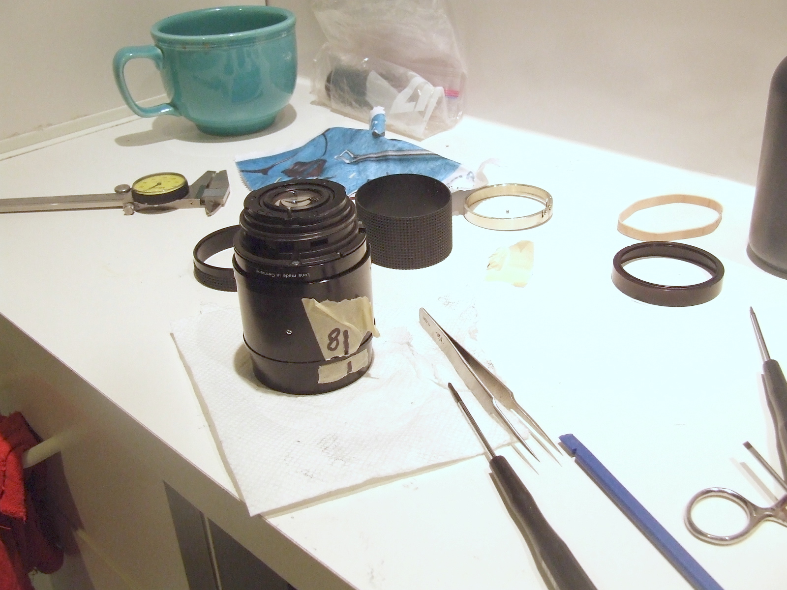

I dropped my coveted 28mm f2 Distagon in 2009 and spent quite a few hours trying to get it apart. I set it aside and in 2015 I re-assessed the problem. The front ring unscrews, showing the screws for disassembly.
This lens is not a zoom, but it does have TWO HELICOIDS. The second helicoid, for the moveable front element, was difficult to get re-aligned. I had to assemble it and do actual film tests looking at the frame edges, to see if I got it correct. Good news is that when the front helicoid was off by only one groove, the edges were very blurry and it was clearly obvious.
BTW the actual repair of the bent housing was quite easy, it was just a slight bend in one of the three 'feet' holding the inner mechanism together.
Did you not learn at Apug to mark that helicoid orientation when coming apart...?
Excellent question. The main helicoid, was of course marked, but the secondary one is very fine, you can see that in the picture from post #3. My 'index mark' was the "Z" which you can almost see is aligned with the slot right below it. The helicoid was very difficult to detect when it was engaged at the correct spot. In the second picture of post #3 you can see the index lever which engages the slot under the "Z." (looks like a white line at ten-o'clock).
FYI: On this lens the front element spins as you focus, but the outer housing which holds your filters, does not spin.
After that whole experience, I'm not so bothered that my 50mm Distagon for the 6008i has a MANUAL ring for setting the front element (it is not connected to the main focus).
