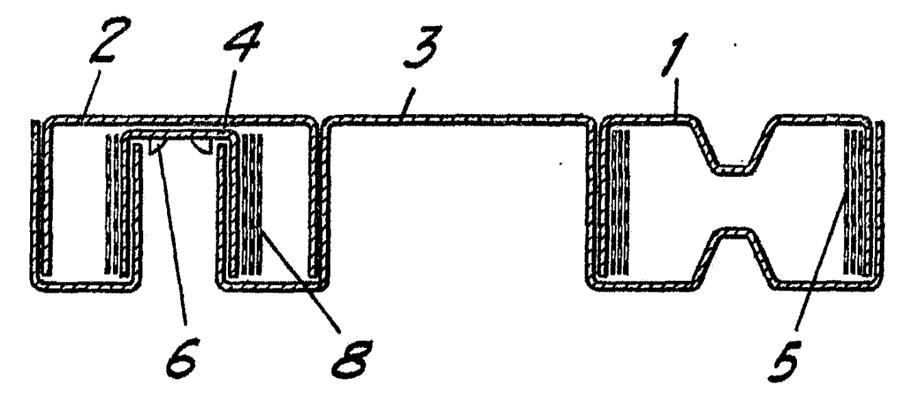

This is the sectional drawing of the metal cassette from the original patent specification. You can see that the film chambers have double walls.
If you ever open one of your cassettes, please let us know how big the inner diameter of the film chambers is.

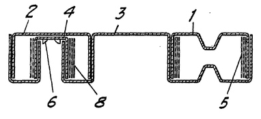

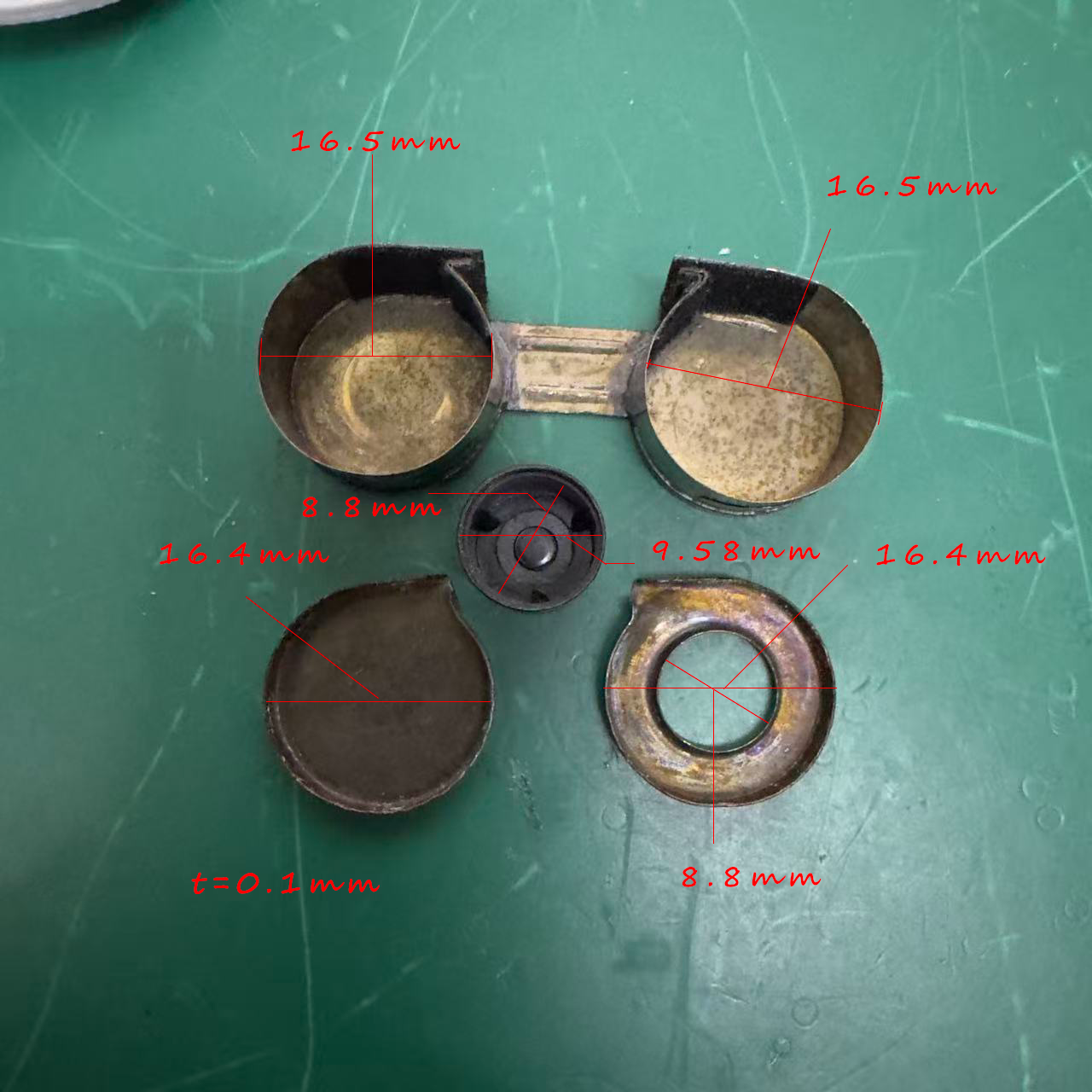

These are the dimensions I measured previously, so they may not be entirely accurate.
If those measurements are even fairly accurate, I should be okay with most modern B&W films in the metal cassettes -- those seem to have more than a millimeter larger inside diameter than the modern plastic ones. I'll know when I get my darkroom cleaned up enough to slit a roll and run it through the camera into the takeup chamber (likely going to start with XP-2 Super, which has no reason to have the thickness of color, but will let me get EI 640-800 via bleach bypass).

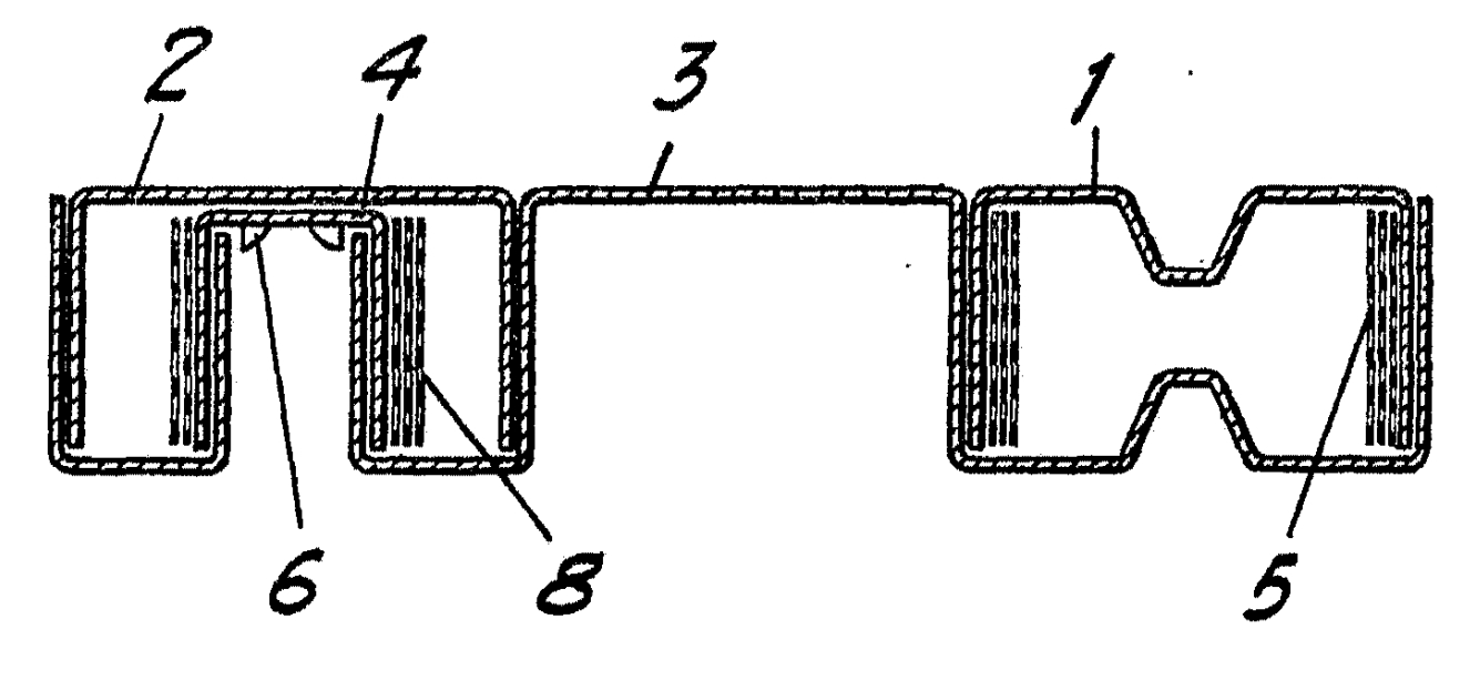

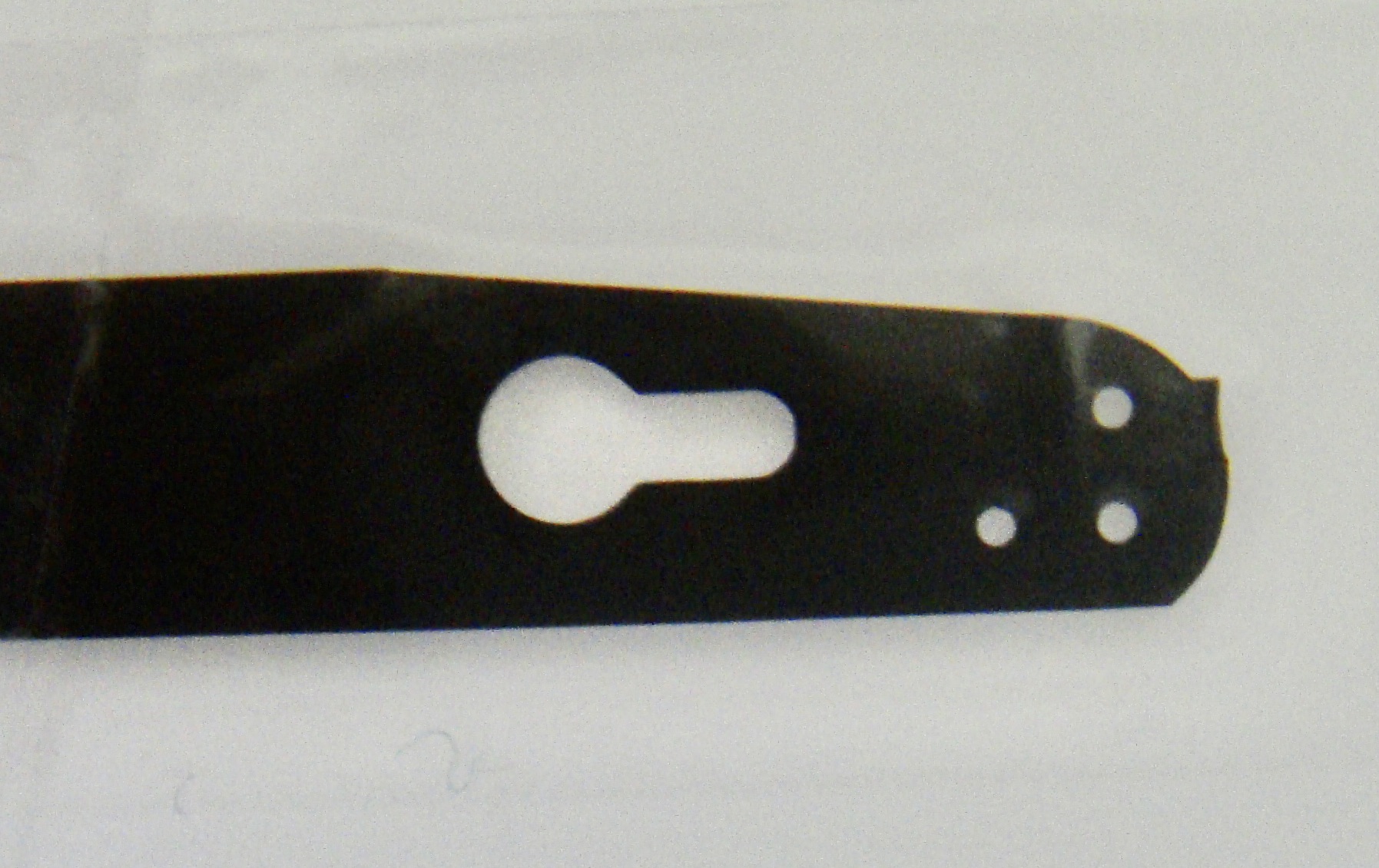

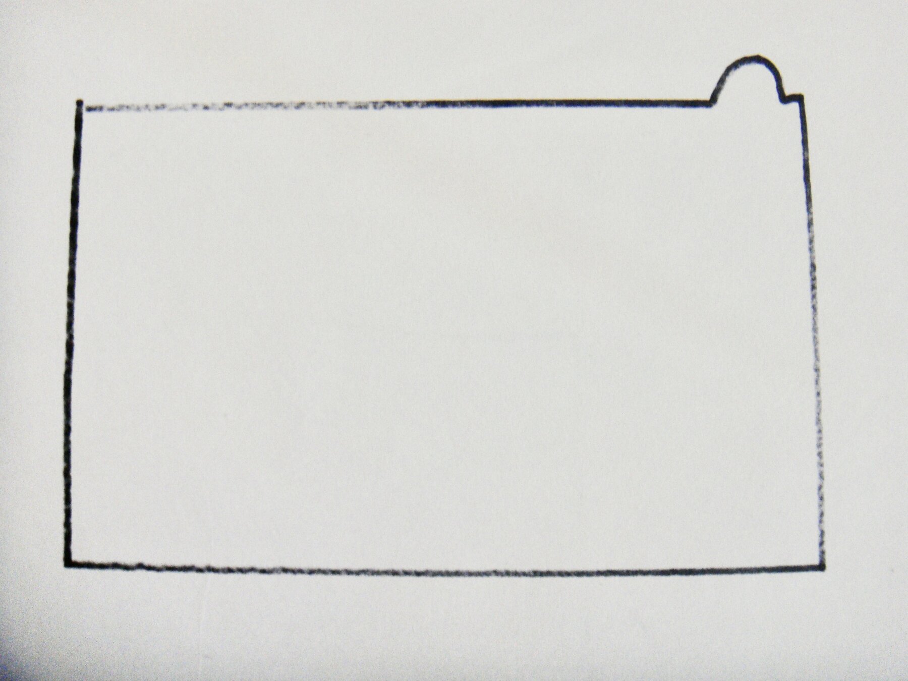

About 40 years ago when I was at the Minox factory in Heuchelheim they supplied me with the punch codes that are located on the ends of the films used to identify which film types were which. They also supplied me with the camera identifying codes that are imprinted on each frame that identify which camera was used to take the images. These are the small pips on the outside of each frame that are in different places on the frame depending on the camera type. Unfortunately a lot of time has past and I lost that information. It might be interesting to try and restore that information for all the Minox users. The film code punches in the picture attached was for a very old Minichrome sample.
Good luck

Thanks for the tip and the photos. I’ll look into this and write a summary.
I have the information on camera type codes somewhere, but I don’t have the point codes for film types. I’ll look into that, though. If anyone here can help, please post here.
