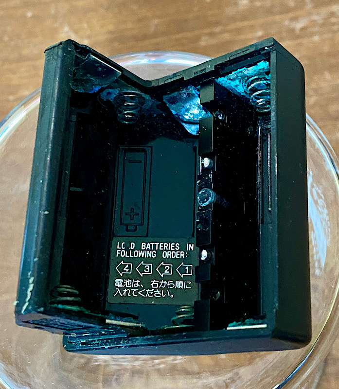

I have a question about Durgol: Such decalcifiers are used in coffee machines and hot water makers. The acid is diluted with water and heated.
Does it work without heating?
Durgol doesn't undo damage to the coating and metal, of course, but it removes the battery electrolyte and so stops corrosion.
If the contacts have lost their coating, they are more susceptible to rust.
Maybe applying conductive silver will help, but I don't know if it is suitable for high currents.
If necessary, I use the small Dremel for rework and then spray electronic cleaner onto the contacts, which forms a protective film for a while at least.
Rinse well with water and then dry with a blow-dryer to prevent rust from forming.

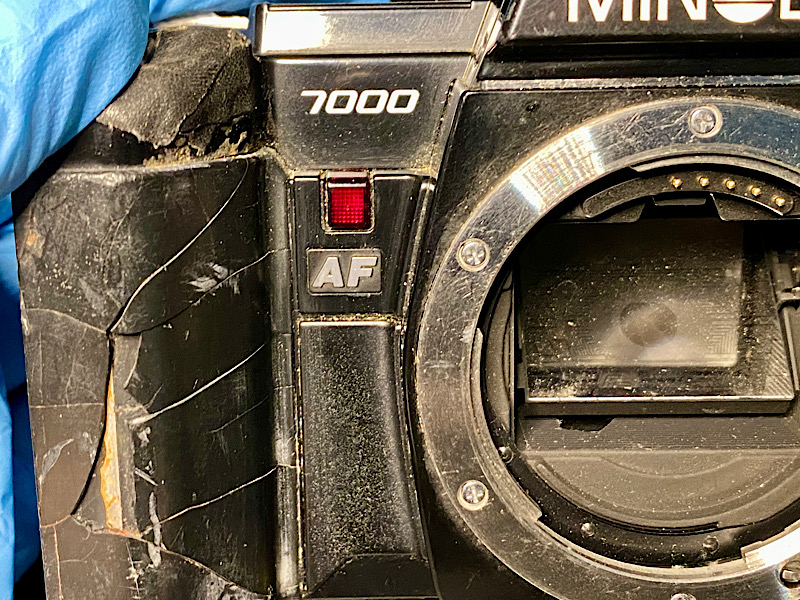

The adhesive tape around the shutter button is interesting.
The plastic falling off the handle and back door affects many 7000.

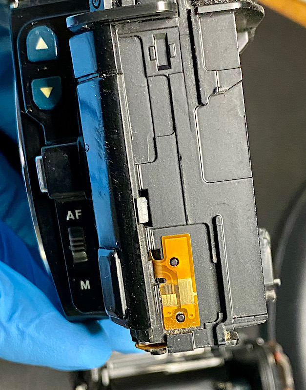

The contacts for the automatic film feed when the back door is closed.
Now I understand why I see these contacts: the locking mechanism remained on part of the back door.

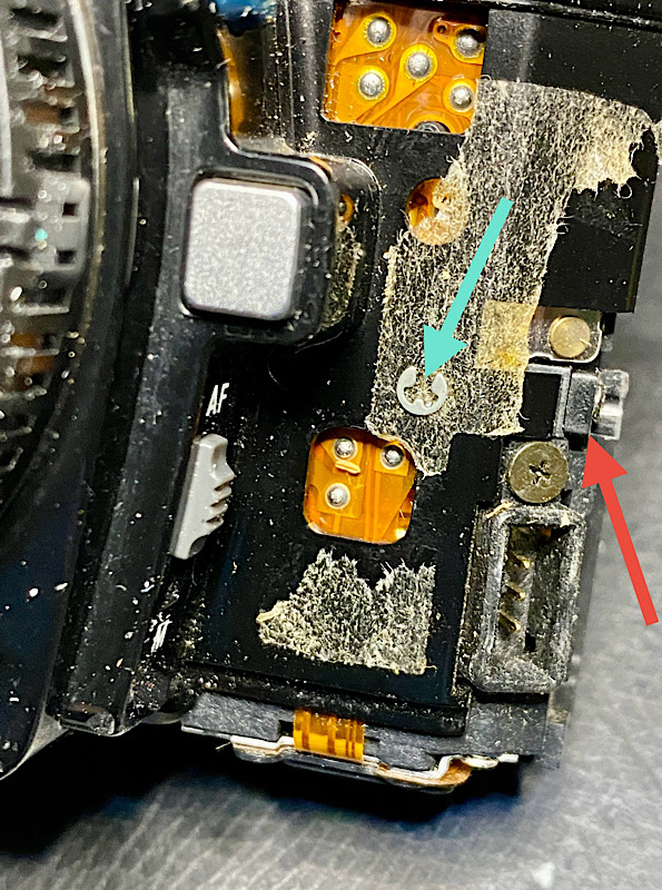

The red arrow points to the broken bracket of the back door locking mechanism on the case. This happened when the back door was removed.
The turquoise arrow points to a circlip that is stuck to the adhesive residue on the plastic cover. How did it get in there and where was its position?
I don't know it.

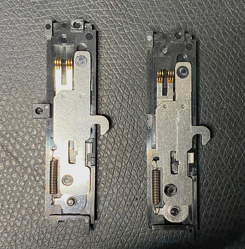

On the left is an intact back door lock from the spare parts box with bracket, on the right is the one removed from the 7000.
