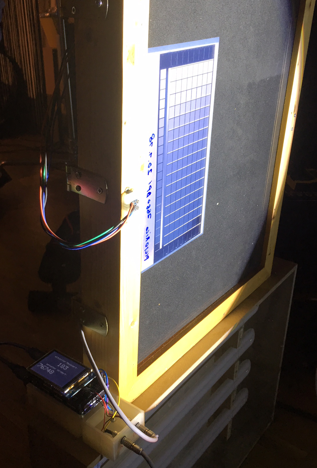

hehe peter jep i wrote it under the video sorry :D so here a little more detail and recap: i used pictorico ohp foil printer was an epson 1500w with capefearpres bw ink the negativ i printed with quadtone rip and the quad curve was profiled with bwmastery.com excel magic sheet :smile: then sandwitch in my exposure frame and exposed to an hmi showtech 575w followspot used in the theater. and here my little helper called "dosimeter" stoped when 78000 units are reached thats the dose i figured to get max black which works perfect repatable :smile:
here is a picture of the frame and dosimeter :smile:

Thanks for the link. Do dye inks have concern with interacting with moisture on the paper, if any? I am thinking of converting an old Epson for printing diginegs myself.
no problem so far i let the inks dry for 20 min or somthing and there is no smearing also my kallitype emulsion dries for 20min and is then relativly dry :smile:
bigger problem is the foil so far ONLY pictorico works with my epson 1500w and the cape fear ink at 100% at the moment i make a test with fixxon which looks vers promissing ink limit is around 75% fingers crossed :D
