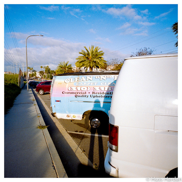

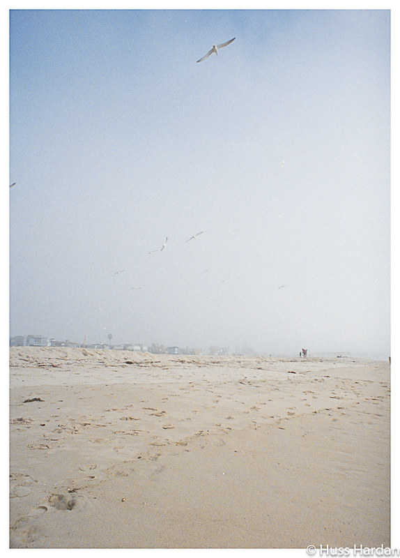

Here's a weird and perplexing thing about this camera. When I shoot it in half frame/constant pano mode, the pics come out exceedingly sharp. Like I can make massive prints from it sharp. But when I shoot it in square or regular full frame format, the camera seems to front focus quite severely so outside posting on the web, the images are very soft.
There are only two focus settings, and I am making sure to use the correct one! I also verified that the lens moves between the two settings. And when I make those half frame panos, the front lens cover is in the same fully open position as if I am making a full frame shot. The only thing that is different is the film advances only half the distance per exposure. So I am thinking when the film is fully advanced for a full frame shot, for some reason the film flatness is no longer optimal.
See pics attached. In full frame mode - only the grass at the front is in focus even though the camera is at infinity. In the half frame pano - everything is pin sharp - same infinity setting.

@Huss, I doubt that 0.9m-Inf position is actually infinity, more probably hyperfocal, but still infinity shouldn't be too soft (hard to judge from your 800x800px examples how soft infinity is). Anyway, thanks for doing the squares!

W re. to my camera, the focusing is accurate when used in that half frame format where I made the continuous strips. Literally pin sharp. So I think it has to do w the film advance in the FF mode that for some reason no longer holds the film flat. Anyway, to test that theory I just shot a test roll in the 1/2 frame format again and will find out tonight.
Yours of course may be fine in both FF and 1/2 F! I wouldn't mind if I can only use mine in 1/2 frame, as I bought it for that purpose.

Dev'd/scanned my film. Yup, shot at the 1/2 frame advance but in full frame mode it is crazy sharp! So obviously when it is advanced in full frame mode, the film is buckling and/or loosening which is why the pics are out of focus.
Very weird, but to me actually inconsequential because I bought this to be used as a 1/2 frame camera and also make the 1/2 frame pano with.

That's very odd.
So you HF advanced film twice (one shot with lens covered), took a shot, changed to FF, advanced the film, took the same shot and the first shot was properly focused while the second wasn't?
Did you also try to manually tension the film with rewind lever after FF advance?

I compared the rolls I shot in FF mode to the ones I shot in the half frame mode. Every single image on every roll I shot in the FF mode were very soft - basically out of focus - from mid distance to infinity. Remember, this is a 17mm lens with basically infinite DOF on a sunny day! Every image I shot in the half frame mode is pin sharp.
I did not manually tension the film in either case - which would be a thing to do for sure - but I did make sure to check that the film rewind knob turns appropriately every time I advance the film. Just a force of habit thing.
Next time I use it, I will shoot a couple of images in FF mode - one as normal, the other with the film intentionally tensioned, then the rest in the 1/2 frame mode.

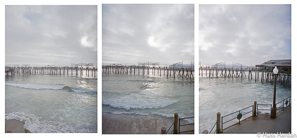

Huss, my long search to bag an LC Wide has paid off, with a fairly new, but non the less second hand one heading my way (seller says he’s only run one roll).
Your 1/2 frame panos influenced me, and I’m wondering if you could share your technique for digitising a fairly lengthy strip of negs making up the pano. (I’m assuming negative lab pro for post production.)
