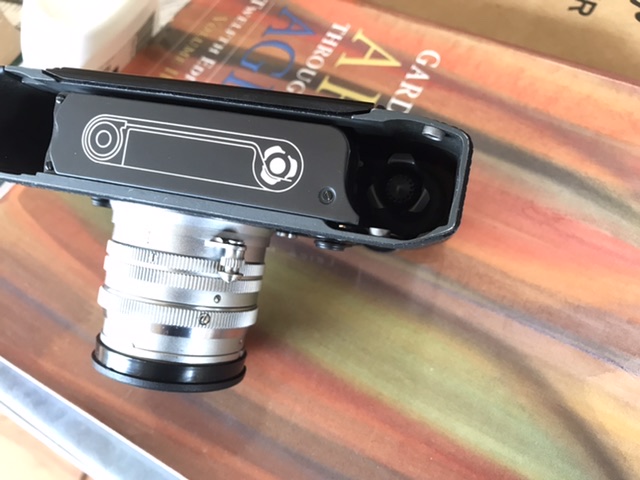

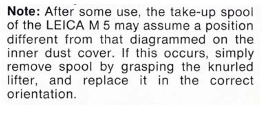

Are you saying that the “tulip” comes out? ...and apparently does so by design? I’m having difficulty visualizing this...could one of you post a photo ?
The take up spool comes out. It’s not a M5 exclusive clever design. It dates back all the way to the barnacks, about 100 year old.
Yes, I understand plain English. I cannot see how it comes out.
One must have to have very long, very thin fingers.
I see the knurled knob in the center of the tulip. It is way down in there on my M5 (see photo in post #6). No way could I grasp it with fingers...does it pop out somehow?
turn the camera upside down
