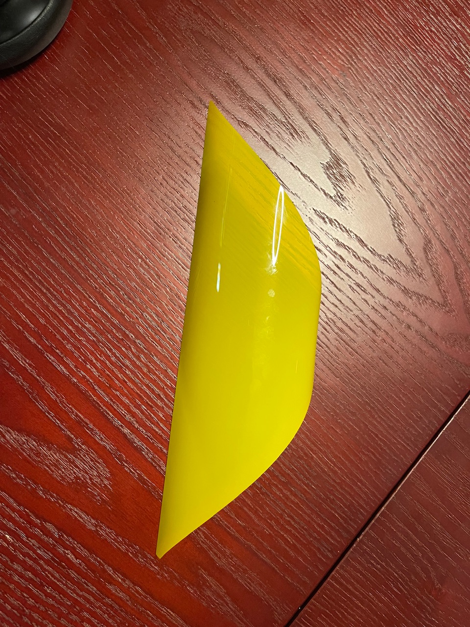

As far as I am aware I’m the first person to actually doocument using this film pictorially, aside from one user on flicker in 2022. First observation: YELLOW.

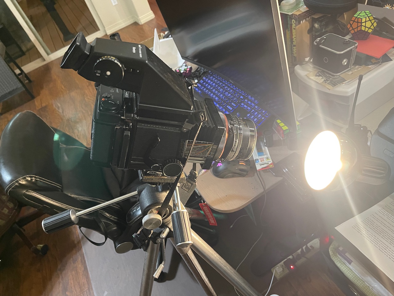

I cut a 60mmx24cm strip that I ran through my RB67 and took a picture of a light bulb because otherwise the exposure time would have been like 2 minutes… did 0.8 ISO and 0.4 ISO pictures.

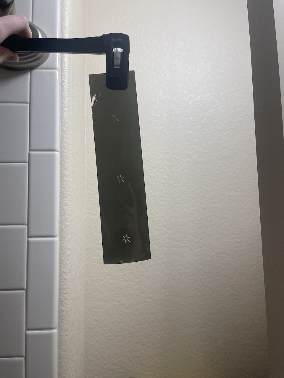

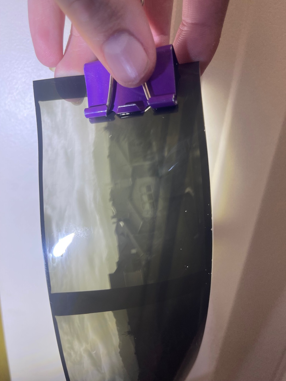

It works! Admittedly it’s a terrible picture, but at least it proves the film works.
0.8, +1, +2

Making another few rolls for testing, I’m getting in more HC-110 this afternoon so hopefully I’ll have more progress to share soon. I think I may have overdeveloped this roll but we’ll just have to see.
Well, 20 minutes in HC-110 B gives what I believe are scannable results at ISO 0.8, And projectable results at +2. +1 is somewhere in between.

Quite interesting. +2 still seems kind of dark though.
Are you planning to use this material for projection? Or for dupe purposes? It seems useful for the latter in particular.
Sorry, looks like the image loaded upside down, +2 is on the left there. As far my use case? The idea is to make slides, pretty much.

As your box states, 2422 was a duplication film for black and white aerial film. Thus, it is an orthochromatic film which is sensitive to blue light. The yellow color comes from the yellow sensitizing dyes incorporated to capture the blue light.
It would make zero sense for Kodak or other manufacturers of duplication films to make this film panchromatic because that would only increase the costs to manufacture while reducing the film's image characteristics. In the motion picture and consumer films businesses, other black and white duplication films were also yellow and orthochromatic, although they may have different hues / shades of yellow.

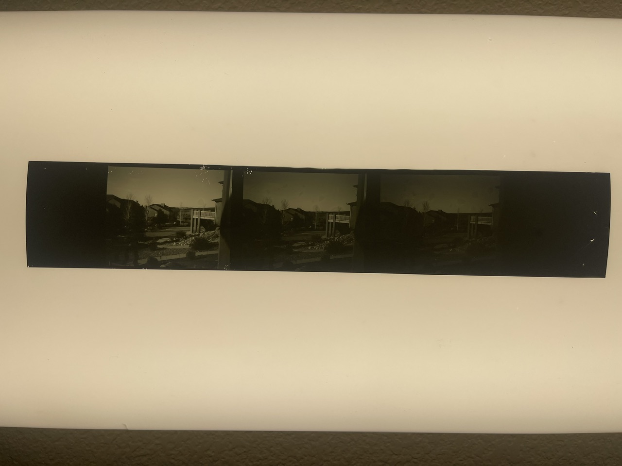

ISO 0.025 seems to work well… a lot slower than I was expecting, but hey, it works!
I don’t have a light table, and I think I moved during the exposure, but the dmin is good and there’s some midtones

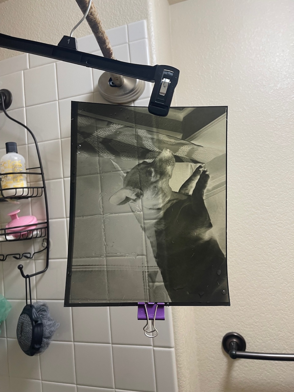

I shot a 4x5 sheet of this in my Chroma snapshot camera. Rated at ISO 0.1, 15s at f/16
Developed in DD-X 1+4 by inspection for about 10 minutes

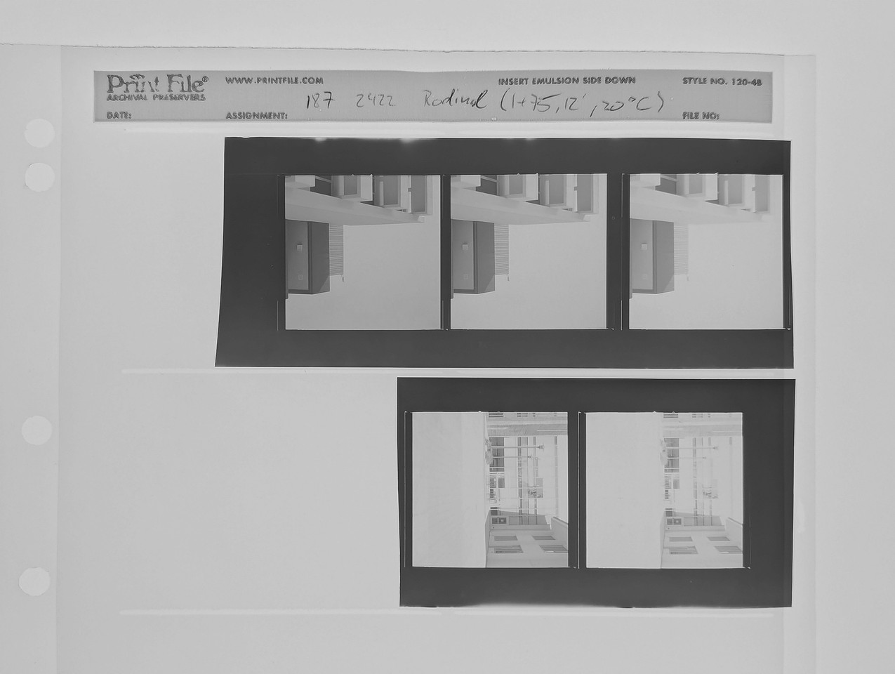

Rodinal crew checking in. ISO 0.1 in 1+75 (12 mL + 900 mL) developed for 12 minutes looks about right.
I keep seeing results that indicate to me that I might have been absolutely cooking this stuff in dev… might have to try it again at some point
