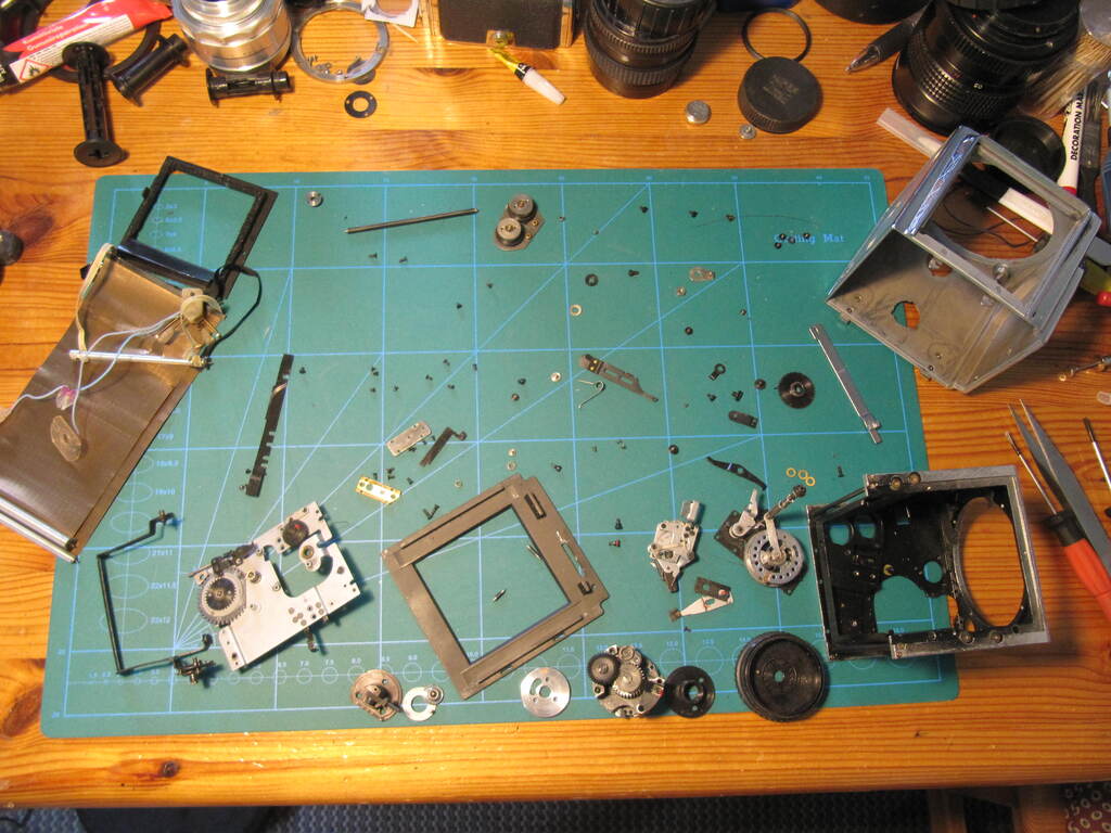

I am servicing some Salyut bodies and one Kiev-88 I have (jammed shutter, banding, 1/2s speed fix and in general that could have a cleaning).
It's a bit tedious to screw these boxes when done just once in a while and it's good to have a technical summary, some instructions here and there, and the whole diagrams of assemblies and parts.
the Tento booklet for the Kiev-88 is available online since long but it's quite succinct.
I have otherwise a mint exemplar of the booklet published back in the time in Moskva for the Kiev-80 which was the rebadged for export Salyut-S.
for practical reference while tinkering the camera, I use instead prints of a scan I made of it.
I thought it may be of some interest for the few around there who are addicted to the Salyut.

these technical manuals help tremendously of course, yet what I did was to get a couple cheap bodies, a broken one and the cheapest working one available, in order to play with and become familiar with the beast.
