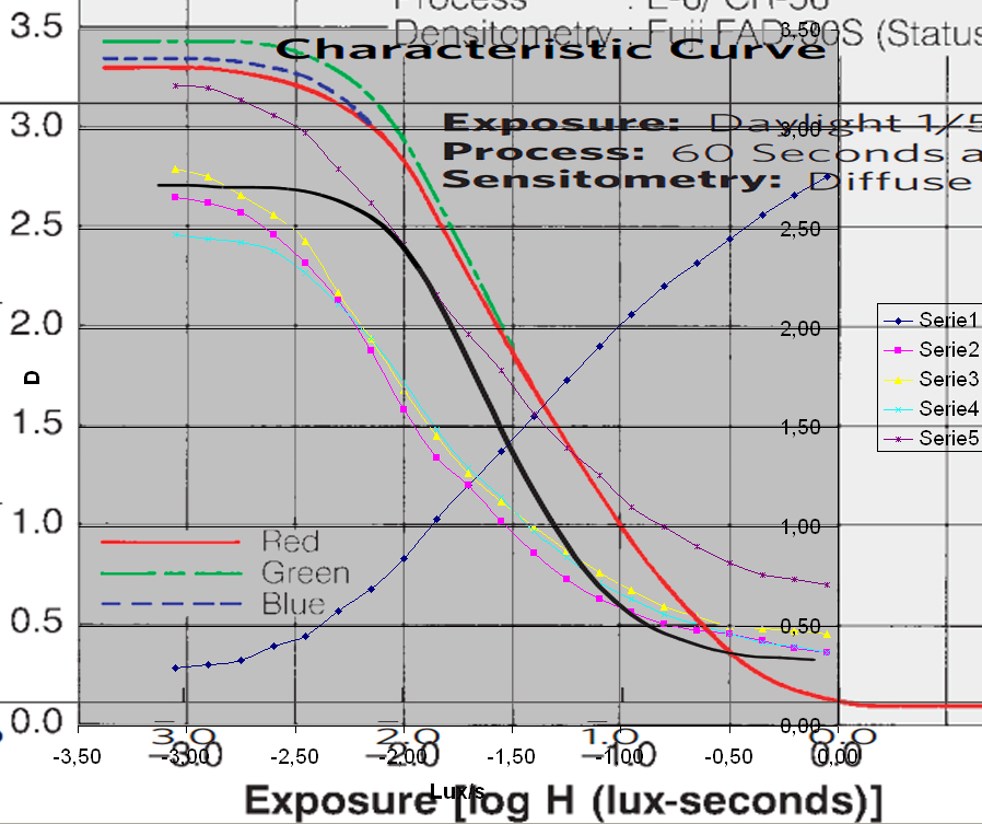

D-94, as a reversal developer, it also requires insane energy for contrast plus solvent effect to drill in the highlights for a lower DMin. Destroying film in reversal BW testing is my speciality :smile:
Now what I do is H log and D aligning graphs of Provia, TX reversal and my calibrations, this was a flawed test last weekend, showing positive an reversal calibration, there is a silver reserve that's difficult to develop in the first developer and if it's not cleared it delivers fog. In that game we always end in high energy for contrast.
I found a good strategy is calibrating the reversal to nail provia sensitometric gradient, from the H shift in the curves vs provia the good ISO can be calculated, so after the calibration is ok one goes to shot in the street like if it was (ISO corrected) provia and the slides are nailed.
