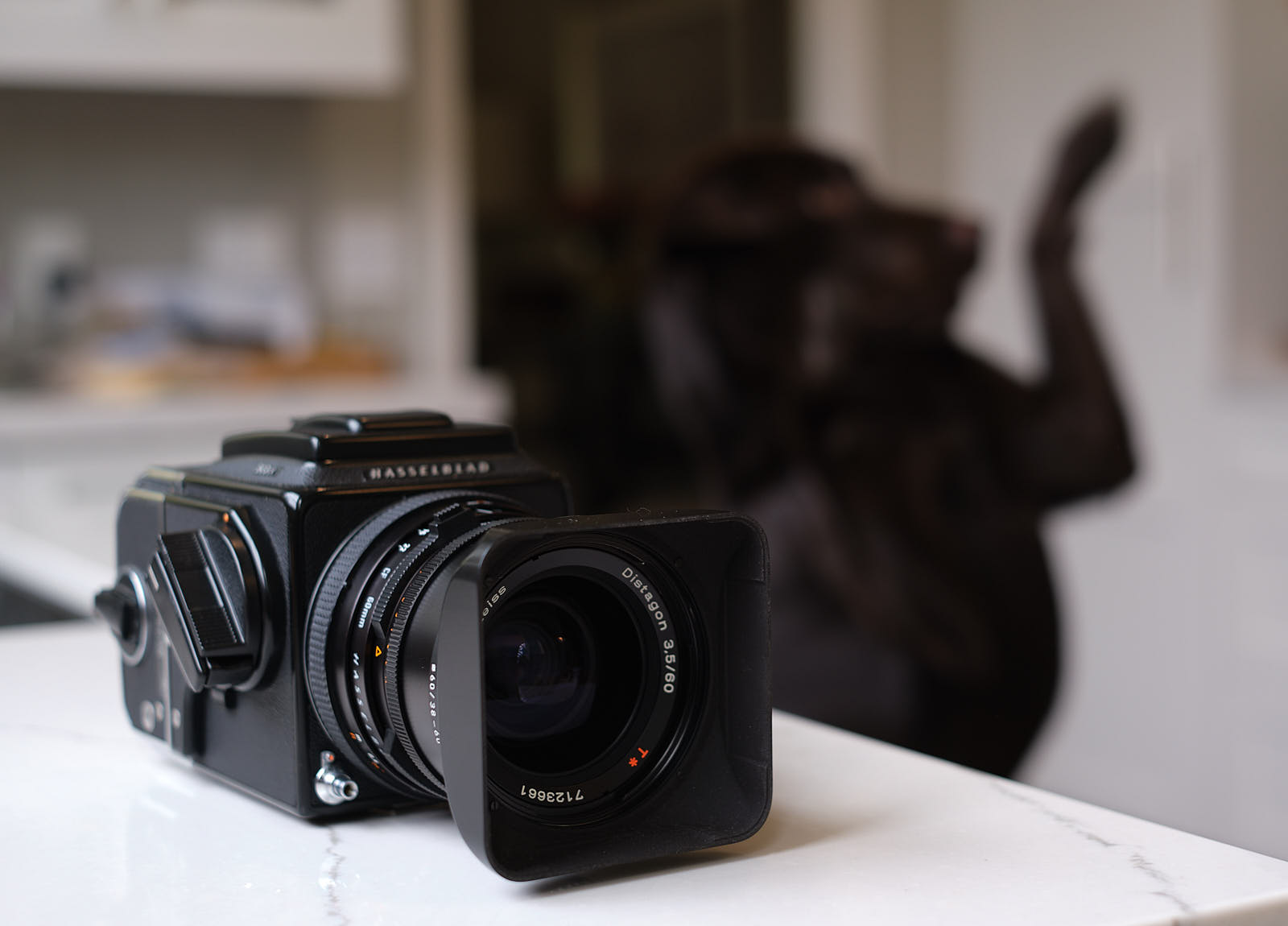

IT HAS ARRIVED!
The dog is celebrating HARD in the background:

See? I'm a quick learner. My ratio of taking photos OF a Hasselblad vs photos taken WITH a Hasselblad is already >1!

looks like a beauty!

Thank you Brad. The fit&finish is supreme, but what's shocking is that it's not heavier or bulkier than a Mamiya 645 Pro. This means it comfortably fits into my existing bag.
The body wasn't cocked, but the lens was. A perfect trap for an unsuspecting soul!
