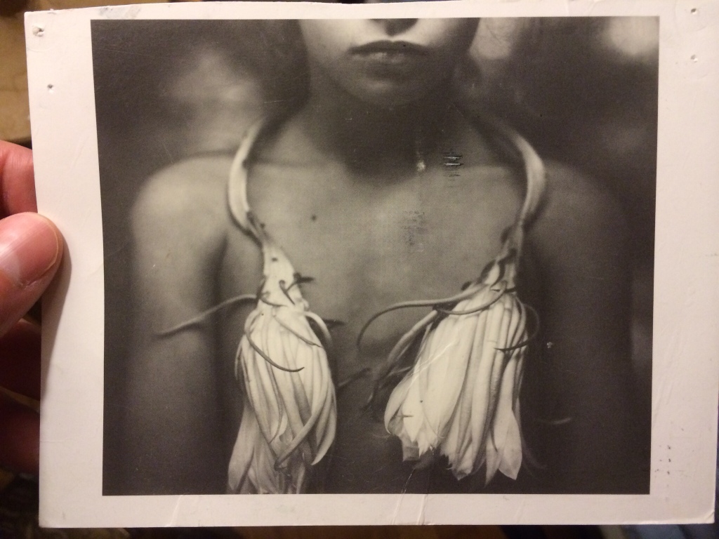

So I was over at a friends house, and I happened to notice this photograph in a frame, it had been sent to her by her sister, and was a postcard, the image looks very familiar and it was driving me crazy because I knew that I knew the artist and I thought that I need the model too, it just looks so familiar.
After staring at it for a long time I realize that it was Sally Mann.
Anyway, I got to thinking about her book that had been given to me by my ex for a Christmas gift, and this has nothing to do with the content, but the greys...
Here's the postcard image...
This is obviously a photograph taken with the digital camera of another photograph, but I hope that the image will translate so that you can see what I'm talking about.
There's just no black it all, it's all gray, and that struck me as interesting, now as many of you know I do develop my own film, I often like a higher contrast image, but also on top of all that, I scan... *ducks*
I realize that on a computer you can just move the slider and remove some of the blacks so that everything kind of goes gray, but in traditional film photography my question to you is was this done as part of the exposure itself in the camera, or was the removal of blacks somehow accomplished in the darkroom?
I know that this can be a little bit of both, and very much opinionated, but it just made me think, I've definitely taken an image and made it low contrast by over exposing and under developing to give it a certain low contrast look, but I don't see this image as a low contrast image, it's different somehow, very defined edges yet soft, and the lighting is smooth, but I know that Sally mostly shot around the house with her 8x10, and this probably was not studio lit...
However I've inly done the "over expose and under develop" in landscape work, not with people, so I'm not familiar with how it looks.
So is there something about the actual exposure and development process that mostly accomplish this goal, and then printing was the secondary method, or was this once a normal contrast and normal black-and-white negative that she was able to print to this amount of softness of grays in the darkroom?
Thanks.

Looks like a print from an underexposed negative, but it might also have been printed with with a lower-contrast paper (or low-contrast filter on VC paper).

Through exposure, development and scene contrast you can set the contrast range on your film, which you can then translate into a contrast range on paper. In the case of multigrade paper you can even adjust print tone range in this stage alone.
In other words: while there are many things that you can do only, or at least much easier, with digital post processing, what you see in this post card can be trivially achieved in every dark room.

Only if you then overdevelop. Negative contrast is set by scene contrast and development, not by exposure.

You're trying to imitate a dry plate tintype and most of those have a baseline gray instead of white, plus they don't get as deep black as silver/gelatin prints. https://www.google.com/search?q=dry...ruoASRtID4Cg&ved=0CAgQ_AUoAQ&biw=1189&bih=926
Assuming that you're starting with a normal negative you can try this in the printing stage: Flash the paper to raise the fog level to that light gray, there are no clean whites. Underexpose the print to avoid going dark black. Don't over develop.
Alternately maybe it could be done with underexposing a print and then staining/toning the paper afterwards.
I kind of prefer the toning idea, part of the charm of the original image is that it isn't straight B&W grays but looks mildly sepia or warmed somehow. (maybe just my monitor)
The original image does look like a medium contrast rendition if not up into grade 3, I think you got that right on. It's not that everything is bland, but that the range is limited and held away from the bright and dark ends.

My guess would be that the softness is not an adjustment to the film exposure or development. Instead I'd guess that it was soft lighting.
Matte Finish paper prints more gray, gloss paper prints blacker.
It could be deliberate underexposure of the paper, soft print grade.

The actual postcard is also a little yellow so that's the sepia you're seeing.
I'm also fairly certain this was shot on film not dry plate, but yes I did recognize the similarity and so wanted to potentially mimic the wet plate style of portraiture with clean film instead (collodion and dry plate work will come later in my career).

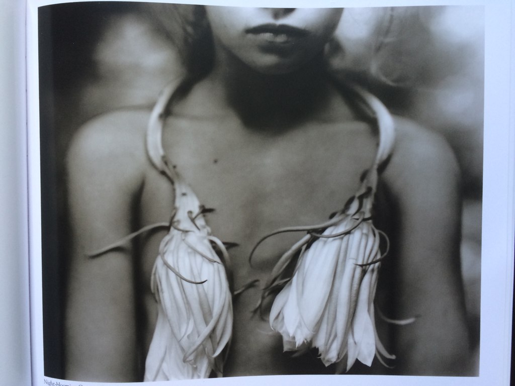

Just found the image in her book, it's indeed toned, not just the postcard paper.

I have seen th eoriginal back in the 90ties..
Quite sure of two things:
1: Film based (I actually the image was taken before she went into wet plate..)
2: definitively not toned. (except maybe for a slight archival selenium toning..)

gandolfi, could it have been a platinum print? Which she did do at that time.
no - it was a huge VERY VERY beautiful print on fiber based papers - one of the imidiate family (sp?)
(there were also platinum prints there - but different subjects and much smaller)
