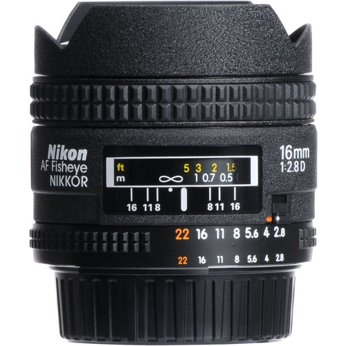

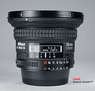

To further the discussion of high-end AF-D lenses (that are great for these cameras), the 18mm and 16mm AF-D have metal bodies.
I don't have either of these but they are on my list of things to get since I like wide angle lenses.
I think some people responding in this thread have these.
