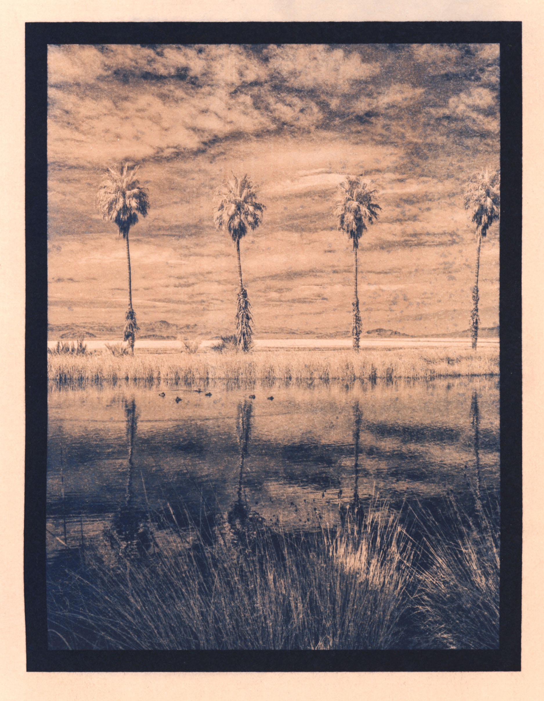

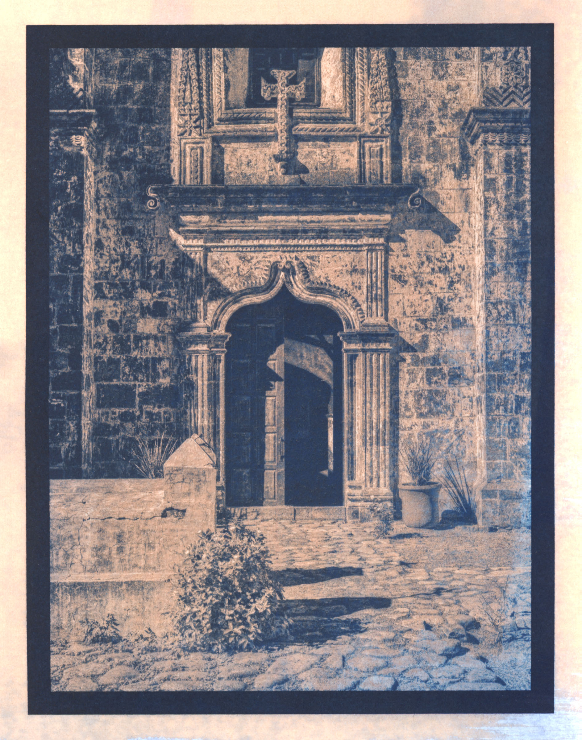

Following Andrew's video, I've made several ferroblend prints. I get the best results using ink jet paper, where the shadows remain blue and the midtones & highlights go copper. Results on all sorts of watercolor paper have been generally poor and very inconsistent. My biggest issue is fog. Areas that should be white (where no exposure took place) are copper colored, creating an effect that looks similar to making a cyanotype on colored paper.
Watercolour papers in general contain Calcium Carbonate, an alkaline material, as the buffer for archival purposes and this unfortunately interferes with all iron-based printing processes. In the specific case of FerroBlend, complexation of Cupric ions in the developer is critically dependent on pH. Presence of Calcium Carbonate in the paper affects complexation and results in general stain. For the developer to work as intended, the paper must be free of buffer. That's why it is best to neutralise the buffer in watercolour papers with either Sulphamic Acid or Citric Acid before using the paper for FerroBlend (or any other iron-based process).

I ran some of my watercolor paper through a citric acid bath. I'll give those a try this Thursday night at school. I can't really get any information about one of the inkjet papers I'm using (Kodak Professional glossy), but I verified with the manufacturer of the other two (Red River and Arista) that they do not contain any buffers.

Thanks for the warning on the copper sulfate. I just happened to have a pound of lab grade left over from when I taught science. I didn't know that there were any uncoated papers sold for use on inkjet printers. I go through a lot of Red River Aurora Natural which is probably the closest thing to watercolor paper I've ever run through my printer, but it does have a coating.

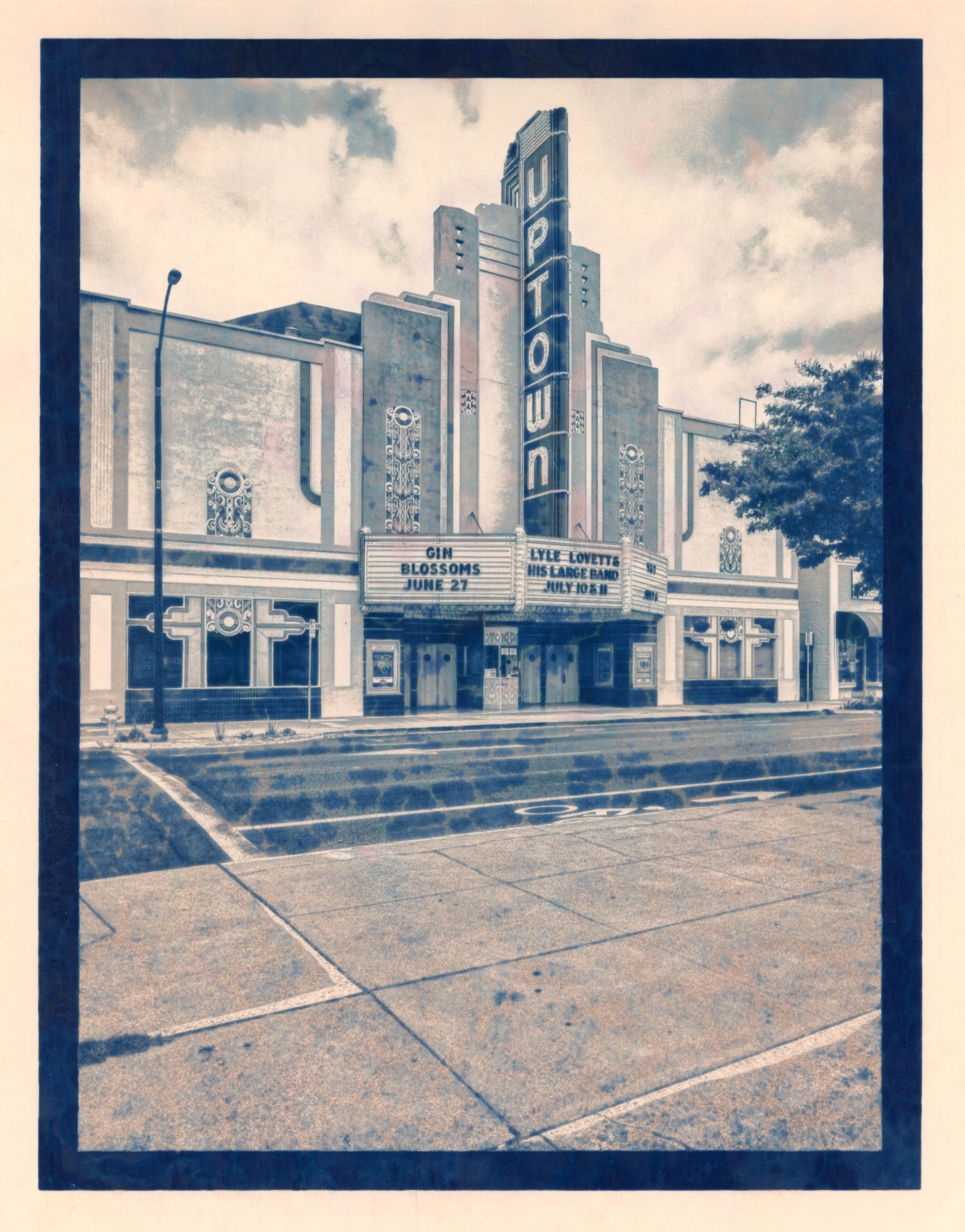

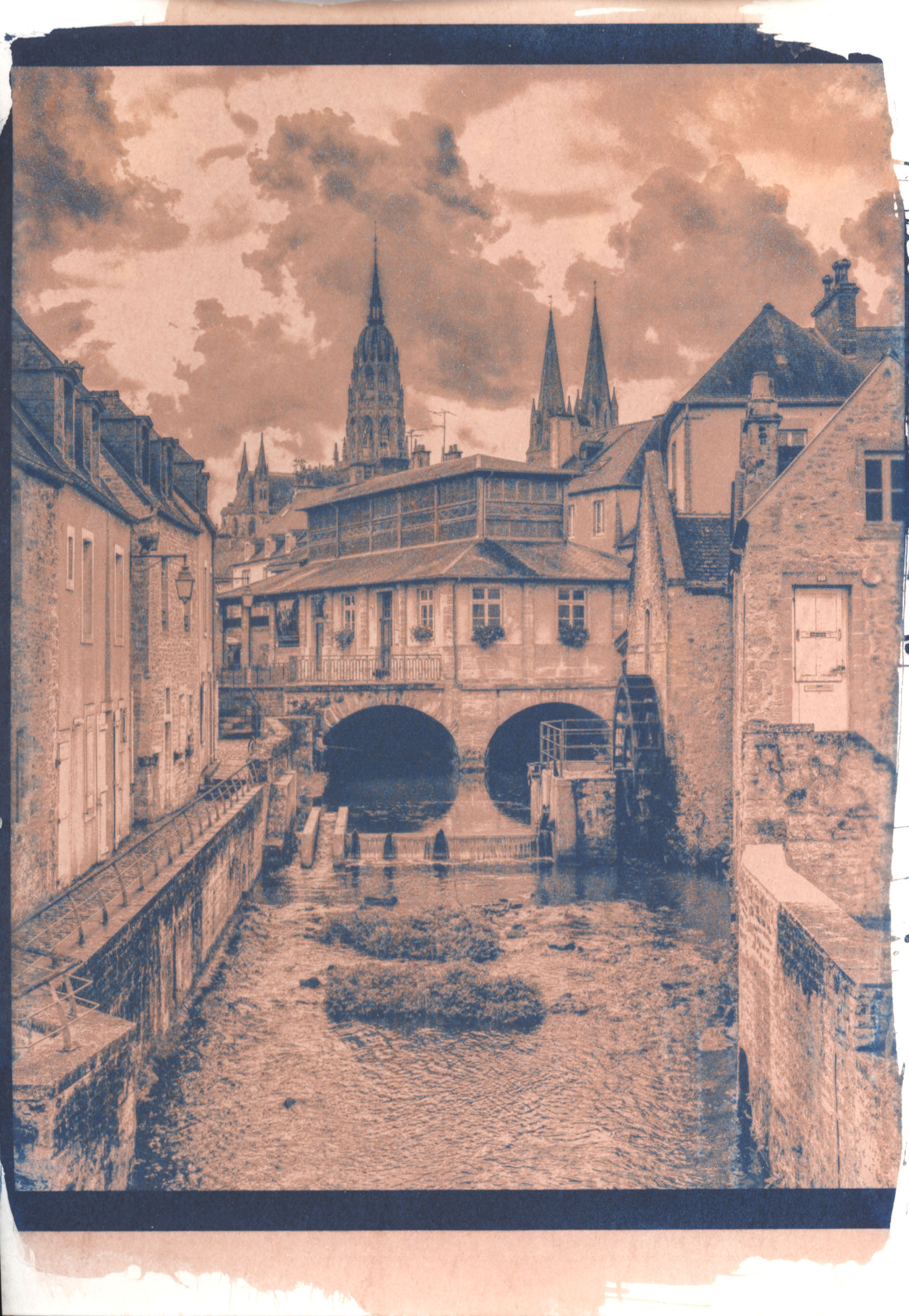

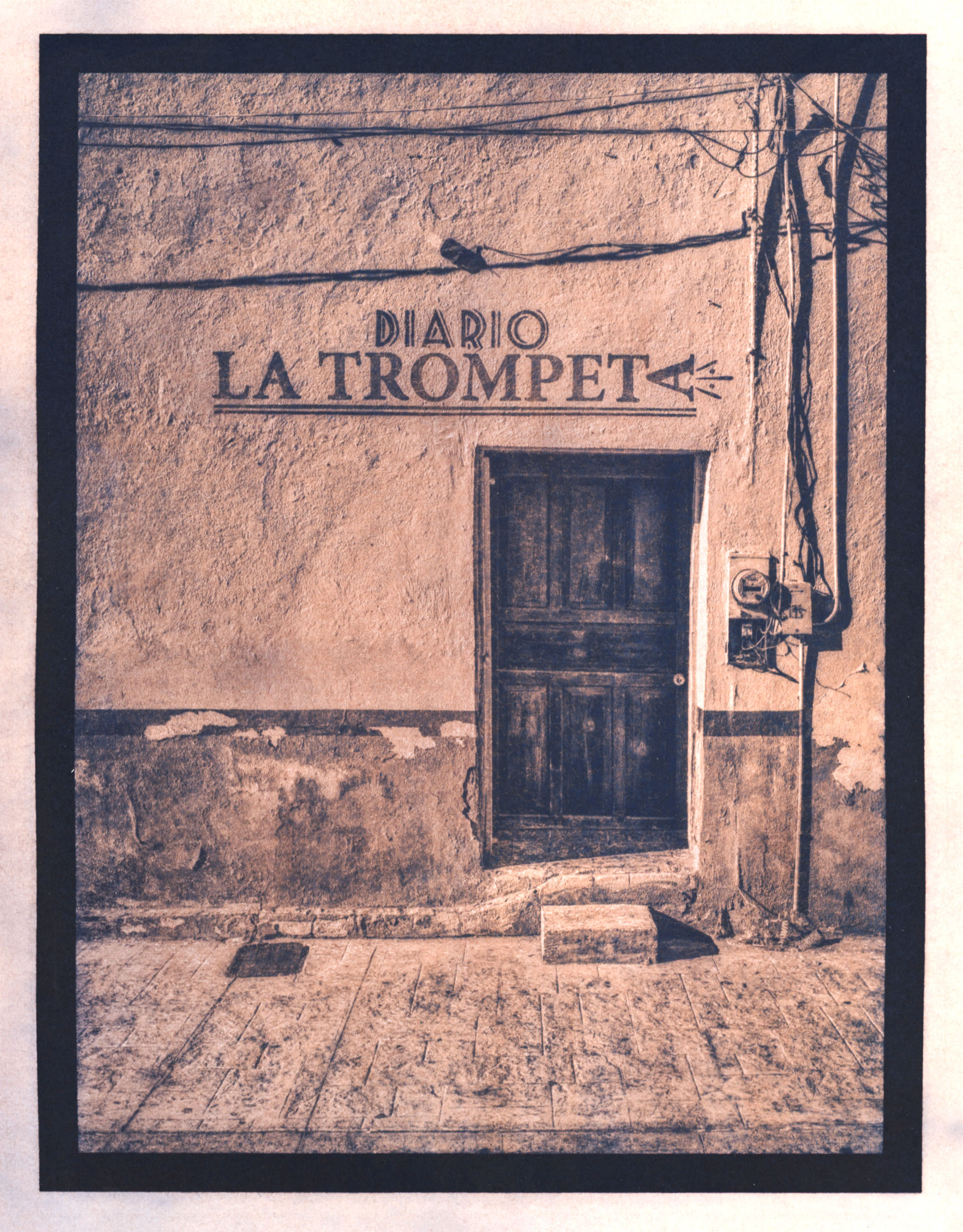

Here are a couple from my experimenting session 2 weeks ago. The theater is printed on Red River metallic gloss inkjet paper. The shot of Bayeux, France is on some noname brand of watercolor paper that I acidified in citric acid. 1.jpg2.jpg
Thanks for posting these.
I assume that the neutralisation of the buffer in the watercolour paper was carried out till the paper stopped fizzing and also that the acidified paper was rinsed in normal water to remove residual acid.
The theater print seems to have blue vertical streaks. Any idea when exactly in the process they appeared?
I would suggest consider switching to an economical paper that's known to work well. For example, Canson XL, the one that Andrew uses.

Yes, the watercolor paper sat in the citric acid for a few minutes after the bubbling stopped and was washed in running tap water for 10-15 minutes. Unlike the previous week when the coating was going blue prior to exposure, the acidified paper had a lemon yellow emulsion prior to exposure. That theater image is one that I use frequently to evaluate papers for cyanotype use. I have one negative that's curved for cyanotype and a second that's curved for kallitype (based on Andrew's vido comment that suggests a kallitype curve works well for ferroblend.) The blue streaks occur after I brush on the developer. I think it's a matter of technique, since I've produced some prints where my application of developer was clearly incomplete. I've also been hitting the prints with a citric acid clearing bath about a minute after brushing on the developer, so I might be rushing that part of the process. I do have a small supply of Canson XL that I used last Thursday. I'll pick them up from school sometime next week and post some samples here. Thanks, Raghu, and everyone else who is part of this thread. You're all both helpful and inspiring.

I used 5%. Total time of the paper in the acid was no more than 5 minutes.

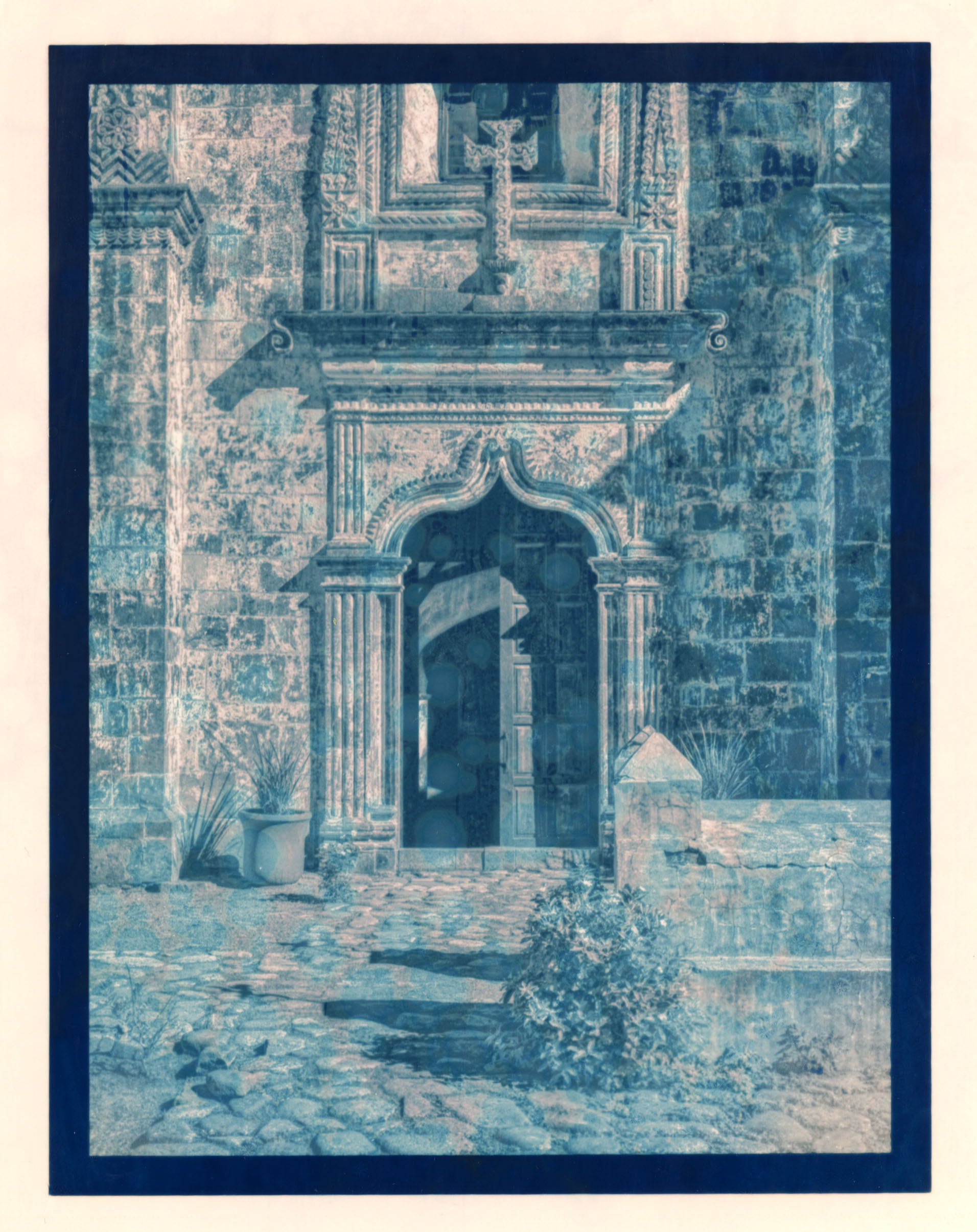

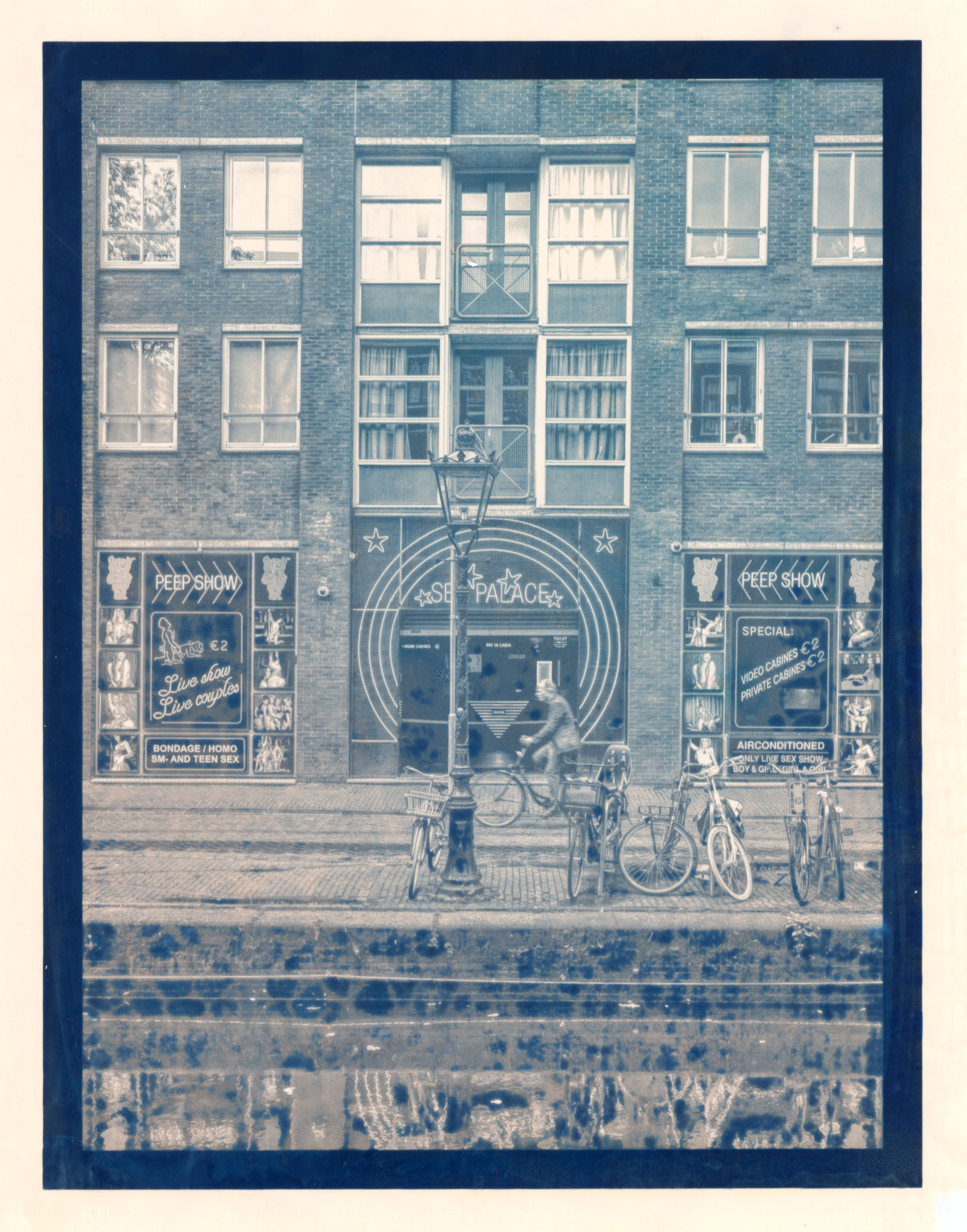

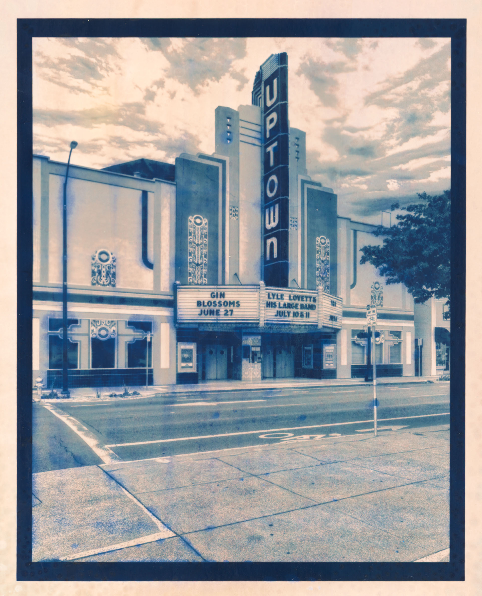

Two steps forward, one step back... I'm still experimenting with ferroblend. On Canson XL watercolor paper, precoating with ammonium chloride does not seem to have much of an effect. Precoating the Red River metallic inkjet paper causes some mottling. It is very hard to get an even coating of emulsion on this paper. It's a shame, because the paper produces a really nice dual-toned print. While is is not as obvious in these scans as it is in the original print, the development seems quite uneven. I have to assume that it's poor brushing technique. Has anyone tried developing in a tray and, if so, can you run multple prints through the developer?
Prints are as follows:
#1 - Canson XL precoated with ammonium chloride.
#2 - Red River Metallic precoated with ammonium chloride.
#3 - Canson XL no precoat.
#4 - Red River Metallic no precoat.
#5 - Red River Metallic no precoat.
#6 - Canson XL no precoat.
Tray processing works fine but requires considerably greater volume of developer than brush development. Use at least 50 ml of developer and rock the tray continously to to move the developer around. The developer can't be reused after one or two uses due to Copper Ferrocyanide building up in it. One shot development should be fine.
Your results are very nice and I must say the #4 (Red River Metallic no precoat_ looks quite artistic to me. Thanks for sharing.
