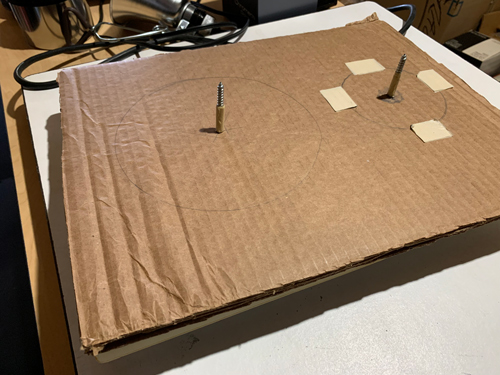

Easy-peasy. Put the big roll on the left and the 100ft core on the right. Roll it on until the circumference reaches the little bits of tape. I do it in my dark bag. Cost? phphphphtt.
That’s what I’ve done too. Overrun doesn’t happen because of the friction underneath. I found a piece of square section bar that fitted exactly into the 100ft core and made turning a lot easier. My fallback for this function was a short broad flat screwdriver.
Great idea, what's the spacing between the opposite tape edges (which I guess equals the diameter of a 100ft roll)? I'm thinking of starting bulk loading but the film I want only comes in 400ft rolls (or 1000ft but I'm not that ambitious).
Yes, I traced around an old 100ft can and put the tape just a little bit inside the circle so the reel would fit in the can for storage.
There are convenient calculators online that you can use to determine the dimensions based on core diameter, thickness of the film and length. Modern films are around 150um.
