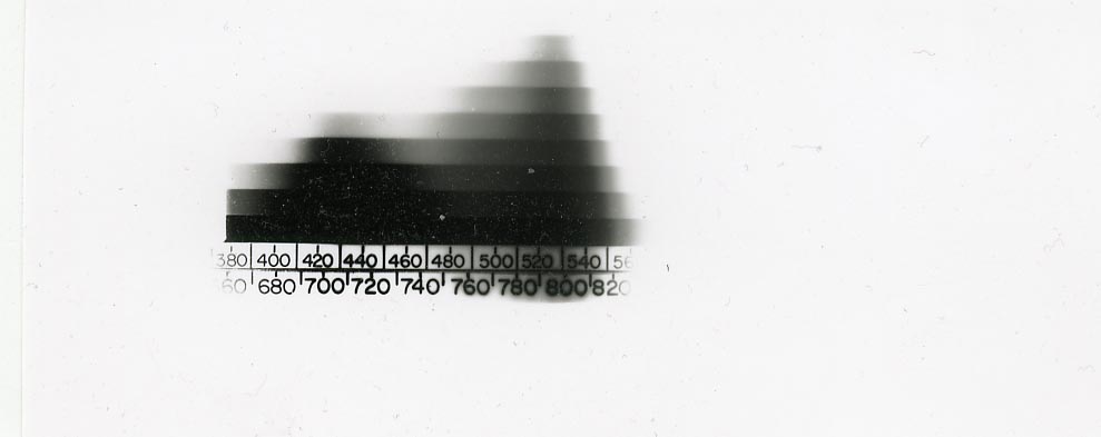

Here is a sensitivity test of Ilford MGIV (a wedge spectrogram in technical terms).
There is a lot of UV, I assure you, but I cannot capture that with my equipment.
Most enlargers have UV absorbers and heat absorbers to prevent problems, but who knows. I do know that there is a lot of UV absorption in Pyro negatives.
PE
