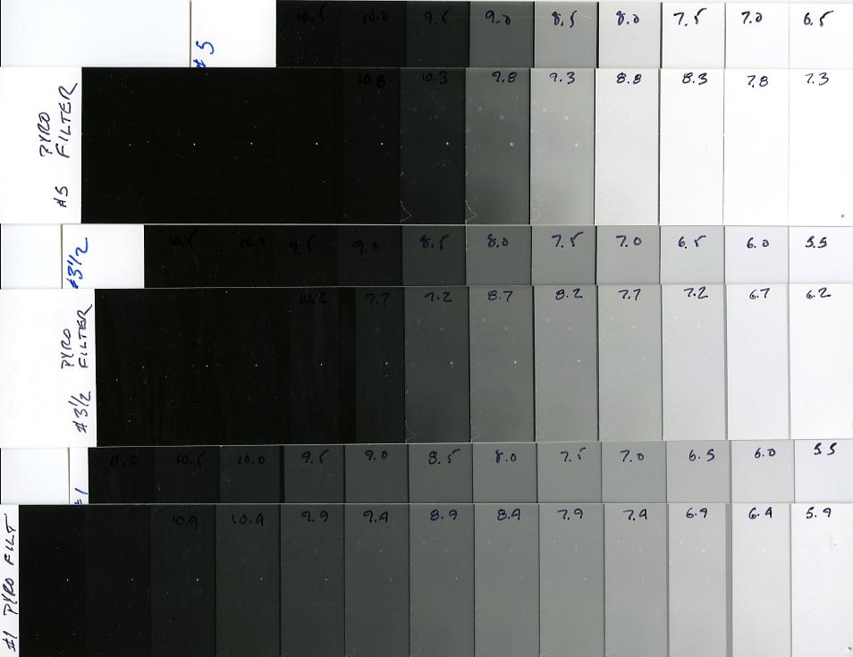

An experiment was performed to see if pyro stain had any effect on the intrinsic contrast of VC paper.
The experimental method
A 4x5 sheet of Plus-X was given a uniform Zone VIII highlight exposure and developed for 12 minutes in PMK developer.
The silver was removed with P. Ferricyanide and Thiosulfate bleach.
The resulting stained negative was put in a condenser enlarger and grey-strip prints were made with #1, # 3 1/2 and #5 contrast filters. Exposure times were the same for all strips and ranged from 1 to 64 seconds. The aperture was adjusted so the tones would line up with grey-strip prints made without a pyro-stain negative.
The experimental results
In each pair of strips, the top one was made without the pyro-stain negative, the bottom with. The exposure shown is as measured with the DA exposure system.
Obviously, with the pyro-stain negative/filter in place extra exposure needed to be given to compensate for the pyro stain. What is very interesting is that increasing amounts of extra exposure need to be given as the contrast grade of the VC filter increases.
Grade 1 was given 0.4 stops more exposre
Grade 3 1/2 was given 0.7 stops more
Grade 5 was given 0.8 stops more
Conclusions
Pyro stain does not have any appreciable effect on VC paper contrast. There are slight variations in the match-up between the tones but they are in line with the variability of this type of experiment: tray processing, aging developer, room temperature for temperature control, forgetting to set the timer for print development and guessing when it's time to pull the print ... but these are the normal variables encountered in any darkroom.
The effect of pyro stain is to add simple density, the amount of density added by a given amount of stain changes with contrast filtration.
A pyro negative will gain contrast faster than a conventional negative when the contrast filtration is increased. If a conventional and a pyro negative produce identical prints at VC filtration #2 then the pyro negative will produce a higher contrast print at VC filtration #5. The reason being that the stain is seen as a higher density with higher contrast filtration and stain is proportional to silver (mostly).
All developers produce negatives with different HD curves. Even if pyro and a normal negative are development adjusted for identical ‘CI’s [begging the question of defining CI for a pyro negative] the look of a print from the pyro negative may not be the same as the look of a print from the normal negative. Other effects, such as grain masking and image softening due to diffuse stain and image sharpening due to tanning, will also effect the look of a print made from a pyro negative.
But, whatever the effects of pyro stain, differentially lowering paper contrast in the highlights isn't one of them. If pyro stain had an effect on paper contrast the grey patch strips shown above would not match for contrast.
It is possible the results may be different with other films, developers and light sources. This experiment is very easy to make for oneself - it takes only the odd bits of an evening. If you doubt the results, please try the experiment for yourself and post your outcome.

Thanks for doing that! I use PMK and am glad to have that cleared up. It is harder for me to visually estimate contrast by eyeballing the PMK negative compared to xtol/d76, but at least the contrast will work the same.
John Bond
May 23, 2006
47
So, pyro stain does not differentially effect highlights. Are you also saying that it does not effect overall contrast as well?

Unless I misunderstand, I would have to disagree in the top two examples. The density difference on the right is about 1.0 (I cannot clearly read the numbers but visually it looks like you have lost one step)
Based on the color of pyro stain, it should affect the image contrast differently across the filter gamut. That is what I see for #1 and 2, but not for the remainder. This is reasonable for having an effect at one filter value but not at all.

John, his test does not test negative highlight handling or negative highlight range handling. Uniform negative exposure was used to eliminate that variable, so that only paper contrast was being tested. Zone VIII will be fairly light, meaning a dark thoroughly stained negative that should show off any VC print differences better than a dark zone that would be thin on the negative.
Exactly. It isn't a comprehensive statement about highlights and pyro. It just seems to show that whatever effect pyro has, it isn't the color of the stain affecting the HD curve of the paper to any significant manner.
I was rather taken aback at the lack of affect.
I'll scan the strips with a densitometer and add the density numbers to the picture above - won't happen until tomorrow evening. The earlier set (not shown here) - before tweaking the exposure so the tones align - showed HD curves that were darn near identical.

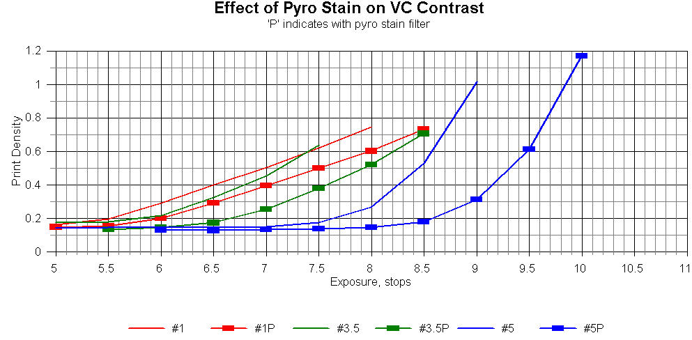

In the meantime here are the HD curves of the earlier set - I was looking at the highlight sections of the curves as that was where differences were expected. You can see the constant horizontal offset between the curves with and without the filtration. As an example: if you look at the two red curves and go horizontally between them there are always 5 divisions (0.5 stops) separating the two curves.
Sorry, I don't understand this.
The scan shows 3 pairs gray-strips.
The top pair of strips are at grade #5, the middle at #3 1/2 and the bottom at #1.
Within each pair the top strip shows the tones without a pyro stain in place and the bottom with a pyro stain.
The numbers on each patch indicate the amount of exposure given before filtration, they have nothing to do with density.
Comparison is presented as purely visual: is the difference visually significant?
There are, of course, minor variations in tone. Expose a sheet of paper with uniform light (a problem in its own right), develop it and measure density across its surface and there will be minor variations. If there were no minor variations I would suspect the experiment of being fudged.

The top two examples (1 and 3-1/2 filters) do show significantly less contrast for the pyro stained negative, but nothing that can't be handled easily. Visually, the gradation seems somewhat more even with the pyro stain.

Nicholas;
After seeing the curves and rethinking the issue, I have to agree with you and disagree with myself. :wink:
