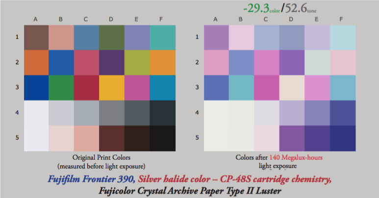

If anyone is interested you can check out http://www.aardenburg-imaging.com for extensive testing done on a wide variety of B&W and color materials, pigments and papers.
This is their extended fade test for Fuji Crystal Archive, and it provides a great representation as to the condition of the prints in the collection as well as the ones I had displayed at the vet's office. Aardenburg places their Upper Exposure Limit for this material at only 28 megalux hours before noticeable fading.
Sirius Glass
Jan 18, 2007
50,411
Southern California
Well there you have it. Do not display color prints under Megalux-hour lamps. Although A4 and A5 seem to be unaffected by the strong light.

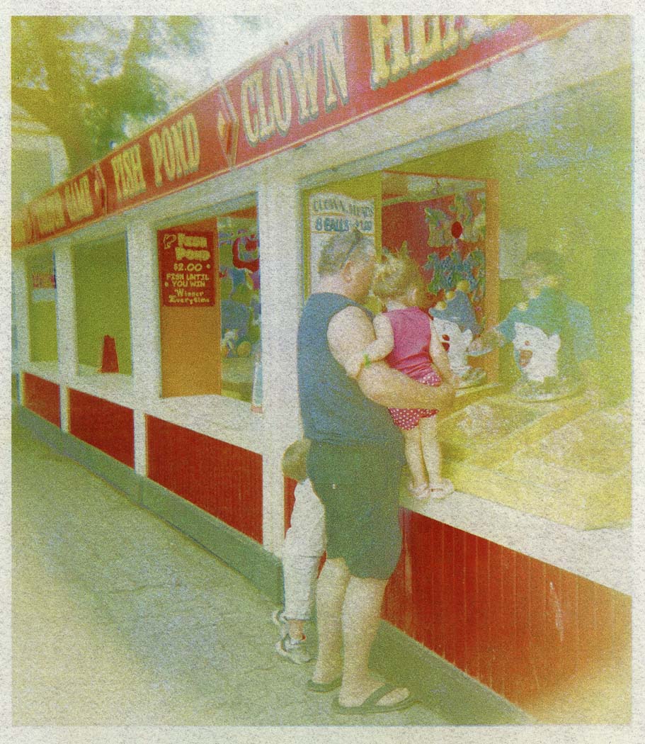

Child and Father -Image courtesy Laura Paterson
Dragon- Image courtesy Monica Glitz
I add these two images to this discussion , as a possible discussion starting point on how colour photography can be permanent.
These are Tri Colour Gum Prints , one of the dragon is tri colour gum over palladium.
