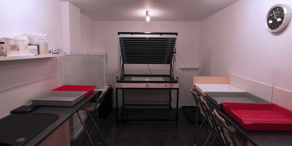

HI Don
The picture below gives a better idea of the setup. The exposure system is a bank of 10 4ft blb tubes. The vaccum unit is a standalone bed which has a custom frame built around it. A 40x30 unit standalone unit is a rare beast to find in this country as they stopped making them this size some time ago, i was lucky to find it. Edwards Engineering will make you one with an exposure system installed for around $6500. I prefer a standalone unit to an all in expsosure system as one is able to dictate the height of BLB tubes, whereas the later is usually a fixed light source that i have had problems with in the past.

HI Don
I was a bit surprised to see the BLB bulbs vs BL. Are those 40 watt tubes?
I've been thinking of building a new exposure unit using Phillips 40W T12s-350nm BL 4 ft. tubes and was curious. Looks like a nice setup.
That is a large vacuum easel. I've not found one that large, though smaller Nuarcs are fairly common.

I have switched BL and BLB in my 14 tube X 48" light bank and there was virtually no difference in exposure time with either carbon or the iron processes. Most of the literature suggests that BL tubes print much faster but that has not been my experience.
Got lucky with my large 38" X 58" vacuum frame. Bought it for $90 on ebay, shipping included, and it was shipped by air from California. Someone lost their a*& on that one because it is big and heavy and most have cost a lot to ship by air.
Unlike the set up pictured here I keep the light unit horizontal and the vacuum is on rollers which is pushed in and out of the light path.
