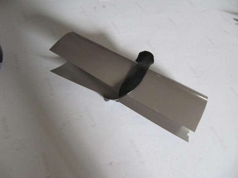

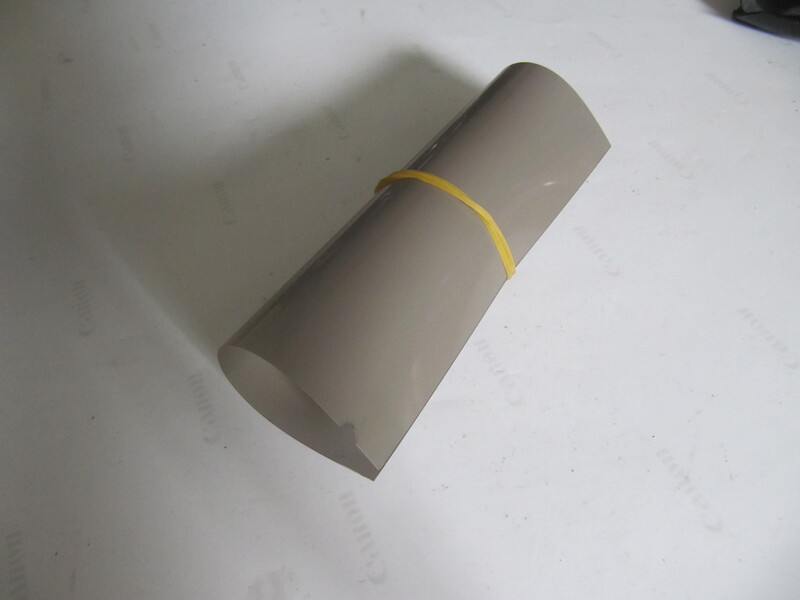

So, I am now doing the 4 sheets bent with a rubber band inside the 1l Paterson. I see americans call this "taco method", which is weird because for me a taco is a small tortilla, ie. it is flat, similar to a crêpe/ thin pancake/ blini/ etc.
I have a box of thin rubber bands, need to double one so hold the 4x5 sheet:
but it is a bit too tight and with good agitation and washes, it comes progressively off in the end.

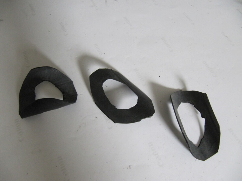

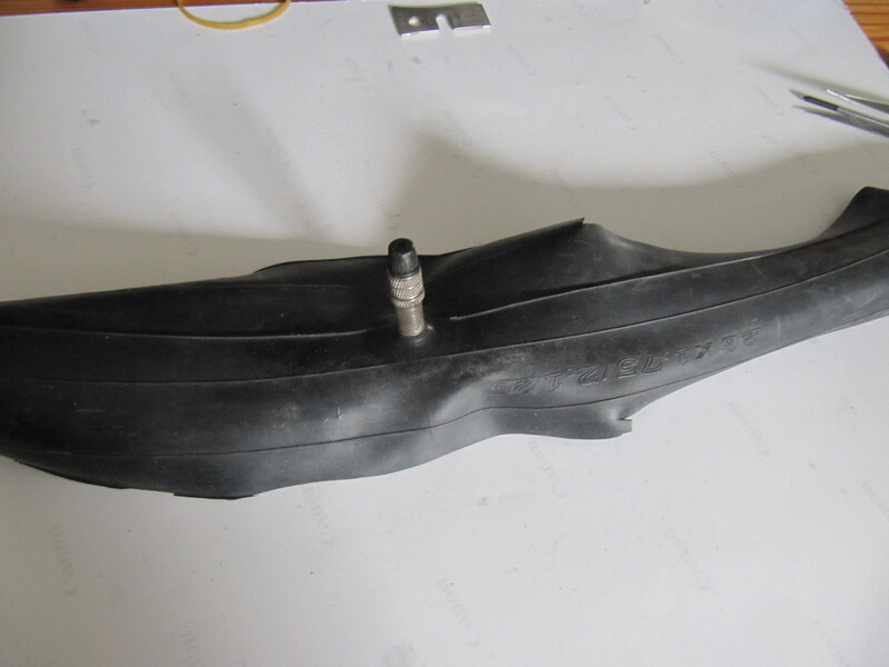

Take some bicycle tube, cut and open lengthwise:
cut rounds/ovals with a matching hole:
et voilà !
with a bit of test I get the perfect size and fit. It stays there and doesn't roll, whatever shakes I do when washing.

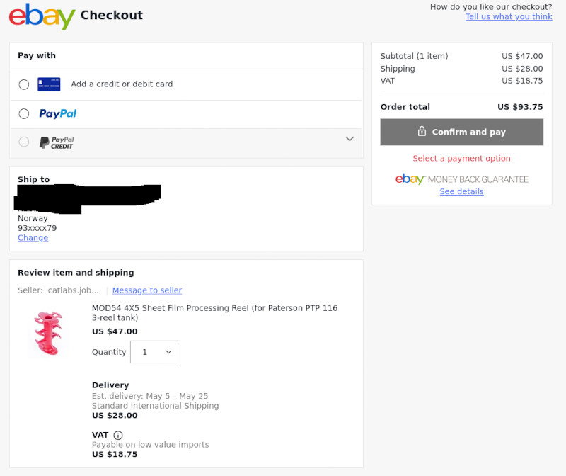

Ebay is good for us here because it does bill at checkout norwegian VAT and reverts it to norwegian treasury through the norwegian dedicated portal called VOEC (Vat on E-Commerce). Ebay and Amazon are huge, they do it no problem. Otherwise add 23 to 35 USD processing fee, when buying from small shops who don't want to deal with norwegian bureaucracy.

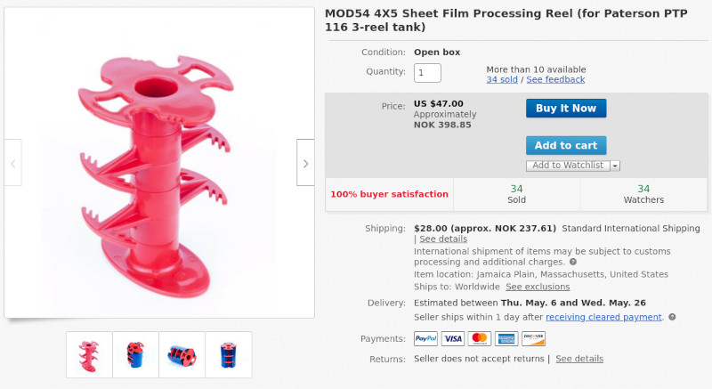

Just for the fun: I search on ebay the cheapest, shipment included, MOD54, and it is sold now by a shop in ... USA.
This one, see 47USD and 28USD shipment to Norway
If I go to checkout, Ebay computes the VAT, ie. +25%, and it becomes 93USD:
a shop in Norway does sell the MOD54, 795NOK , so ~ 93 USD...
but the shop is ~5 hrs drive from my place, can˝t collect, have to get it shipped over with postal service. It becomes 945 NOK ~ 111USD
if I buy from USA on Ebay, shipment and tax included ~ 93 USD
if I buy from here Norway, shipment included: ~ 111 USD
see?
so either things are not available, and if some are, it's cheaper to buy from abroad anyway...

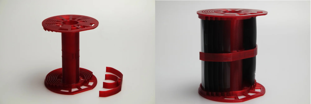

Honestly, it seems to me you might be ahead to buy a 3D printer. They start at around $200+ USD; shipping won't be trivial, but you only have to pay that and VAT once for the printer and then when you buy filament or resin. A lot of this stuff is 3D printed already (some of the sheet carriers that go in Paterson tanks, for instance). And once you have one, you can print stuff to sell to others in Norway, undercut the foreign suppliers, and pay for your habit, er hobby...
I'll let you negotiate with my wife for the extra space near the computer :smile:.
Many/most of them don't have to be close to the computer -- they get their .stl files from a thumb drive or SD card. The rest are network devices, so either Ethernet wire or wifi...
They still require space, but point taken.
Carving out the space for the darkroom and film and camera stuff has left me with a negotiating disadvantage!
