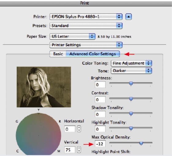

Regarding the need to use color ink to achieve sufficient "Spectral Density " to secure paper white I have to say that that was the case when inkjet printers used dye inks that didn't provide sufficient density. Modern inkjet printers use ( or have the option to use ) Pigment inks and nowadays we have the opposite requirement , that is , the printer produces too much density and , therefore negatives created with them when printed on alternative emulsions, ,achieve paper white TOO SOON , reducing the amount of Print midtones between Paper white and Max Black in the chemical print. Today it is generally required to reduce MaxInk deposition ( K value in QTR or Max Optical Density on Epson driver ) for that reason. See attached image showing how to do that when using color ink on an epson printer driver. Either use Black ink only or reduce the Max Optical density as shown, to expand the tonal scale.
