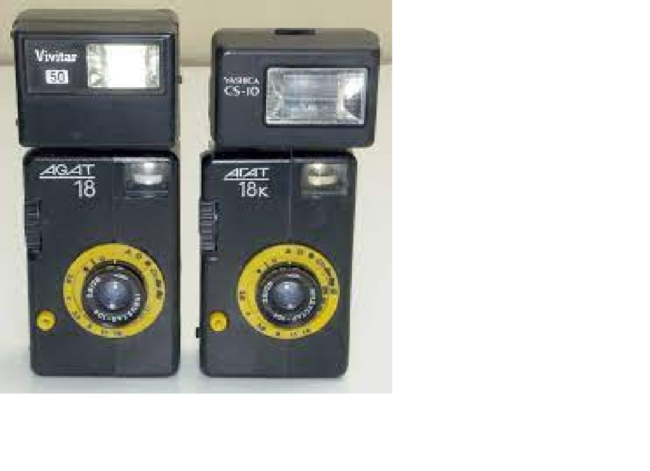

I'll report back to see if my Agat 18K has some sort of baffle -- as soon as I can find it. Here's what it looks like -- next to its sibling:

OK, I've found my Agat 18K and opened it up. The interior of the "lens box" looks exactly the same as on my Agat 18. I see no "baffle" or "baffling". Both sides are flat, black, shiny plastic -- exactly like in my Agat 18.
The only difference -- besides minor exterior appearance, ISO setting, exposure icons, etc. -- is the removable film take-up splindle. Once removed, an EMPTY, 35mm cassette -- to which the 35mm film leader/tab is taped -- can be inserted to pull the film into the EMPTY 35mm cassette after each exposure, to act in a Rapid-type film system.

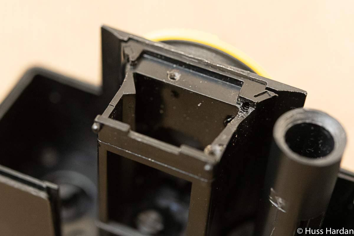

Even though I have the fine dexterity of a petulant six year old with a hammer, I decided to take my Agat further apart to investigate this baffling case of the baffle which has become more baffling through these discussions.
Two screws needed to be removed, et voila the pressure plate mechanism comes off. To reveal.... that freakin baffle is a molded part of the 'lens box'! I thought maybe it was a piece I could just pop out! Son of a firearm!
The original images made the baffle appear to be a vertical strip oriented parallel to the film frame, but this view does imply some sort of optical attenuation was intended by the design and placement.
I was under the impression the Agat(s) had a 'regular' leaf shutter, but some reading tells me it's actually an EV-coupled? There are some SLR cameras (few and far between) like the Fujica ST-F that use a similarly oriented but adjustable baffle in combination with shortened mirror travel rather than a traditional aperture to control exposure.
It may be that this was applied as an 'average' correction to make up for some non-linearity in the performance of the shutter across the various EV combinations. Or for flare mitigation... or both.

Good guess, I suppose, but my Agat 18K does not have that "baffle".

Here's an interesting point that I just noticed while comparing the Agat 18 and 18K. The 18K dropped the DOF scale that the 18 has. Seems odd because they didn't save any money by removing it, but they had to do it intentionally. I guess they figured that no one was using it. I can't say that I ever used it -- but interesting to note.
