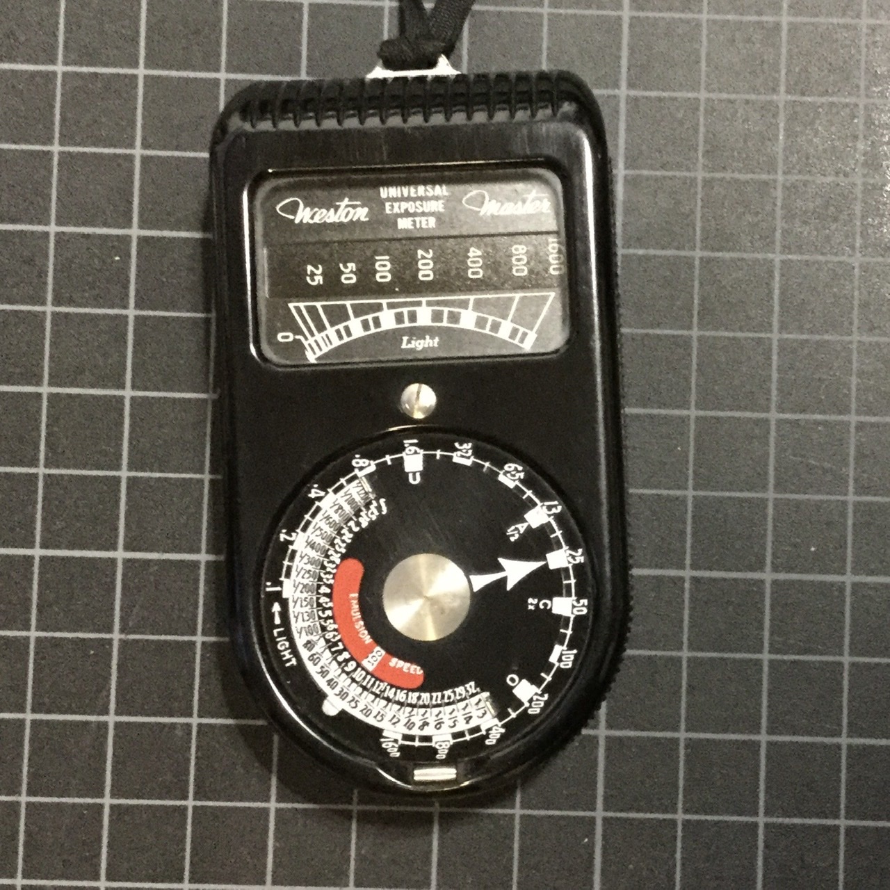

I have this weird old exposure meter collection. Most of them are not accurate but they look cool. I just acquired a old Weston Master II and checked the accuracy. It keeps up with my modern digital meter with reflected readings. I thought the Weston meter wouldn't be any good in low light, but it still accurate. I always thought the selenium cell meters had it's quirks, but I'm now thinking differently. These old light meters in their day costed a lot of money and now, they're sold on eBay for under $20. I find that kind of sad.
