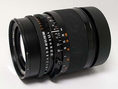

I have a Hasselblad 501CM. Love it, but so far only have the 80mm CB Plannar lens.
Due to some work successes, I am due to get £300 soon and wanted to use it to buy either a longer lens or a Macro lens for it.
Have looked at FFordes.co.uk and note they have quite a few 150mm f4 CF lenses (CFi lenses are out of my reach!) for about £300.
http://www.ffordes.co.uk/product/12101216325681
My main usage for my Blad is to photograph my kids (who are toddler aged) and landscapes when I get chance to get out and about. So on the one hand, I need a wider lens than the 80mm I have, but I think I'd use a 150mm more, but it's relatively slow f4 worries me a little as I tend to use slow films like Acros 100. Are the 150mm f4's recommended lenses, and if anyone can suggest a slightly better one for a little more money, I'd be pleased to hear of recommendations. How much were these lenses when bought from new before Hasselblad moved to H system?

I have it, and it's a great lens. From what I've heard, it's not something you'd want to shoot lens resolution charts with, but i've never had an issue with that, in fact it's sharp enough it seems to almost out resolve my 4x5 lenses... You definitely want to get an 8mm or 16mm extension to use with it, it brings the focus in and gives you a nice range to work with for portraits.

The 150 CF has become my most used lens, especially for pics of the kids. I shoot slow film too (160 mostly) and never seem to have a problem unless shooting indoors... and then I have no problem with connecting a strobe to it.

It is a great portrait lens, and nothing prevents you from using it for landscapes as well.
Slixtiesix
Jul 31, 2006
1,407
This is a good lens. Have one in SL66 mount. The 180mm is said to be better (well it is better if you look at the MTF charts), but that does not mean that the 150mm is bad. I search Ebay quite often for Hasselblad gear and you can get a 180mm CF for 500 Pound if you have some luck. The 180mm is said to be much longer physically and heavier. For handheld work consensus seems that 150mm is better suited. Then there is also a 160mm CB Tessar. Some people say it is bad but I have seen wonderful pictures made with it. It is also rather light. I have seen this for about 300 Pound used (but beware: dealers often list it at unreasonable prices). The 150mm is better in picture quality though. If it is in good working order I think you can´t get wrong at that price.
sandermarijn
Oct 19, 2005
704
Leiden, Neth
Another 'go' for the 150mm. While not as sharp as say the 80mm standard, it does produce a nicely smooth look, the typical Sonnar signature. You can really make your subject drown in the surrounding blur. (Whow, I managed to avoid the word 'bokeh'.)
You may also consider a black 150mm C T*. Those are optically identical to the CF but go for less.
I agree with Slixtiesix above that the 160mm Tessar is very nice in handling but not as cool optically, not the same softish drowning effect.
Good luck with your choice.
