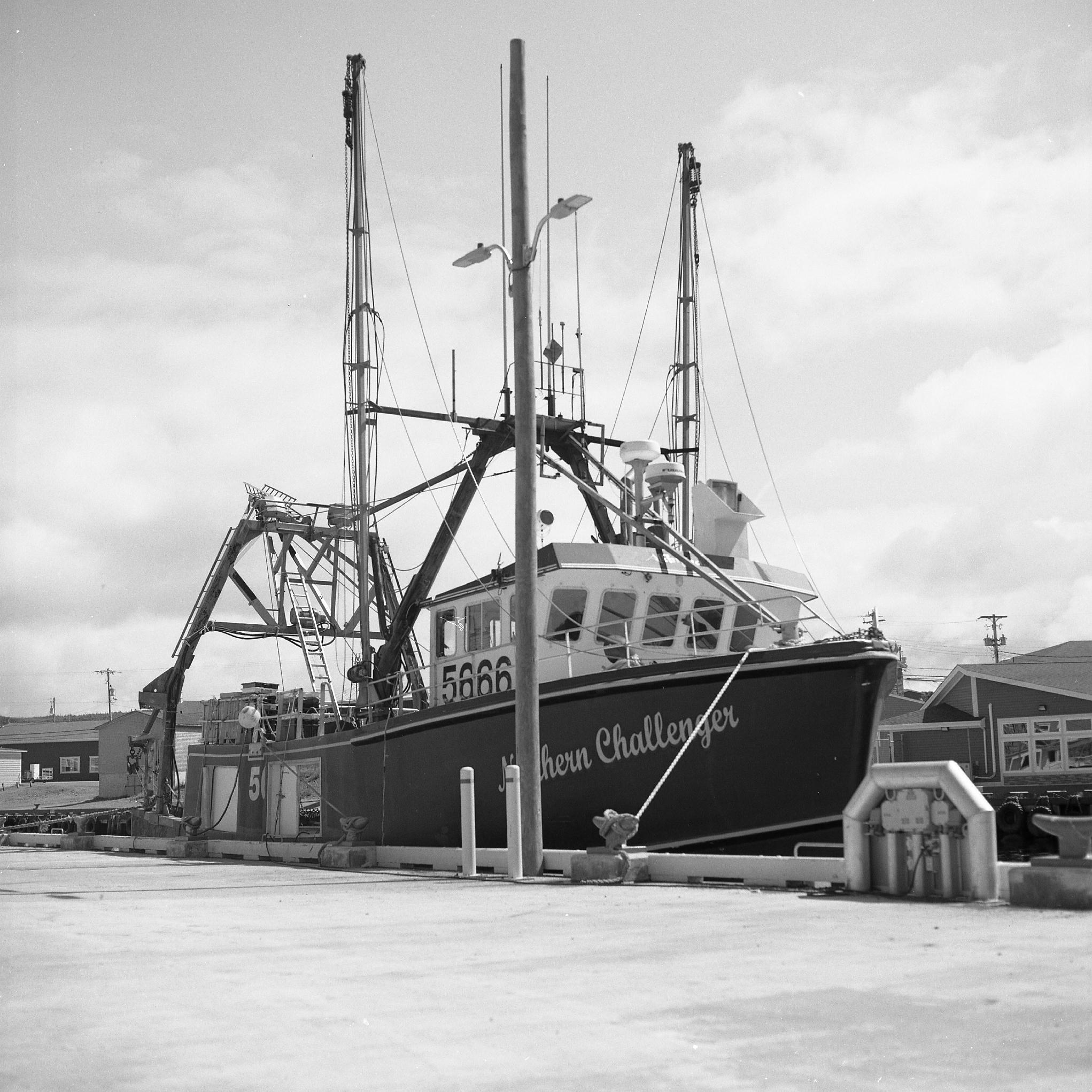

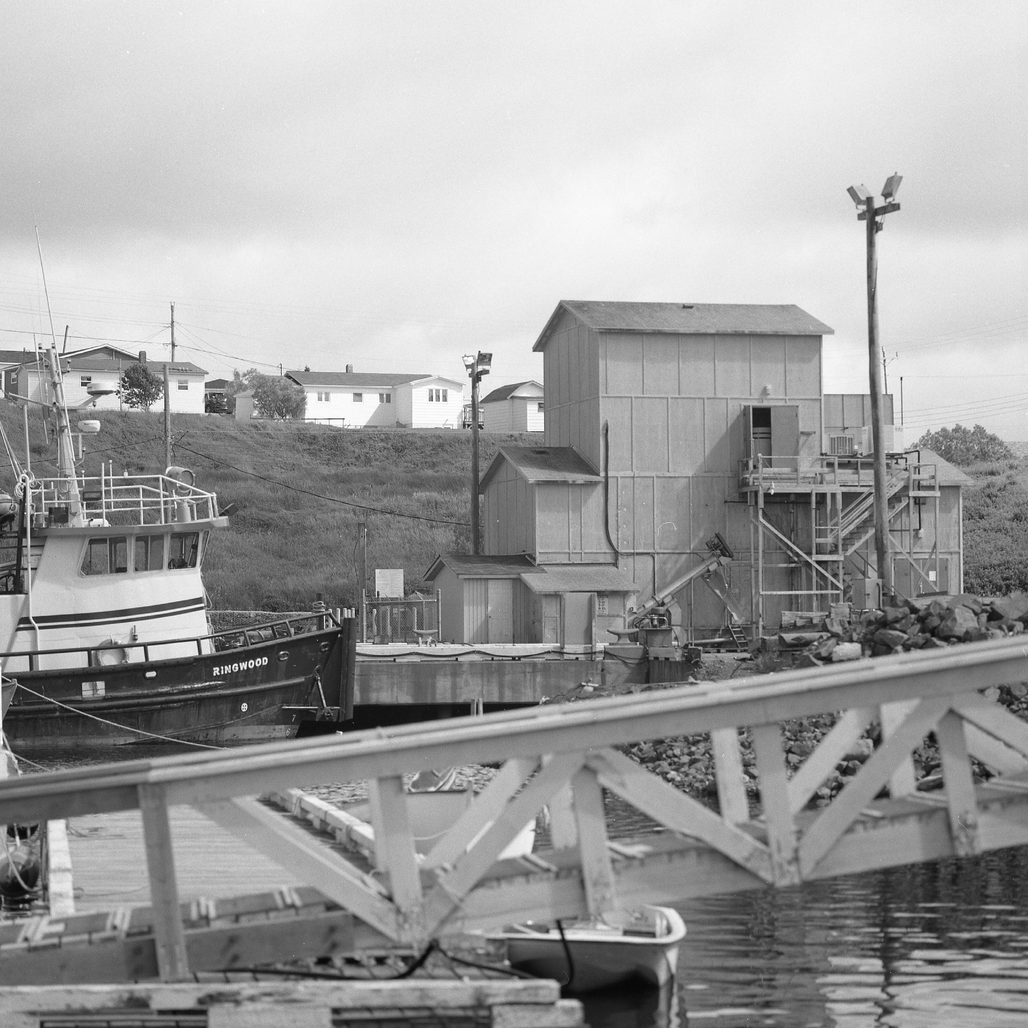

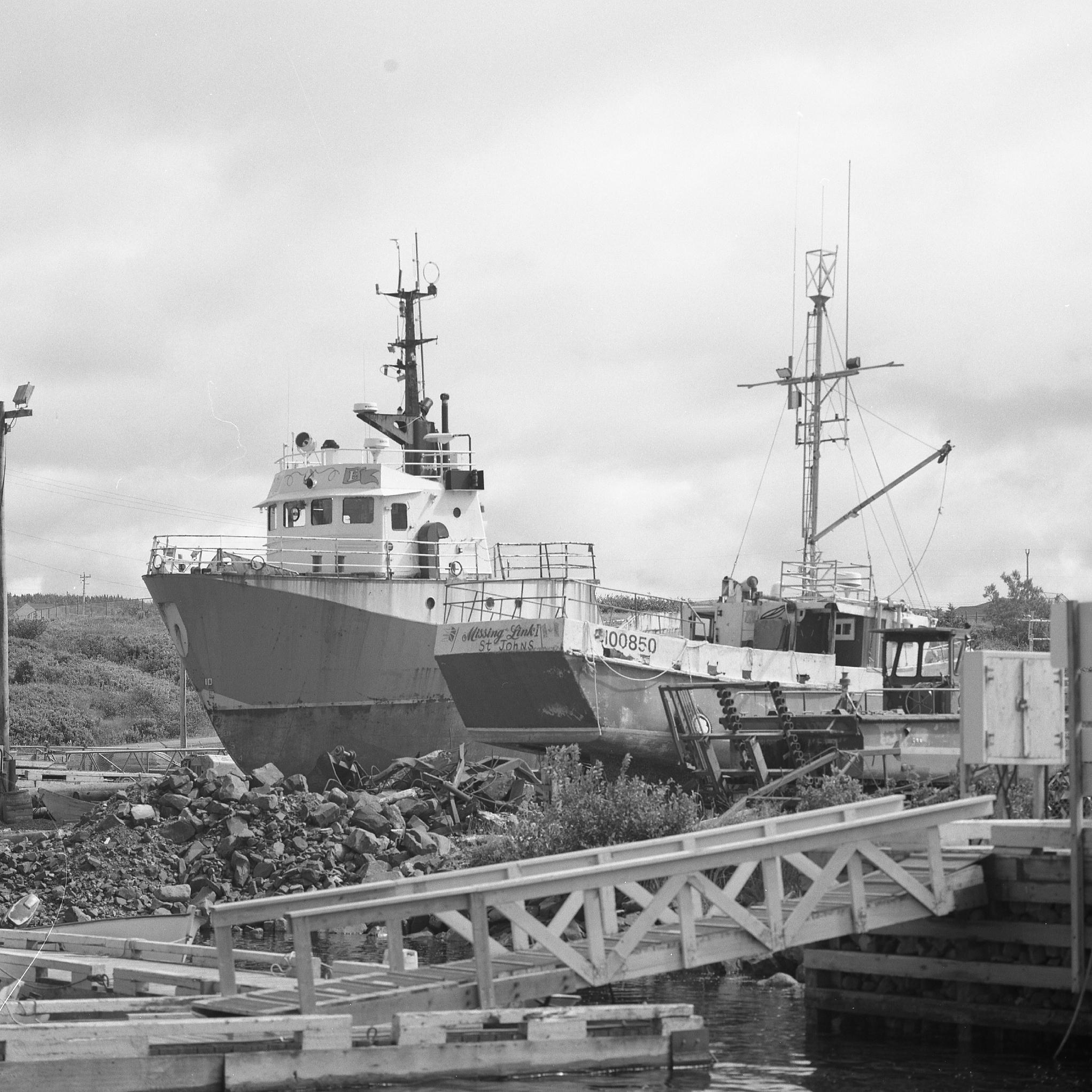

read this article last year and wanted to give this a try . . .
http://www.alexluyckx.com/blog/index.php/2015/05/08/the-panatomic-x-trick/
TMax 100 @ 32ASA, Xtol 1+1 8 minutes at 24C
. . . and these are my results, I am very pleased with the look:

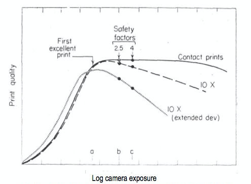

Even though Tmax has great latitude, enlargements of smaller negatives (for example 10x) could have poorer image quality with over-exposure. I don't do contact prints; In my darkroom 1.4x enlargements of 8x10 tolerate over exposure well, whereas Minox and 16mm still suffer quite a bit. So my experience matches that of Nelson.

Actually the graph from Nelson posted above incorporates more than just resolution in the the quality of a print.
The prints were judged by ten observers who expressed their estimation of the quality of each print by means of the terms: Excellent, Good, Fair, Poor, and Very Poor. The observers were provided with a chart on which to record their judgments. On the chart, the quality terms were shown equally spaced along a scale on which each observer placed a mark for each print. Thus he could rate the print at one of the five quality levels or at any intermediate level. These judgments took into account not only the tone-reproduction characteristics of the print but also the other factors that affect quality, such as graininess, sharpness, depth of field, and camera motion. The judgments of the observers were averaged to obtain the final ratings. The details of this method of judging have been described by Sorem. -- P S & E, Vol. 4, 1960 SAFETY FACTORS IN CAMERA EXPOSURES

"Crickets" (faberryman, ic-racer) on my request to tell me WHY these images were overexposed and overdeveloped . . . . jus' sayin' :smile:
I don't know about your development. Proper development traditionally matches the negative density range to the printing conditions (paper and enlarger). So, if you found them easy to print, they were probably developed correctly.
In terms of exposure, you indicated the images were overexposed one and 2/3rd stop. That is how the phrase "TMax 100 @ 32ASA" would be interpreted.
I have inadvertently over exposed more than that and obtained acceptable results. The original post seems to indicate the over-exposure was intentional, thus the resulting diatribe.
The results of Nelson, posted above, were from a panel of observers. You are you own observer, and you could easily see if the results would have been any better exposed at iso 50 or 100. T-max 100 may be the best B&W film ever made and may fare better than some of the films tested by Nelson.

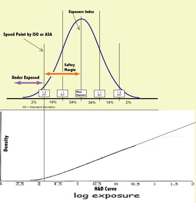

As for the “don’t overexpose or you’ll ruin quality”. That’s a great graph to absorb. One stop is a small dip past peak. So you haven’t ruined anything. But you could improve it with one stop less overexposure (based on these theories)

BTW, I add a safety factor back to my film but that is to account for variability in shutters, lenses, apertures and meters to avoid dreaded under exposure in the field.
I don’t worry about much. But underexposure scares me to death
