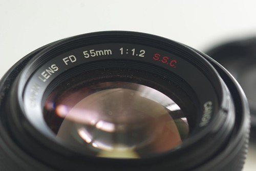

Reversal has no big method of correction as color development goes to completion. All correction must be done in the FD for the most part.
That's why i use canon manual focus lenses.
