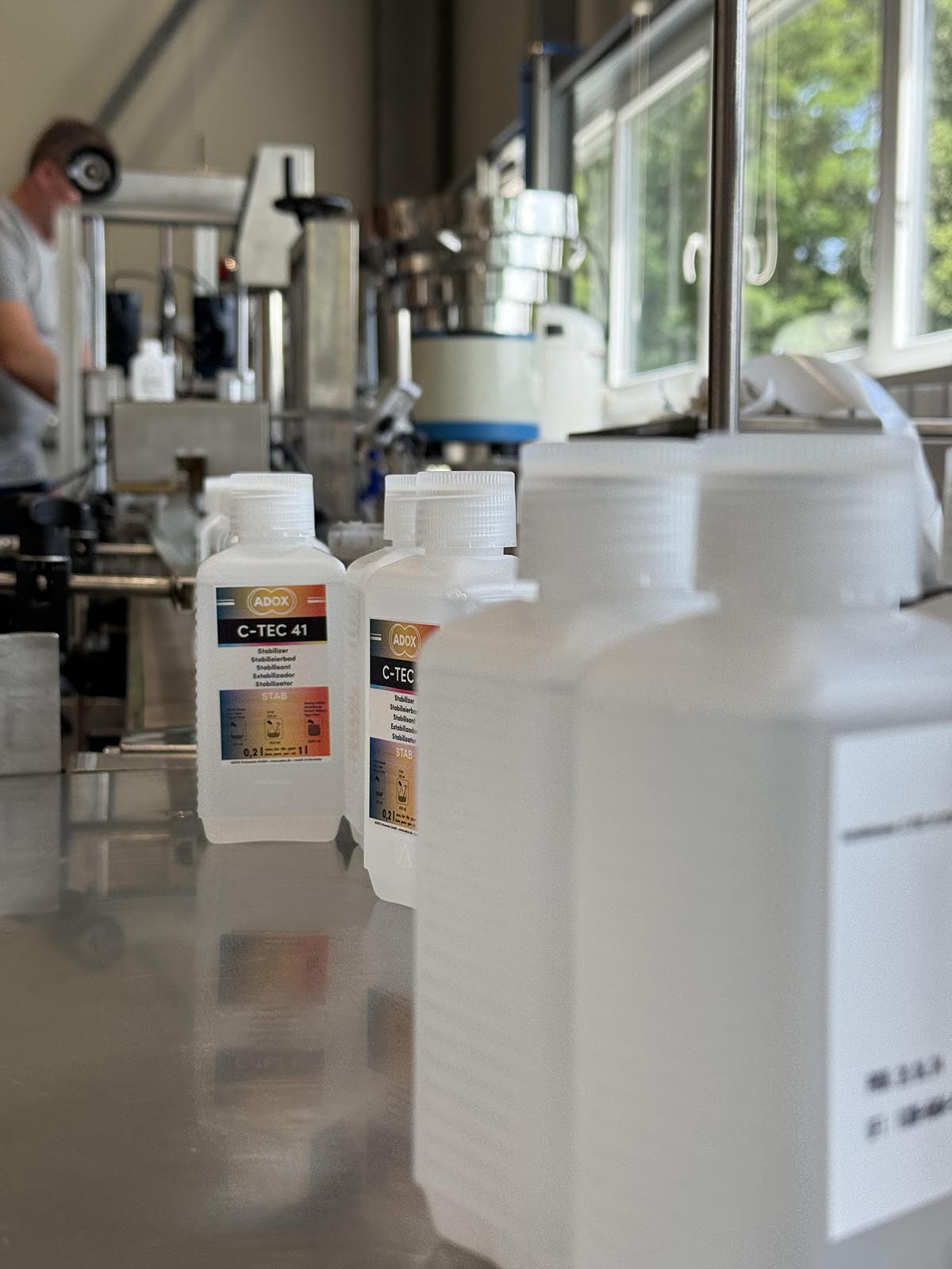

The 24th of May (2024) has been and gone.
The chemistry is mixed, bottled and ready to be packaed but we face a delay in the supply of the outer cartons.
How frustrating! I guess you need patience to be a manufacturer. Amazon is apparently using the World's cardboard for its packaging.
Cardboard has become a bit of a bottleneck material due to the sustained growth of online shopping and overall growth in logistics volumes.
Looking good! Many people are going to be very, very happy with this. How to get consumer-volume C41 chemistry is one of the most often-asked questions in relation to color processing at the moment.
