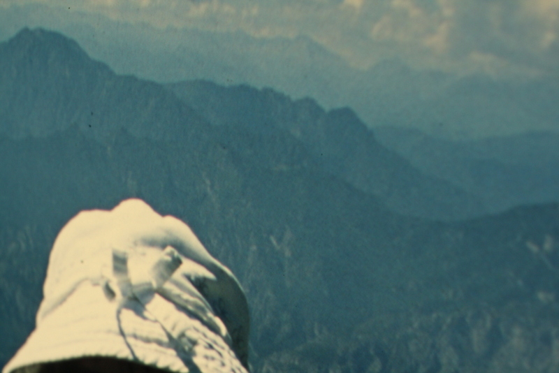

Just developed my 5th film, and it came out with a yellow cast (It doesn't seem ruined, more like using a warming filter).
The working solution is about 2 weeks old. The film was exposed about a year ago, I have no clue about expiration. The previously developed films were shot about at the same time and don't have the cast.
To my knowledge I did processing the same way as with previous films. Maybe I was a bit more "relaxed" with washing water temperature, but not the bath.
According to some sources the error is either due to pH or temperature of CD. I mixed the chems with distilled water, and previous films were ok, so I doubt that, unless it's been contaminated through the processing. Then again, temperature deviation also shouldn't be much different as with previous films.
Thoughts?
Edit: hmm... it seems as if the yellow stain is disappearing as the film is drying. Also, by coincidence I touched the clear base of the previous film with wet hands and the touched part turned yellow... is that normal??

Comparing basically the same scene of my 5th film to another roll developed through the same chems, there is a noticable difference. In both cases the film is Agfa precisa. The kicker however is, that I actually like the slides with this yellow cast more - it's as if everything was shot at the golden hour :smile:
Without knowing the caus I'm not sure I dare to run another film through this set of chems though. More cast would not look good anymore. I'll get some pH test strips to check the color developer and then decide if I want to gamble or not.

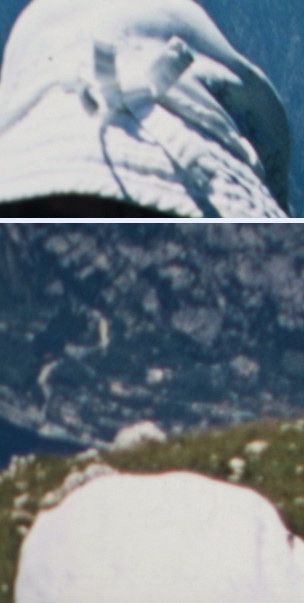

Here are some details comparing 4th and 5th film. Actually I'm not sure anymore which one has a tint. Maybe it is the case that the 4th film has green cast?
I shot these details with DSLR on tungsten, so they are not color balanced and are not what I actually see projected, just compare the relatve values of the white hat (same location and light).
That said, I really like how #5 and #6 turned out. Specially #6, it's the first film I shot using incident light meter, and it makes a difference. I hope my next batch is closer to this warmer look as to the #4 cold look, because it's really, really great.

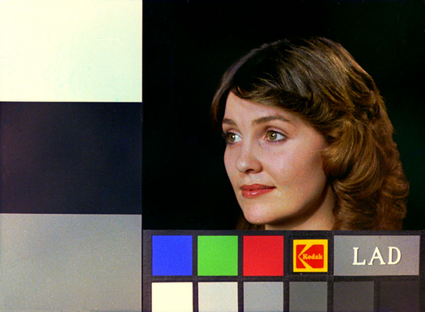

Thank you for the posted pictures, but from a technical point of view it does not help me to interpret the problem.
The frame of film 5 seem to be made with more sun than the frame of film 4, or is it because you to take more than your front lawn?
When I analyze a film, I look at the density of black, white density, and photo digits printed by the film maker.
For me, I make photographed the color slide placed on a monitor, along with a Kodak LAD scale from computer.
Reduce the Kodak LAD to the size of a photograme.
Put the two slide 4 and 5 along with Kodak LAD.
Delete the image portions you wanted to not see, and so we also had information with a clear reference.

213
The light was the same. This is in the mountains under bright sun, no clouds. I don't know how I measured the light, so exposure could be different. I think I used EOS 5 and it could be that I was metering against the white hat, compensating +2 to make it white. The light however is coming a bit from the side on the first picture and is more frontal in the second. Comparing camera left part of the hat in the first picture and frontal in the second, I think the exposure is the same (very few details visible on the hat in both places).
Disregard the grass, it's not the same in both photos.
To make comparison easier, I've color balanced against the first image. Using color picker, RGB values on the upper hat are balanced (218,218,218), but on the below one they are not(R:217, G:216, B:211). Which confirms what my eyes have been telling me: slight yellow tint (R+G=Y) relative to the first image. It could very well be that it's actually the case that the first image has a blue tint in absolute terms.
Does that work reliably? My monitor is not color calibrated, so I would be opening a whole new can of worms...

It's not really important to calibrate your monitor how to see the differences between your films and a reference such as Kodak LAD.
Images need not be corrected to see the real differences between them.
I see a big correction between the first batch of pictures and the second batch.
Again, open the Kodak LAD image at a size as a frame.
Open alongside LAD and a white page that you put the two photograms from films 4 and 5 .
Take a digital picture of the LAD and the two 4 and 5 films stills and remove the areas of the picture you want to not see.
Go.
You have to put 4 and 5 pieces of film on white instead of cuts and take pictures.

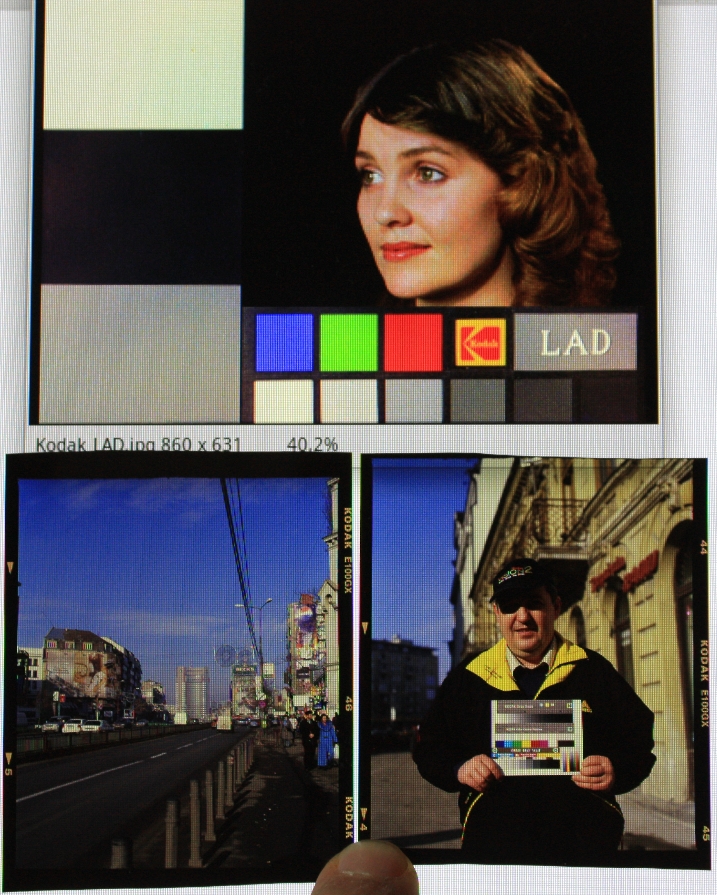

To no longer have emotions I shows you exactly how to make Kodak LAD with a film should look comparative.
To get a better idea, even if a monitor is not well calibrated (not catastrophe) is no problem.
LAD is given by the computer, and on the white of the monitor you put your films.
Photographs in digital the LAD and your films.
When I look at your digital photo I know how to correct the LAD to look normal.
Automatically and your pictures will be brought to values close to reality.

Judging from the pictures you posted, I'm tempted to say you had problems with the first four rolls but by #5 they were turning out great! ;-) If the Agfa film is Provia, it certainly has a blue cast. Not knowing how high those mountains are, it is difficult to judge the light. But higher altitudes do have bluer light. In any case, that first shot does not look right to me; the more yellowish version looks much better.
I just did my 7th roll and while the in-camera part had some issues, the development came out fine. The chemicals are right at 2 weeks old. Although Tetenal says six rolls per batch, I'm aiming for 8 by increasing all the times proportionally. From what I've seen so far, 8 will be no problem and it wouldn't surprise me if you could easily get ten (although times really start getting long).
This is a tough one to judge. Although it is my first try with the Tetenal kit, it seems pretty forgiving. I use a water bath for temperature control, but my two thermometers differ by about one degree (one is a probe type and the other infrared) so I just aim to get close. This may be a silly question, but are you sure everything was the same in-camera? No filters, the same lens, etc? Just a UV filter can make a big difference in the right (i.e. wrong) light. And in testing lenses I've found that different lenses can give very different colors.
I'll try this next week if I have time.. this weekend I'm shoting more film :smile:
I agree! I actually like how last two rolls turned out.
