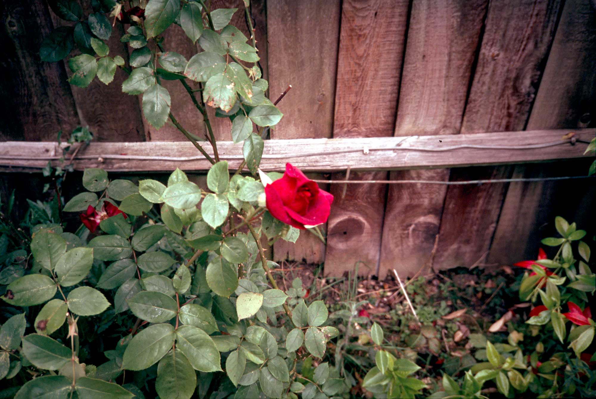

I tried this a about 2 years ago and got ok results. The film was old, expired and have been meaning to retry using fresh film. Attached is a sample but I will have to search out the original as I seem to remember it was a bit dark and had an reddish tint. At the time I discovered a forum discussion on Flickr where folk had been using Fuji Papitol, only available in Japan, as first developer and then also using a modified C41 or ECN2 colour developer. Can't recall the exact Flickr reference , some other first developers were also mentioned but I think people rely on scans to get the best results so not directly comparable.
