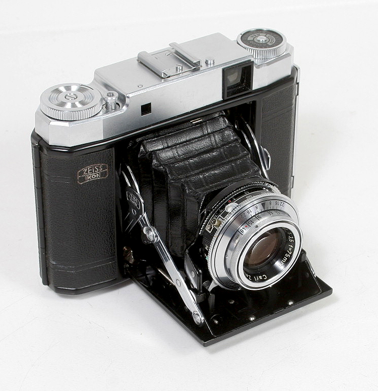

I've recently acquired a very nice Zeiss Ikon Super Ikonta III from eBay, and I just finished shooting my first roll to check for any issues with it. I would like to get some help and advice about a potential problem.
Overall, the camera seems to be in great condition. The only issue I’ve noticed is that sometimes the shutter doesn’t release after I wind it (this happens only at speeds below 1/60). Other than that, the bellows are in good condition, and the lens is pristine, with just a bit of dust. However, here’s the problem: I think the coupled rangefinder is off by about 50 cm (20 inches). For example, if I focus on a tree, the bushes in front are in focus, but not the tree.

Honestly Pablo, I'd get the camera CLA'd and the rangefinder checked over ... and can recommend someone in Bizkaia (contact me offline if you're interested). The problems you describe are very typical of old folders (sticky shutters, rangefinder issues).
This sounds and looks a lot like the issue I had with my Super Ikonta III--things I knew I focused on were not particularly sharp while other areas nearby were sharp. I sent it away for CLA / repair and it turned out that the front lens/shutter assembly was not in perfect alignment with the film plane. Took about 6 months to get it back, but from that day forward everything I focus on is tack sharp!

Is there a real issue here, or is this just the signature look of a Tessar lens?
There's a real issue with focus. Assuming your technique is in order, the likely cause is a rangefinder that's slightly out of adjustment. The lens should be capable of plenty sharp enough images; much better than what you're getting here.

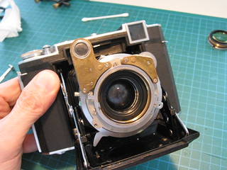

If you've never worked on rangefinder camera's, leave it to others. I've been there, it is not an easy camera to repair/service:
Super Ikonta 532/16 CLA II by Ron (Netherlands), on Flickr

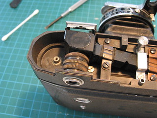

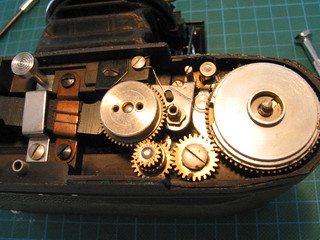

They are quite prone to having spacing problems:
Super Ikonta 532/16 CLA I by Ron (Netherlands), on Flickr
Super Ikonta 532/16 CLA III by Ron (Netherlands), on Flickr
