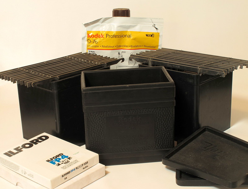

Up to 5x7 can be developed in a 1-liter Nikor tank (the kind that takes 2 120 film developing reels)-- about 3 sheets folded like tacos will fit in one. The standard advice is to get a 4x5 Crown Graphic or something like that, which is not bad advice-- you can see if you like the extra real estate without having to start out working upside down and backwards under a dark cloth, plus you can get your feet wet working upside down and backwards under a dark cloth. 5x7 view cameras are relatively reasonable, and 4x5 reduction backs are not uncommon, so if you decided to go whole hog you could still use the 4x5 film you bought for the Graphic, plus a 5x7 camera is actually "better" to shoot 4x5 film with . Anything bigger and more involved than the Crown CAN NOT be handheld, so there's the tripod expense too, but an old all wooden Graflex #2 tripod will hold most any wooden 5x7 and not break the bank or your back. Good luck!

For me, developing my own small format and medium format film (color and black & white) is much easier than developing my own large format film.
Small, Medium, Large Format by Narsuitus, on Flickr
Large Format Film Developing by Narsuitus, on Flickr

The jump from 35mm to roll-film is not too great on the darkroom side - the tanks will adapt, maybe a new enlarger/lens, some storage sheets for the film.
With 5x4 you will be looking at a new tank (unless you use the 'taco' method in a 2+ reel tank), a bigger enlarger and lens, and storage sheets for the film. Sheet film commercial processing tends to be higher than roll films because of the extra handling.
On the camera side, you will likely need three film holders (six sheets) minimum, a good tripod if you do not already have one, plus whatever camera and lens you choose.
I'd say the decision to use 5x4 if you do not have experience is more of a commitment than going 35mm to roll-film. I'd had some introduction at college with a monorail, and a chance to borrow an MPP technical later, and I got the gift of an older Beseler 45M enlarger. That just left me with solving the development issue - I found a Wista with three holders and lens going locally.

Moving from medium format to large format (4x5), is not the same as moving from small to medium format....not by a long chalk. The control you have over each sheet of film, for example....
If you have a darkroom, you can work with trays. If you have a lot of money, go for the Jobos. I use trays as well as BTZS tubes for 4x5 and 8x10. Trays for 14x17. My first 4x5 camera was a stinky old Cambo I bought in Japan. Got to be a pain after a few years having to set it up...lugging around that box... I switched to a used Linhof Tech IV. Loved that camera, but couldn't use some of my lenses with it. It got stolen and was replaced by the Tech V. I sold that and put money towards a Canham 8x10 (with 4x5 reducing back). That was almost twenty years ago. My 14x17 is DIY. A clunker but works beautifully.
