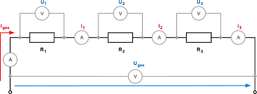

I have several 12V batteries, but that's 50% more current and that would certainly cause problems. I can solder and have fixed stuff by replacing failed components, but I lack the theoretical knowledge to regulate the output of a 12V battery to 8V. I've read about using resistors to do that, but I am still not sure enough to try.
In any good workshop there needs to be lab power-supply.
But as you hinted at your 12V battery at hand: if you put 1 or more resistors in series at a voltage source, you can take over each resistor a different voltage than the primary one delivered by the battery directly:
https://encrypted-tbn0.gstatic.com/images?q=tbn:ANd9GcRdSqrdDqWWekNLdwE11-c4YgP2-odd5--cCg&usqp=CAU
Maybe someone else now can come up with the respective math behind it...
Yes, I can borrow one of those from a friend. I should invest in one, but... :wink:
The page where you got this image from, most probably, has the math. I have found several explanations through my Google searches, but my problem is knowing how much power the Turbo will draw from the battery when cycling the flash unit (seems to be a lot more than 160mA). I don't know what happens to the circuit if the draw exceeds the resistors' rating.
I am not very fond of the idea of having things exploding in my face. :D
Thanks for the help!
Cheers,
Flavio
I think I have just understood a little more about the issue: resistors are only useful when the current draw is constant. In my case, the Turbo will consume pretty much nothing when "idle", but a lot when cycling the flash. When idle, the resistors would be dissipating a lot of power. I need a better solution.
