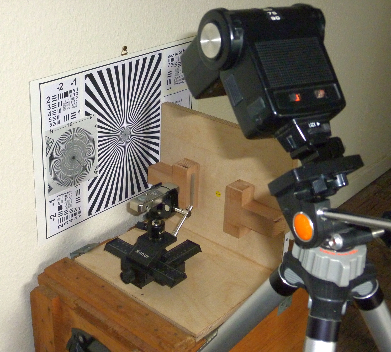

I have a different criterion for home use. Because I print the test charts myself with only 600 dpi, the center of the Siemens star and the very small elements of the USAF charts are not good enough for good lenses at close distances. But that is not a problem at all. I then increase the distance so far that the lens can only manage the larger rays and elements and thus get exact evaluations.
That's why I had to use a distance of 6.7 m (!) for the Sony alpha 6000 with macro lens in my example in the article. At 1 m, the camera-lens system would have been too good for the test chart and an evaluation would have been impossible.

Who has ever tested lenses at home? What experiences have you had with this?
In order to test the resolution of cameras for which there were no evaluations yet, I was forced to carry out tests myself. But I had never done this seriously before, so I had to find out more first. There are many tips online, but they were either too technically complex or they were just the author's emotional assessments.
I was tired of hearing 'creamy bokeh' and 'sharp corners' in lens review videos. With a little effort, I could carry out meaningful lens tests at home. The results may not be as good as professional laboratory tests, but in most cases they were sufficient to get to know my own lenses better.
Do you have any ideas or comments on how to improve my process?

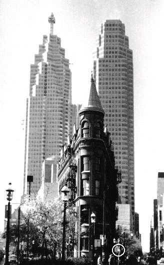

I have a very relevant photo.net post to share, however! Last year I was heavily researching this topic and came across this interesting guy, Martin Tai, who made a post in 1998 about testing the lens on his Minox. Seems to be a giant Minox fan, he kept this thread updated until 2004 with his experiments, and he includes some photomicrographs (you need to use the wayback machine to access them).
He also shared it on this Minox user's group on usenet on which you can find an archive of these posts with better formatting. The broken formatting on photo.net hurts my eyes :c
Towards the end of the thread he explains the Minox's performance: as an example, shrinking a Tessar design down by 3x, making a smaller image circle, would make the focus circle 3x smaller. I had never considered that until then, but it makes sense. Especially considering APS-C lenses perform spectacularly... on a smaller image circle as well.
Here are a pair of his images from this post in case wayback isn't working for those links (for reference: the Gooderham Building in St. Lawrence, Toronto, Canada):
And the associated crop of the street sign:
As an epilogue to this inclusion, he is still sharing photos he's taken on Minox film cameras to this day, nearly 26 years later. He last shared some a few weeks ago. I admire this guy's tenacity and love of the format!
