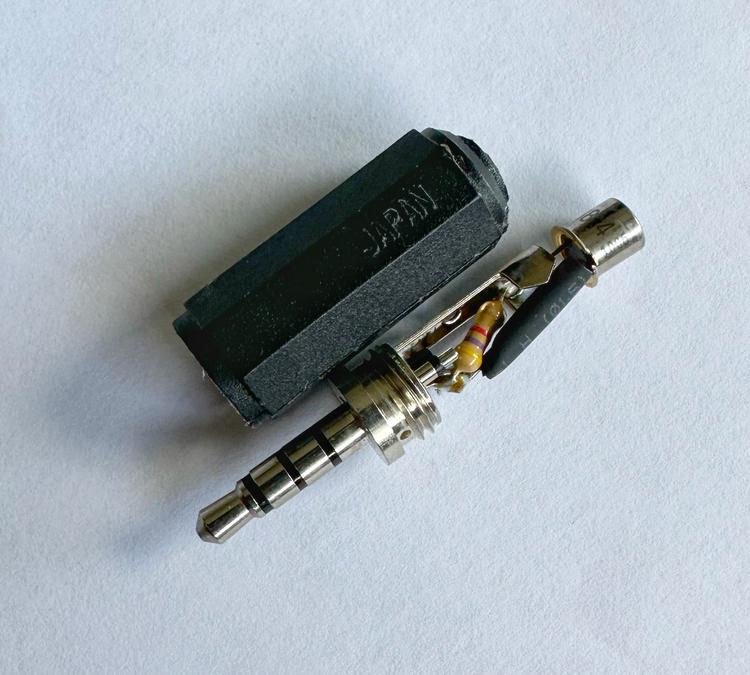

It works reasonably on its own on mid to lower speeds, but much better if you get the PhotoPlug sold by the manufacturer Filmomat.
I think the price for the PhotoPlug is offensive for what it is, but considering the cost of film involved in OP's testing project, it may be justifiable.
The PhotoPlug is just a phototransistor and a resistor soldered onto a TRRS 3.5mm plug and can be easily made at home without violating anyones intellectual property - there is nothing novel involved.
This is how mine looks inside.
