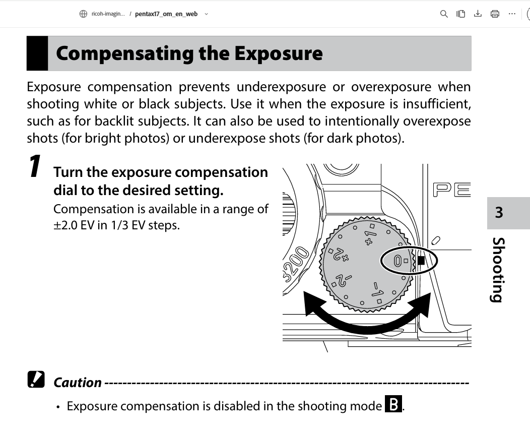

Isn't it a Pentax 17? If it is, see page 29 of the manual:
1) look at your scene;
2) gauge how much, in stops, the total centre area of the scene varies from an average of mid gray;
3) use the exposure compensation dial to adjust accordingly.
Naturally, step number 2 is something that is harder to do when you haven't much experience, but it becomes easier to do with practice.

Ah yes, I looked back at other threads and see you have a Pentax 17. Looks like your only control for individual shots is the exposure compensation dial. So you will need to anticipate the kind of situations where the camera will tend to over- or under-expose, and guess (or learn by experience) by how much. I can see why you were quite interested in Thornton's 2-bath developer!
Step one with a camera like the Pentax 17 is to familiarize yourself with the meter reading pattern - where is that centre weighting?!
Miscommunication. For some reason I took "meter override" to mean that you turn off the meter and set the exposure manually, but of course that's not what "override" means.
Yes, it definitely has an exposure compensation dial, and that's what I rely on to coax the light meter in one direction or the other.
