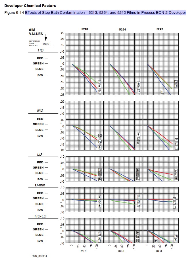

I was thinking about ECN 2 process.
On the machine there are drop wipers between solutions that reduce transport from one solution to another.
I'm at home, I use a short rinse between the developer and the stop at ECN 2 process.
I read that the CD 3 transport in the stop bath should be small.
It's a graph from Kodak.
In the negative color process for the minilab, all sorts of solutions are sought to shorten the development time.
Grorge
  • Effects of Stop Bath Contamination—5213, 5254, and 5242 Films in Process ECN-2 Developer.jpg
