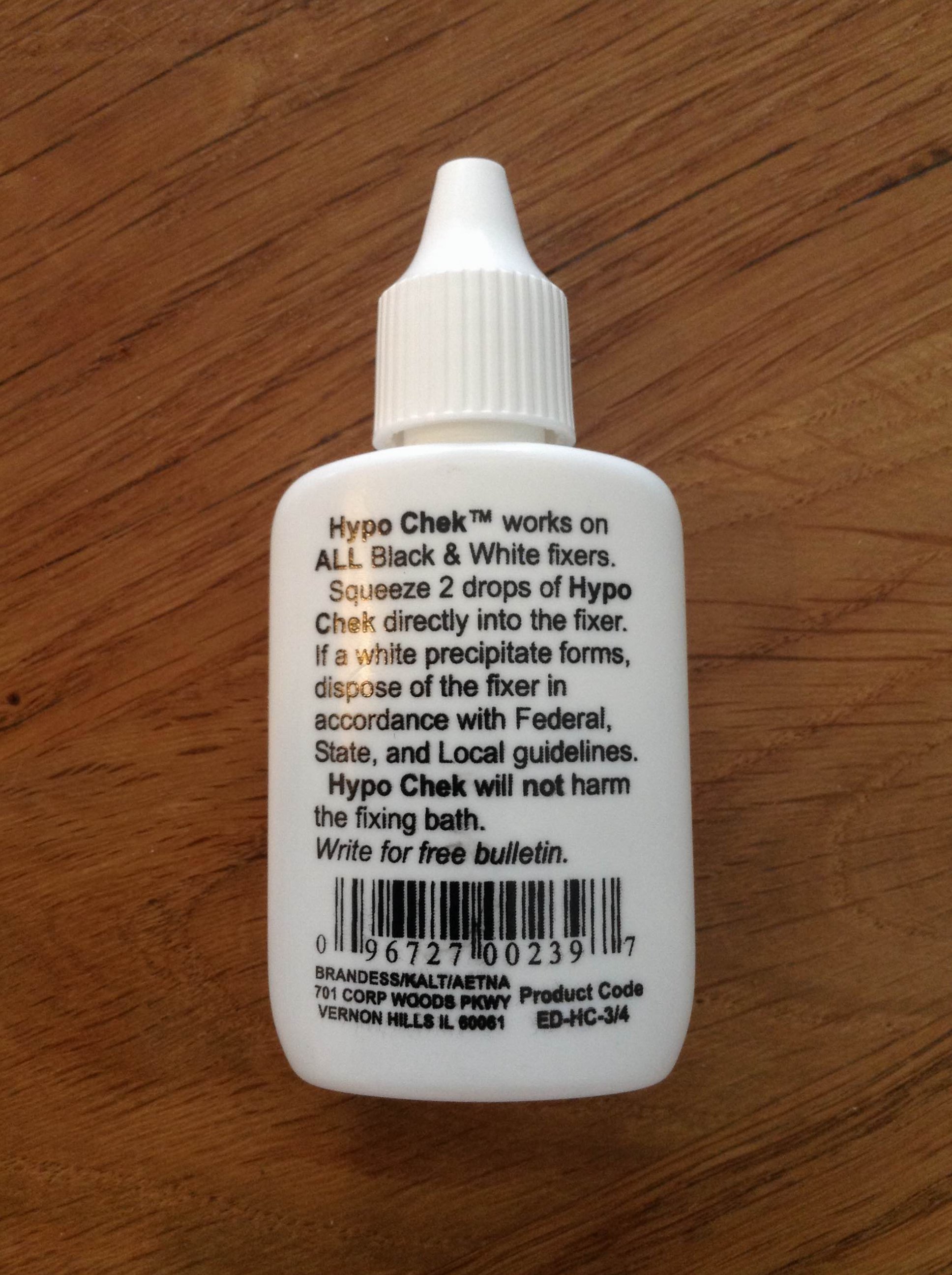

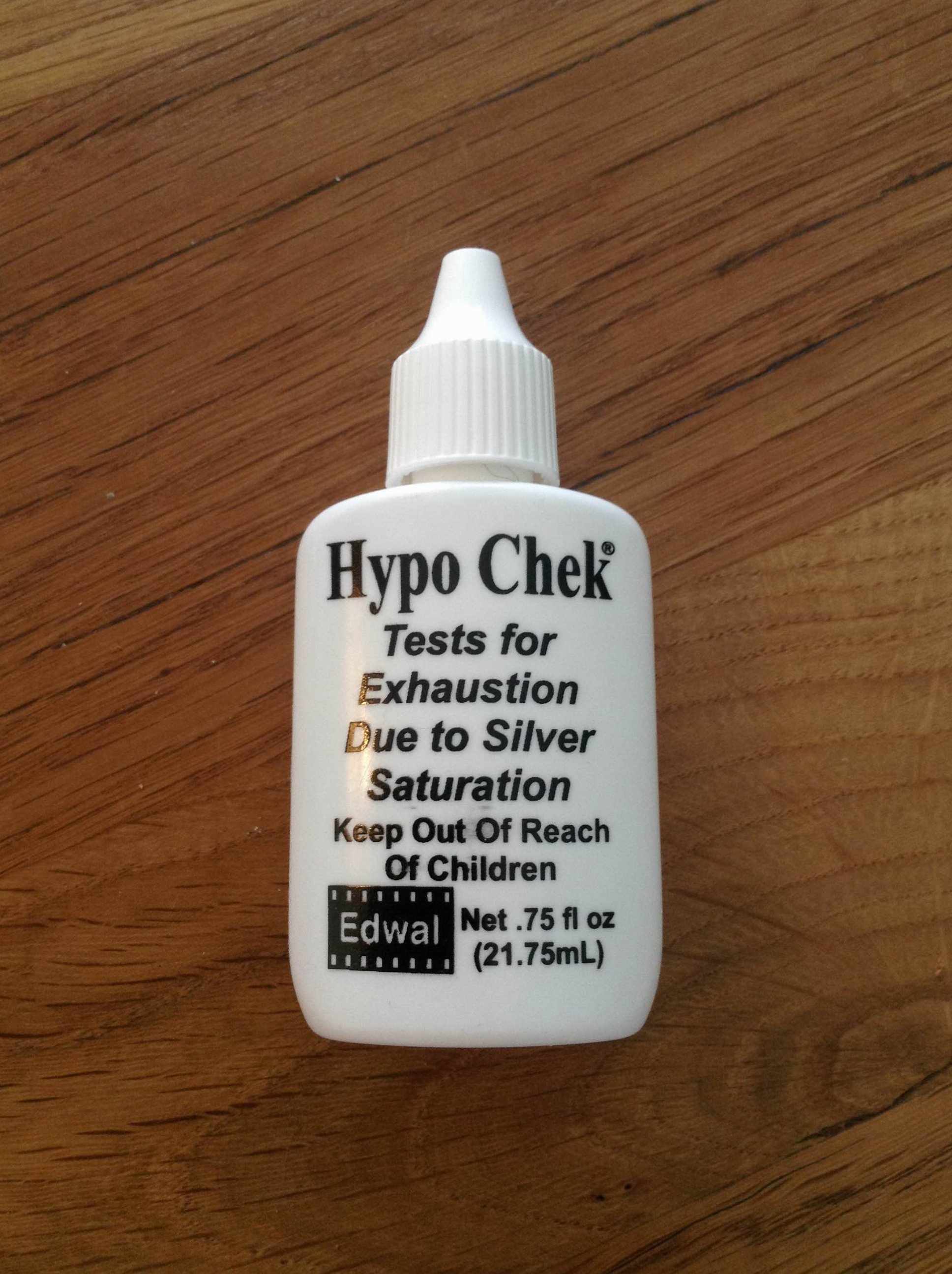

Ghostman
Dec 5, 2011
504
Switzerland
There is also this:
attachment.php
attachment.php
