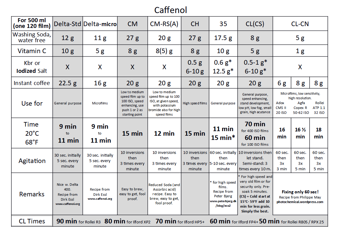

Welcome on board, here you most of the recipes around. CL and CLCS are my preferred.

It depends of the type of washing soda you have. You need anhydrous washing soda (powder), if you have decahydrated (crystals) you need to multiply the quantity by 2.7 or put it in the oven at 100°C (212°F) until all the water is evaporated.
Your vitamin C must be powder not tablets, they often put other things in that...
You can also have a look at the Caffenol Cookbook & Bible and there is also a Caffenol group on Facebook.

Yes, I use 1-2 cl of hot water from my kettle for washing soda and same for vitamin C in separate glasses. But I use 20°C (68°F) or even 15°C (59°F) for CLCS for instant coffee in a glass. When everything is dissolved I add refrigerated water to bring down the temperature and mix them together and add the rest of water.
I would not prepare in advance, because the vitamin C is rapidly degraded, especially in the weak recipes CL(CS) and CL-CN. With refrigerated water you can rapidly be ready to develop a film at the right temperature.
The CL recipe and CLCS for high speed films brings less apparent grain and more details in the shadows. When pushing or pulling you add or subtract 10 minutes per EV. I love XP2 and Tri-X @100 ISO !
