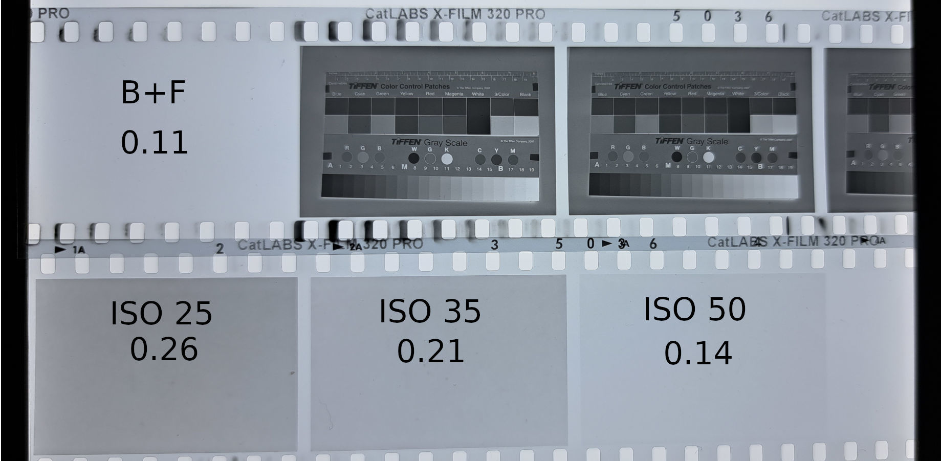

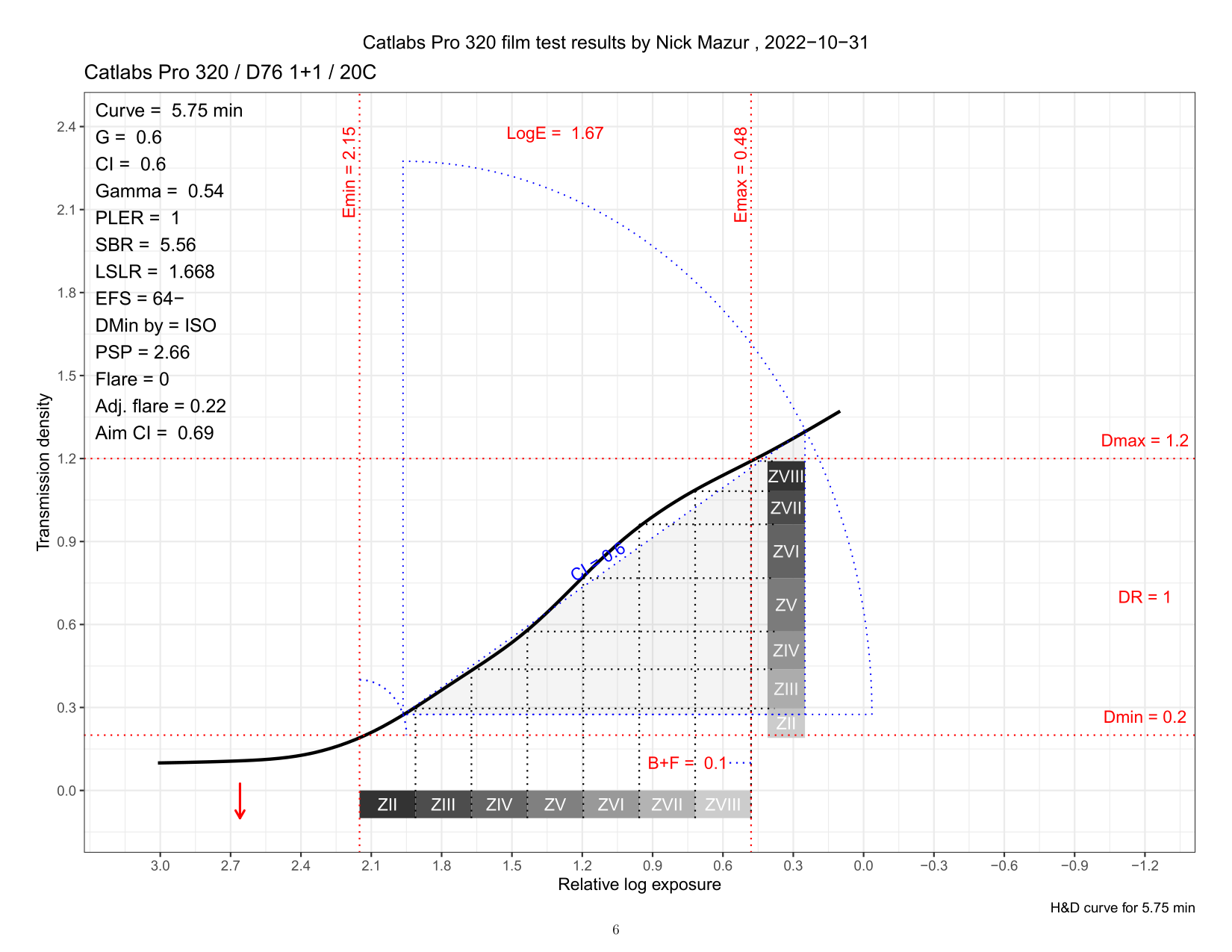

My son set up a "Fred Picker" film test for me the other day to see how the Catlabs Pro 320 would respond to a commonly used EI measuring technique among Zone System practitioners. The idea is very simple. I will describe it here so other forum members can try it for themselves. Photographers who do not do Zone System, can probably disregard this post. The procedure has quite a few more variables than my previous curve family test, so, by design, it cannot be as accurate. However, as a lot of Zone System photographers have found over the decades, it is capable of obtaining reasonable results, esp. for sheet film use.
  1. Place a black card in shade (to simulate Zone I).
  2. Put camera on tripod.
  3. Focus on infinity.
  4. Fill the entire frame with the card.
  5. Set the spot meter to ¼ of manufacturer’s recommended speed (here ISO 25, based on my curve family test, in which I used an ISO 100 exposure) (f/2.8** at 1/15s, determined using a Minolta Spotmeter F).
  6. Close down 4 stops (with aperture and/or shutter speed), thus placing exposure on Zone I.
  7. Transfer reading to camera and expose.
  8. Close down and expose subsequent frames in ½ stop increments (I used a Minolta X-570, in good operating shape and a 50mm f/1.7 lens).
I processed the film in D76 1+1 at 20C for 5:45 min. (determined in my curve analysis to be reasonably suitable for my purposes) in a rotary processor. I put the film strip on a light table and took a picture with my cell phone. I labeled the frames in Gimp. The results show that the "working" film speed for Zone System purposes is about ISO 35 (0.1 over B+F, so 0.21). I repeated the test twice on the same roll, giving identical results. Before you guys express your disapproval for the low speed obtained here, let me just say that this procedure is very conservative and focuses on providing ample shadow detail. For example, Fred Picker found Tri-X to be ISO 140. Others will probably corroborate this based on their own experience.

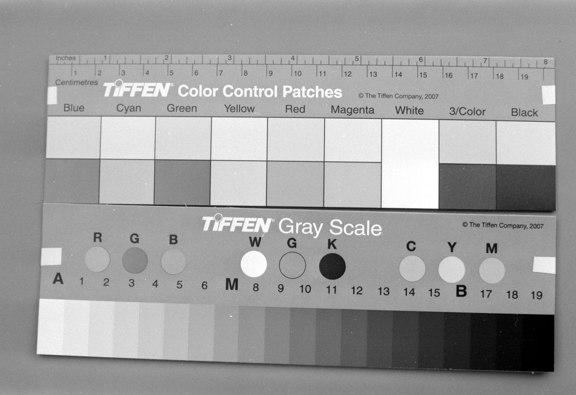

I also exposed a Tiffen color chart metering for ISO 65 (as determined in my curve analysis) and exposed 3 frames. I did this mostly to do a crude, but somewhat effective (I believe) color response analysis. I metered for the grey card to get my exposure (background behid the color chart). The frame was then scanned in using Vuescan's default settings for generic black and white negative. The scanner is old and not meant for photography but that's the best I can do. I also did not control any of the default Vuescan settings, so please, take this with a grain of salt.
And here's the color picture of the chart for comparison. The spectral response obtained here seems to confirmed the findings from my very first test to some degree. I will abstain from speculating further, as I lack the necessary data to make any kind of conclusion. I still plan on doing a more thorough spectral response test, but it'll have to wait until my health improves a bit.

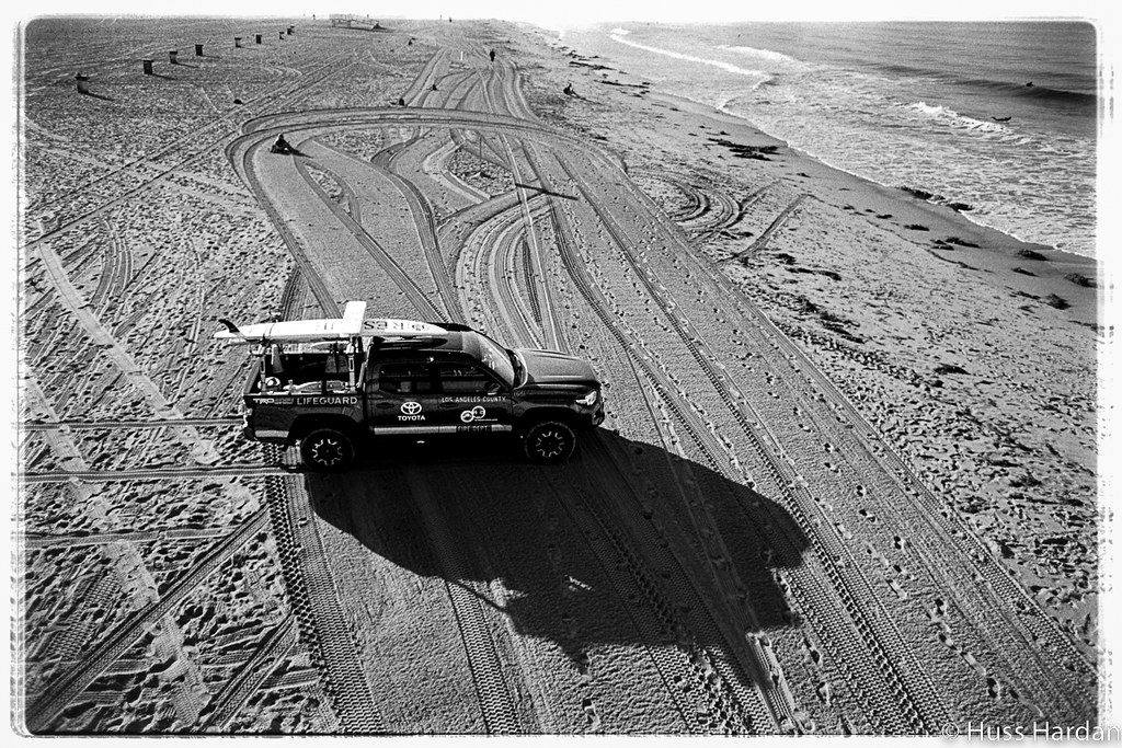

CatLabs 320 in DF96. ISO 200. Severe bromide drag on this roll, but when I developed a roll of Acros II after this, using the exact same technique and the same bottle of DF96 - no bromide drag. These pics show it far less than most of the others on this roll.
So I cannot recommend CatLabs to be developed w DF96 Monobath.

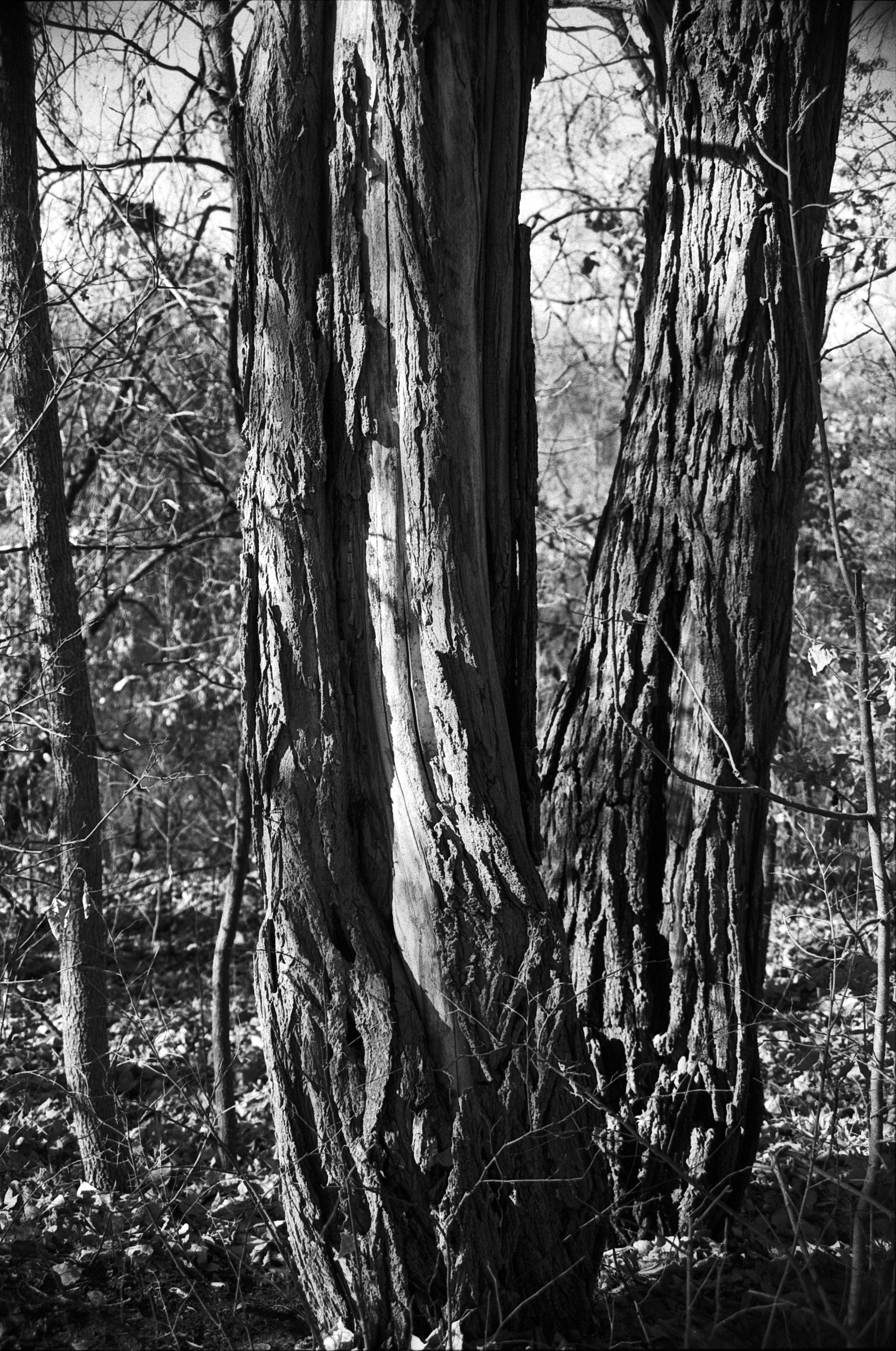

Leica R9, Elmarit 28mm 2.8

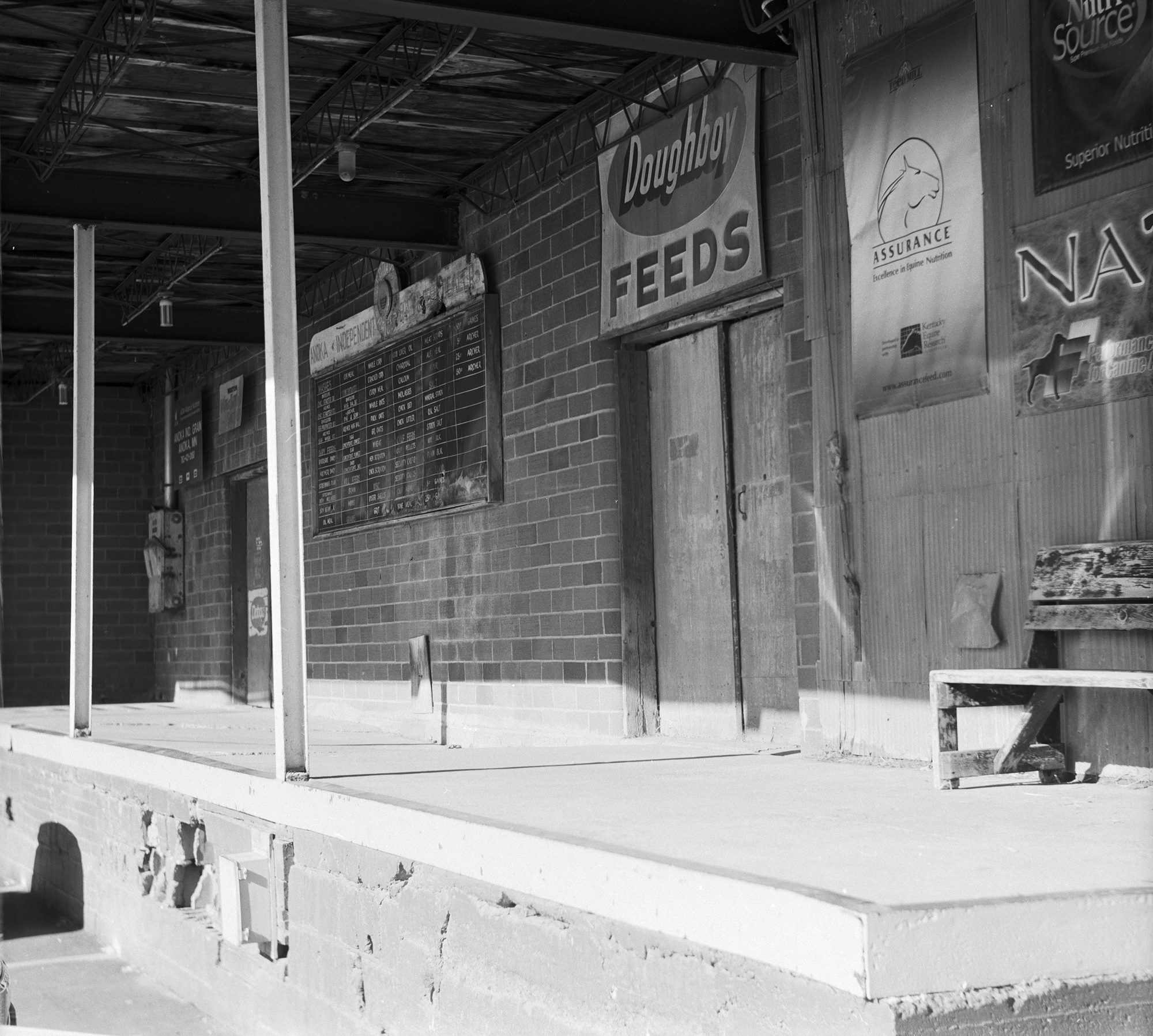

Our first attempt, my wife was shooting catlabs 320 pro with a Fuji GS645S It has center weighted metering and we set it at 200 ISO as recommended for HC110. We went to the local camera meet up and shot in some rather challenging conditions. It was indoors at a warehouse brewery with large windows that probably should have been spot metered. I developed as recommended, HC110 for 10.5 minutes. I use an Epson V850 with Silverfast. The negatives were very thin and contrasty, I had to do a lot of adjusting to get a halfway decent scan, even then I wasn't pleased. The histogram was basically a steep hump on each end and nothing in the middle.

Since I did the Fred Picker test for Zone System photographers, I thought I'd include a plot of how the 5:45 min. film curve relates to the typical seven-stop subject luminance range and to the resulting negative. This assumes the use of a condenser enlarger. This film shows some nice and wide tonality in ZV and ZVI, with some compression elsewhere. I think this is very consistent with most of the photographs shown in this thread, in my opinion.

Our first attempt, my wife was shooting a Fuji GS645S. It has center weighted metering and we set it at 200 ISO as recommended for HC110.

The lower slope in the right third of this graph means the film is "self-compensating" (a term I just invented). That means to get compensation, you don't need to use Diafine; this film compresses highlights for you. That aspect of this film could be beneficial because the human eye is less sensitive to shadow contrast than highlights. Therefore, it's best to have more contrast in the shadows, as that curve portrays. If that curve retains its shape when the film is not overdeveloped, I'll be tempted to buy some.

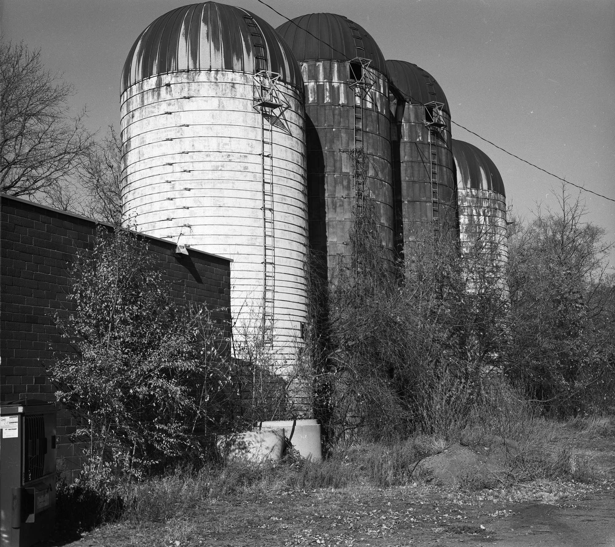

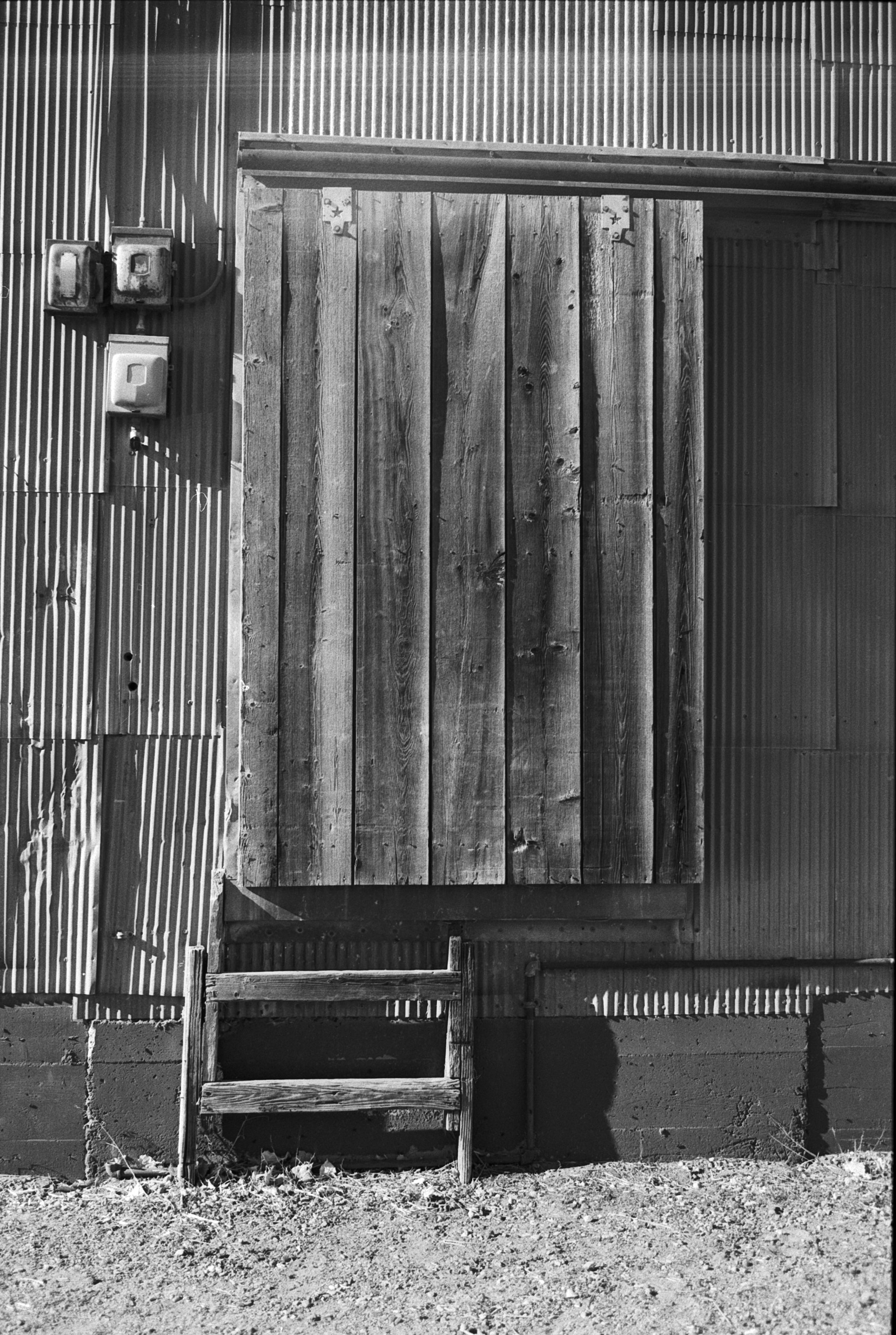

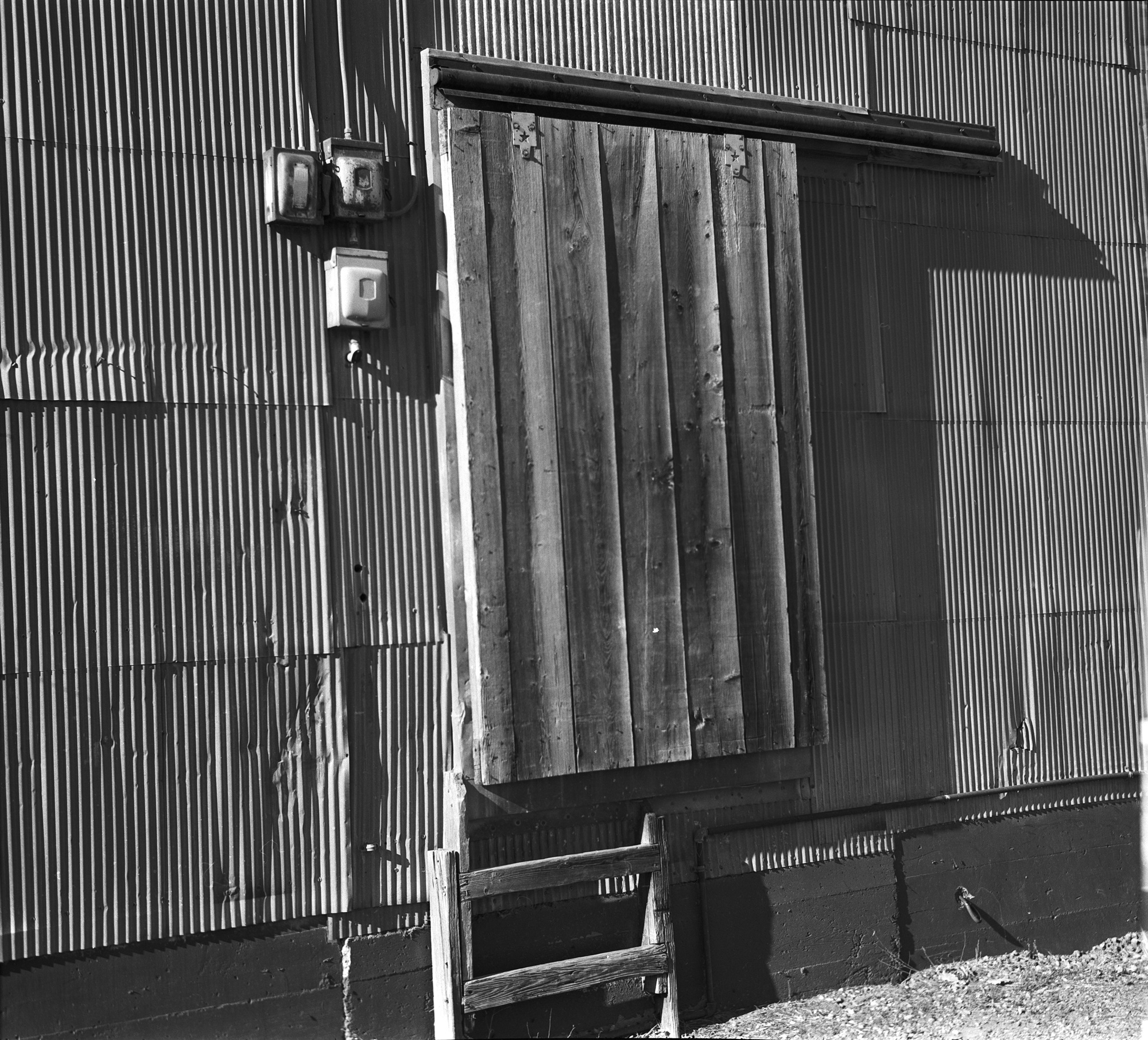

For our next attempt at shooting Catlabs 320 Pro, I decided to over expose and under develop, at least based on the box recomendations. Meters were set to 100 and developing time was reduced 20% to 8:15 in HC110. I should note that in all of the rolls I have developed in HC110 the grain is very fine.
I shot my Dora Goodman 6x6 3d printed camera with a Tessar 100mm F3.5 mounted. It's from a Graflex XL and the Synchro Compur has been tested to be accurate. I used a phone app for metering, who knows how accurate that is, but I've been happy with the results. My wife was shooting her Pentax ZX5n with a Pentax 35-70 F3.5-4.5 zoom. She was using matrix metering. It was a bright sunny day with no clouds, late in the afternoon.
I was very happy with the scans, the histograms looked normal, some peaking in the shadows, some in the highlights, but good midtones on every shot. The only adjustments made were to bring the highlights down to the top of the histogram results. I would definitely shoot and develop it this way again. It still has a moody look, but much denser negatives with more detail in the shadows.
Some of my wife's photos, I think the vignetting is from an old hinged lens cap that is intruding:

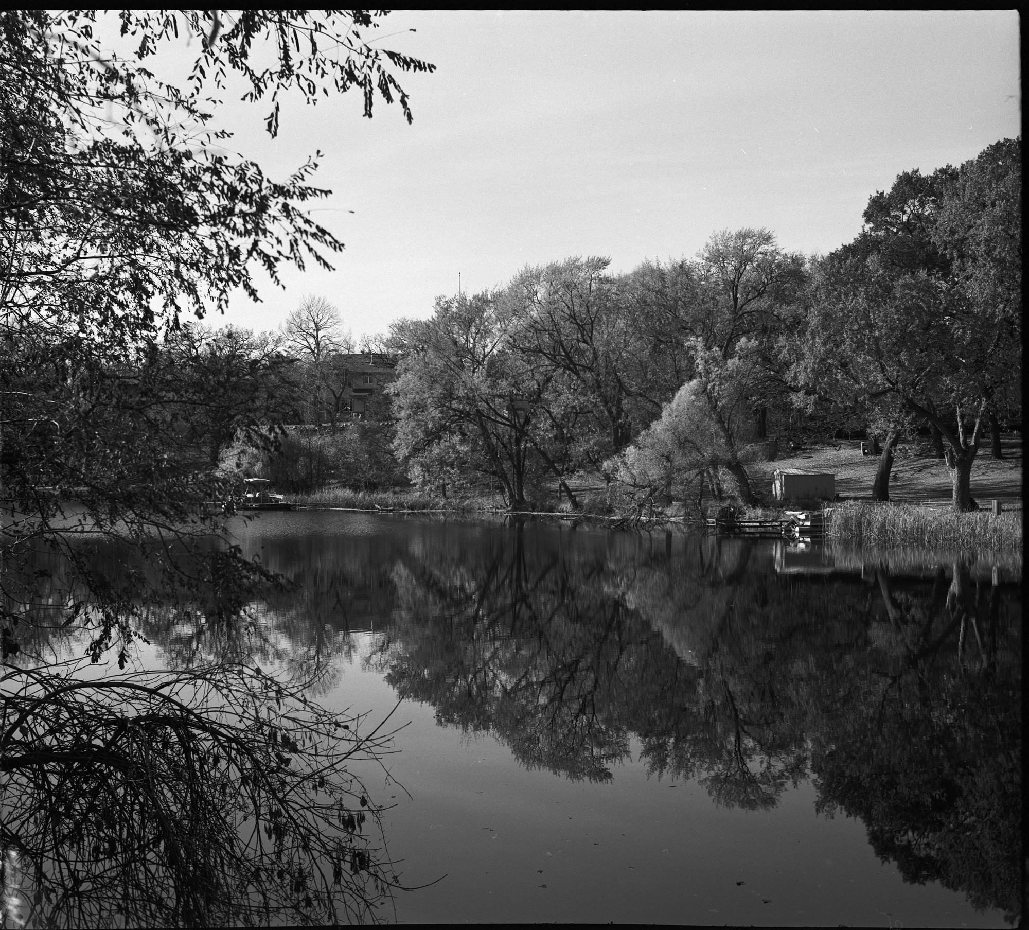

And some of mine, scale focusing a 100mm lens is a leap of faith.
The last photo has white concrete in full sunlight and completely shaded overhang with plenty of detail.
@Dwight Anderson, it looks like you have found your personal EI and development technique...the "overexposed/underdeveloped" images look great.

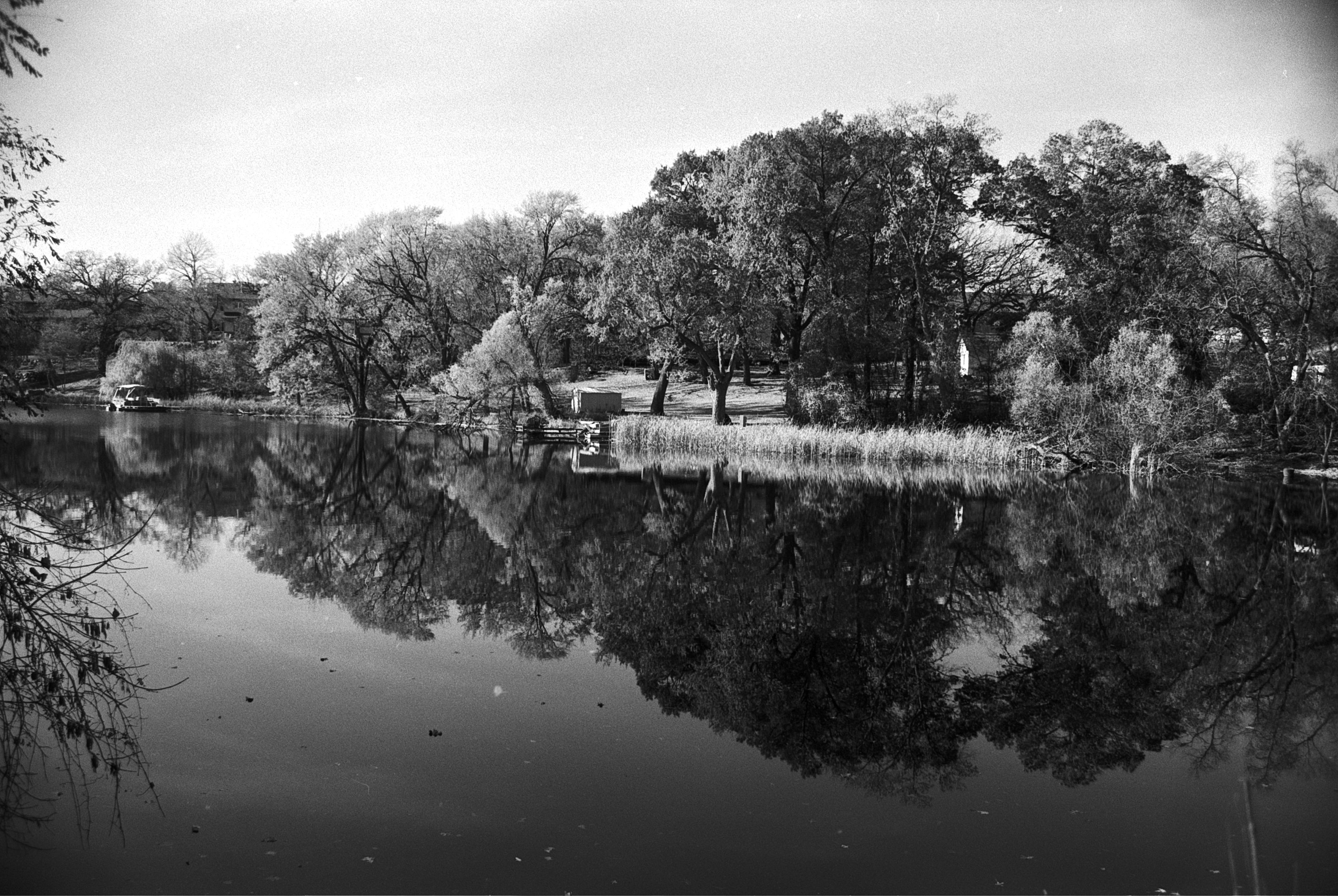

Those pics over the lake are so nice.
