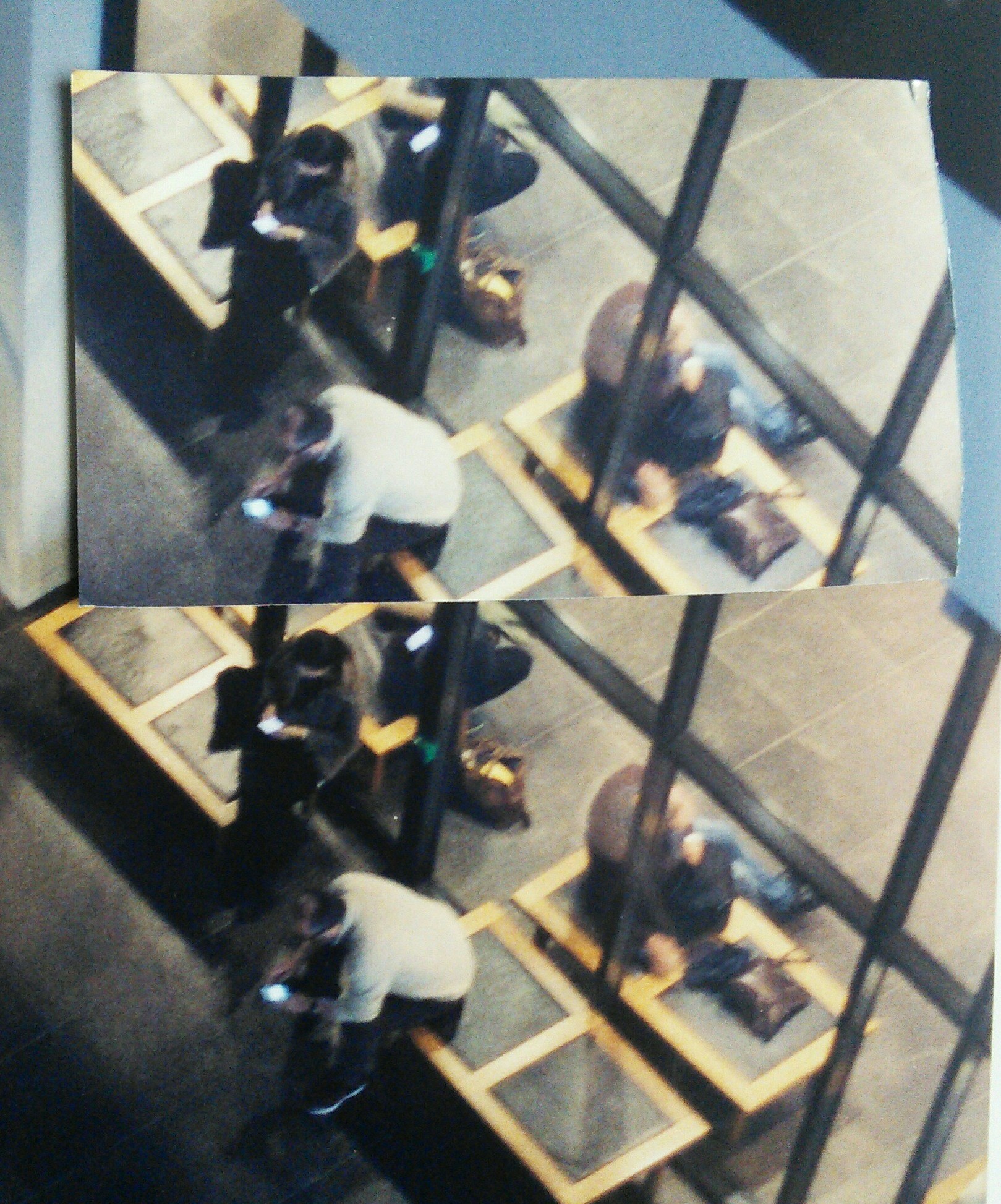

Thanks for the advice Mick. I think you might be right. I normally expose 5 mini sections on a test strip (1/4). When I made the full print I did have the bulb on for a while as I composed the image on the easel and checked the focus. I'll test it out and see if that's the cause.
I've also attached an image showing a section of test strip on the full print to show the difference.

I'm not sure your development is complete in the test strip. That's the first thing I'd rule out : make sure that test strips and full sheets get the same development.
For a buld-warmup difference, the difference between the print and the strip that you see is really quite large. I never see this kind of difference even though I always do strips at 2 sec increments which means the bulb has to warm up quite a few times. The difference is never even close to the difference I'm your prints which is something like half a stop or more.

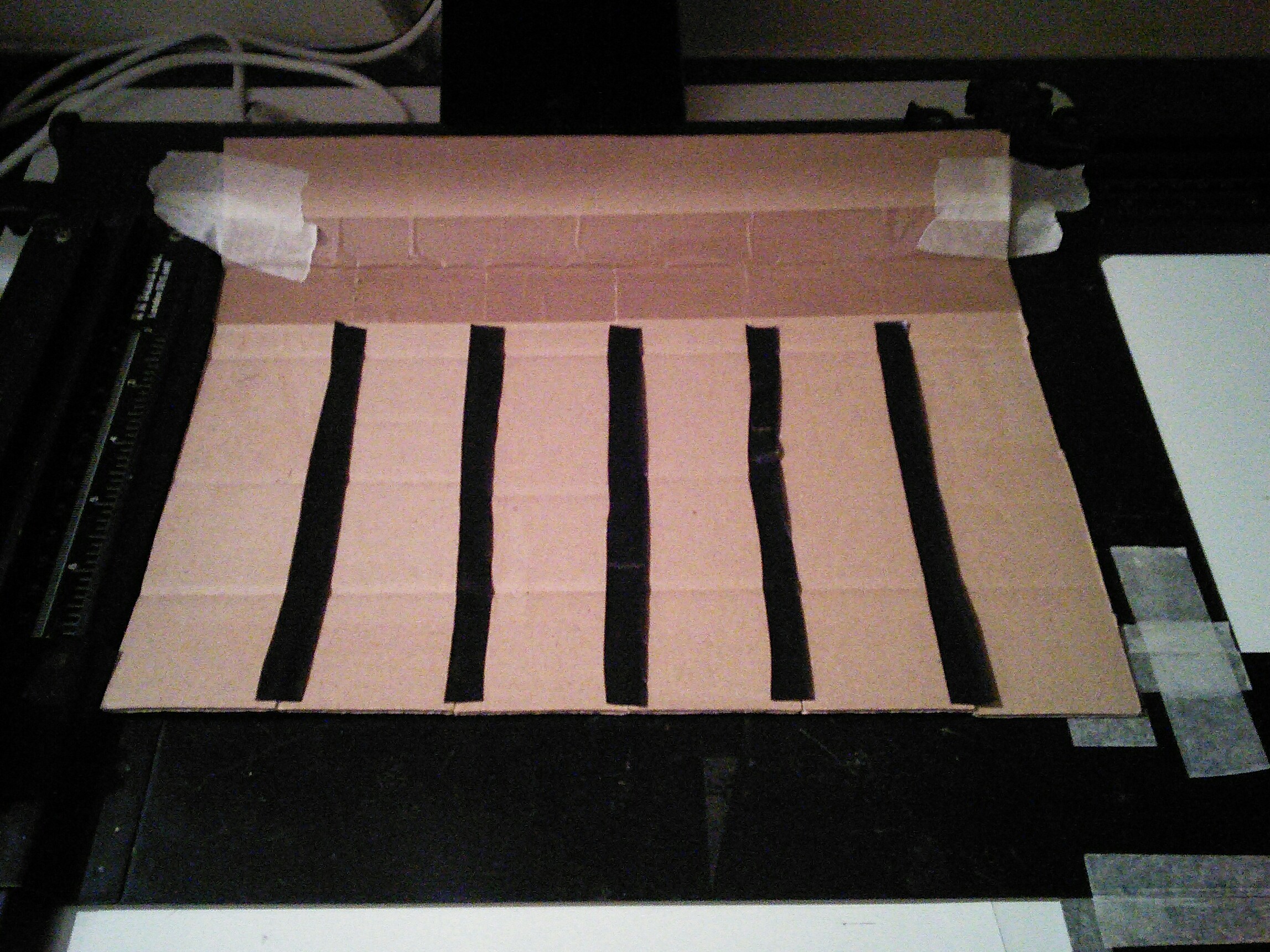

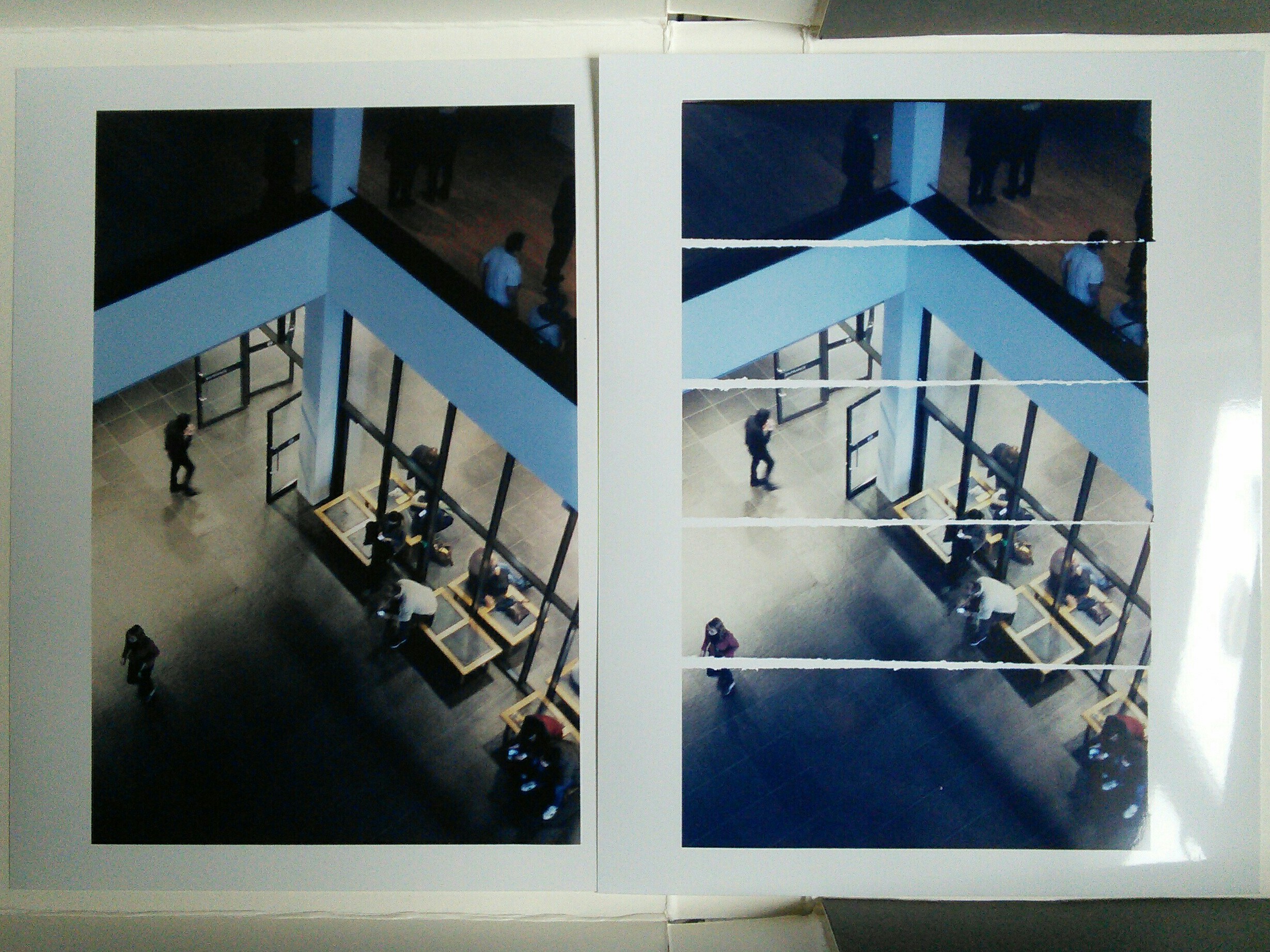

Thanks for all the continued advice everyone. I've been trying everything to figure bout what's causing the difference. I was convinced that the test strips were underdeveloped after koraks suggested it but it's not the case.
The only thing I could put this down to is that I use this homemade mask for my test strips so I can expose small areas at different colour filters. This is made of cardboard and for some reason that I can't understand this is causing the difference. It's more of a cyan cast when using it as when I texted at longer exposures the cast was still evident.
Bumba
Mar 10, 2018
122
Wolverhampton
This is the cardboard mask I use on my easel. I normally use it on test strips but used it on a full sheet for this one. It's made of cardboard and the black strips are tape to stop light getting through.
This is the difference caused by using the cardboard mask. The paper, chemicals, temperature, enlarger height, timer and filters were all kept exactly the same. I normally change filtration for each segment when using the mask but on this example I left them all the same so I could see the difference between the two prints.
I hope this makes sense and someone knows what's going on because I'm so confused as to why this is happening.
Sorry for the long post and thanks in advance

MattKing
Apr 24, 2005
52,834
Delta, BC Canada
Your mask is reflecting red light on to the paper, leading to a cyan cast.
Res Ipsa Loquitur :smile::whistling:
