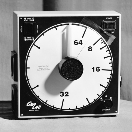

who, if you stop kidding yourself, can see the difference in density between 20.9 and 30 seconds
Nobody, because it's only about 1/24 stop. Nevertheless, you can see 1/12 stop easily on normal grade paper. The beauty is that the f/stop differences are always the same, regardless of exposure time. Linear timing diferences vary with exposure time.
Look at the attached file. Major increments are in 1/3 stops, minor increments in 1/6 and 1/12 stops.
