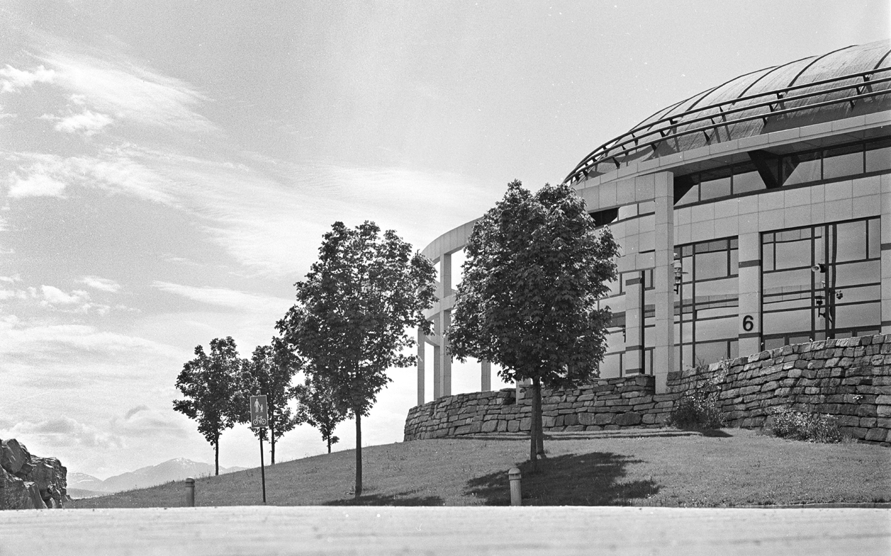

Today it was Kodak Technical Pan, Kodak Panatomic-X and Rollei Retro 100 Tonal in my bag. All in 120.
Technical Pan shot at ISO 20 developed in Rodinal 1+300, Panatomic-X shot at ISO 20 developed in Rodinal 1+50 and Retro 100 Tonal shot at ISO 50 developed in Rodinal 1+300
The 3 first links are re-sized and sharpened shots to show the object:
Tonal: http://www.tmax100.com/photo/panx_tp_tonal/tonal.jpg
Panatomic-X: http://www.tmax100.com/photo/panx_tp_tonal/panx.jpg
Tech Pan: http://www.tmax100.com/photo/panx_tp_tonal/techpan.jpg
The next 3 links are 100% crop of the nameplate on the right corner of this object taken from the pictures in the 3 first links at full size:
Tonal: http://www.tmax100.com/photo/panx_tp_tonal/tonal_uts1.jpg
Panatomic-X: http://www.tmax100.com/photo/panx_tp_tonal/panx_uts1.jpg
Tech Pan: http://www.tmax100.com/photo/panx_tp_tonal/techpan_uts1.jpg
All the shots above are done with Hasselblad 500C and a 150mm Carl Zeiss T* F4 on F8
The next 3 are 100% crop with Hasselblad 500C 150mm Carl Zeiss T* F4 on F8 with 55mm extension tube. Distance from wall 60-70 cm:
Tonal: http://www.tmax100.com/photo/panx_tp_tonal/tonal_uts2.jpg
Panatomic-X: http://www.tmax100.com/photo/panx_tp_tonal/panx_uts2.jpg
Tech Pan: http://www.tmax100.com/photo/panx_tp_tonal/techpan_uts2.jpg

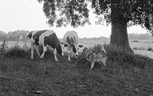

Well I took some time for a walk along the river Maas.
Here my example, now on 35mm, equipment: Leica M7 + Summicron 2,0/50mm
Retro 100 Tonal film, E.I. 50 in CG512/RLS 1+4 for 14:00 minutes, 24C. An easy development (= room temperature) on the attic due to the warm weather.
In my Flickr stream on other formats.
3200 dpi V500 scan.

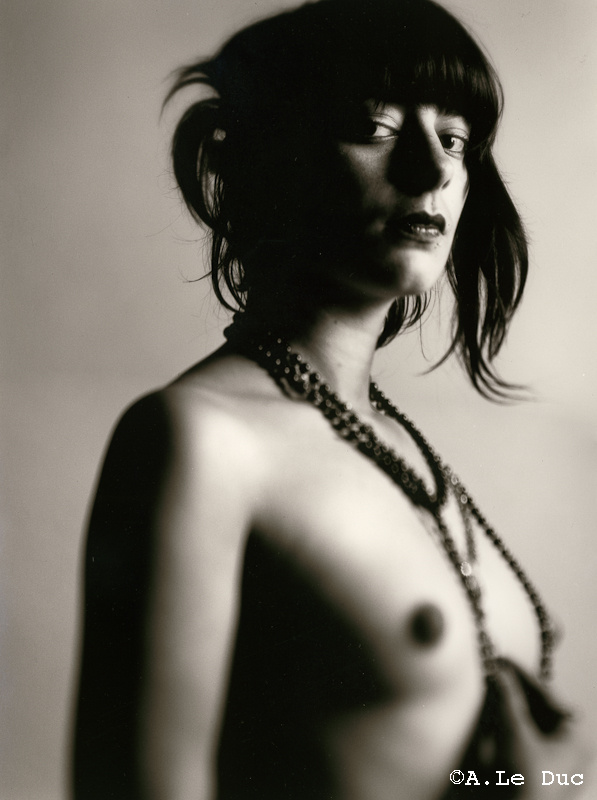

I have just printed a 4x5 negative on Foma MG131 30x40 cm.
Tonal was developped in PMK. Print was selenium toned.

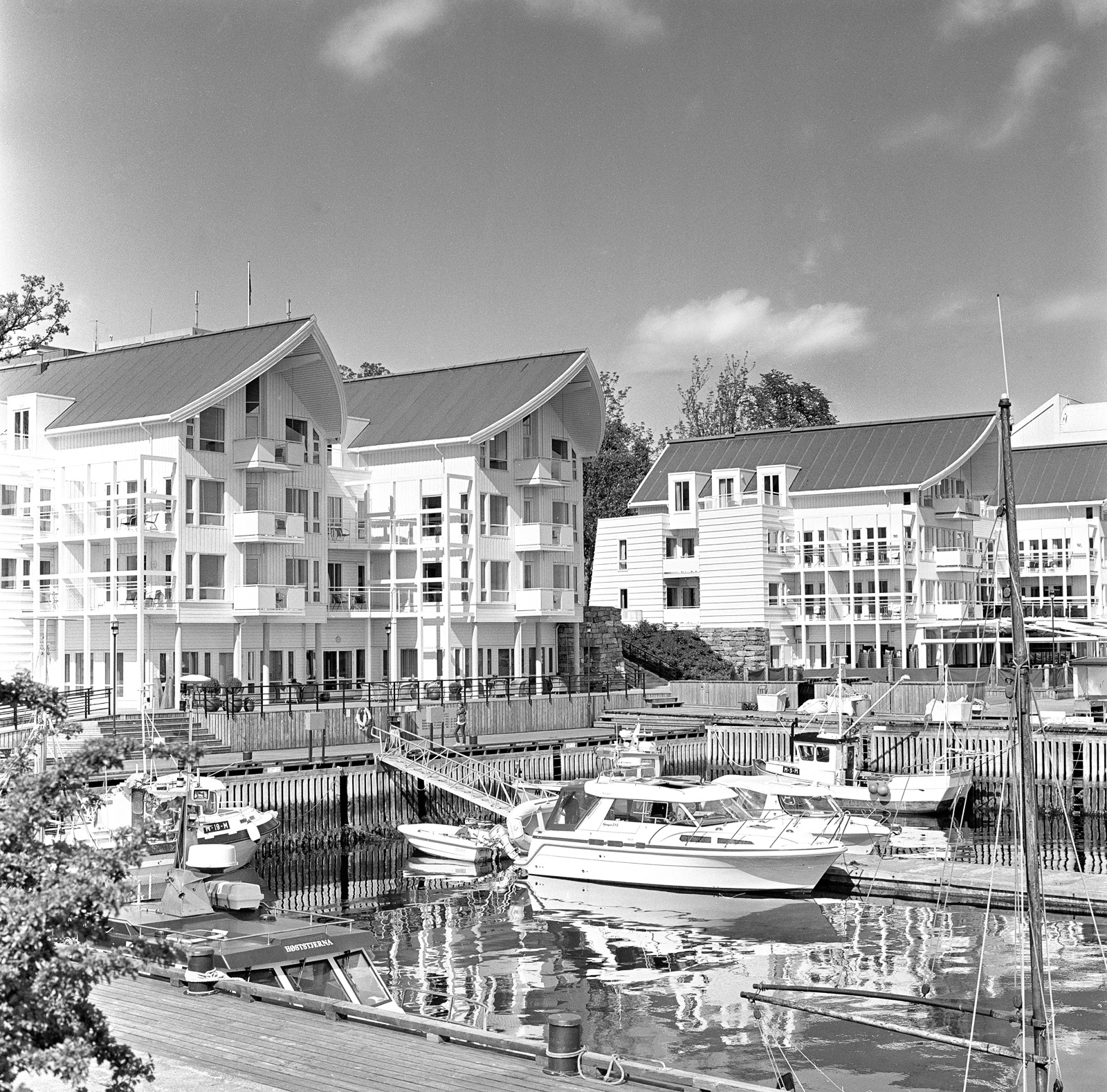

More from the beautiful docks of Molde, Norway. Rollei Retro 100 Tonal in Rodinal 1+300 semi-standdevelopment 30 min. Film @iso 25 1/125 F8
I feel like I am an amateur again :smile:
Indeed great results.

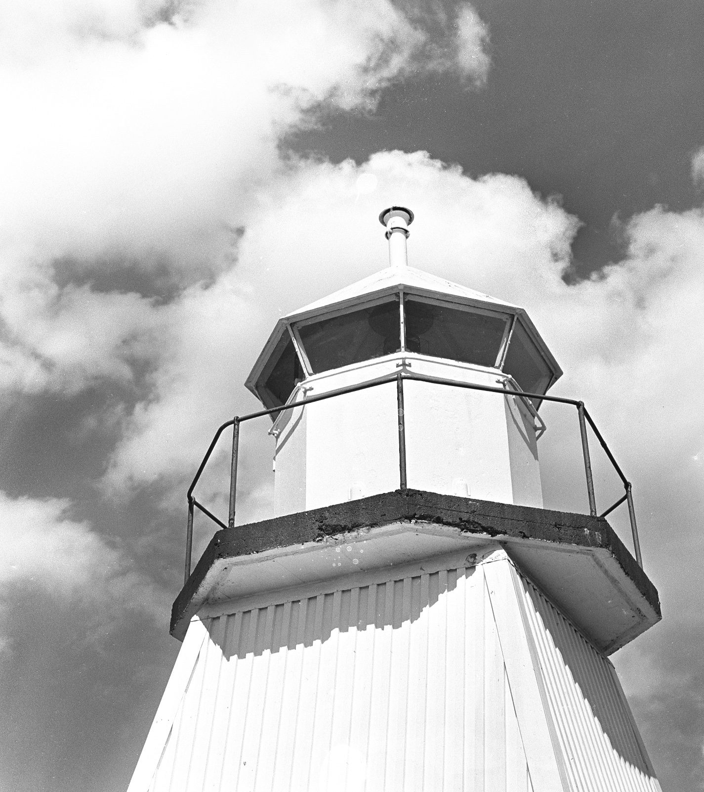

It IS the water, I also tested them out. With simple demi water you do not have it. BTW I did not have them with AM74 (in tap water) or CG512 as well. With Rodinal the "problem" is there. Not sure where it's comming from.
Left side is light leak
You have to keep the roll straight and tight when unloading. Polyester tends to unroll so tight and closing the end strip. Otherwise you will have a light leak on Polyester film material (Foma, Efke, Rollei aso.) .
Polyester has advantages and disadvantages but this Polyester film lays down very straight where Fomapan 100/400 and Efke 25-50-100 on 120 rollfilm (Polyester) is curling much.
Next Tonal film is on adventures Ravenstein 650 years, incl. a battle field near the river Maas. E.I. 100. 667 RF camera.
