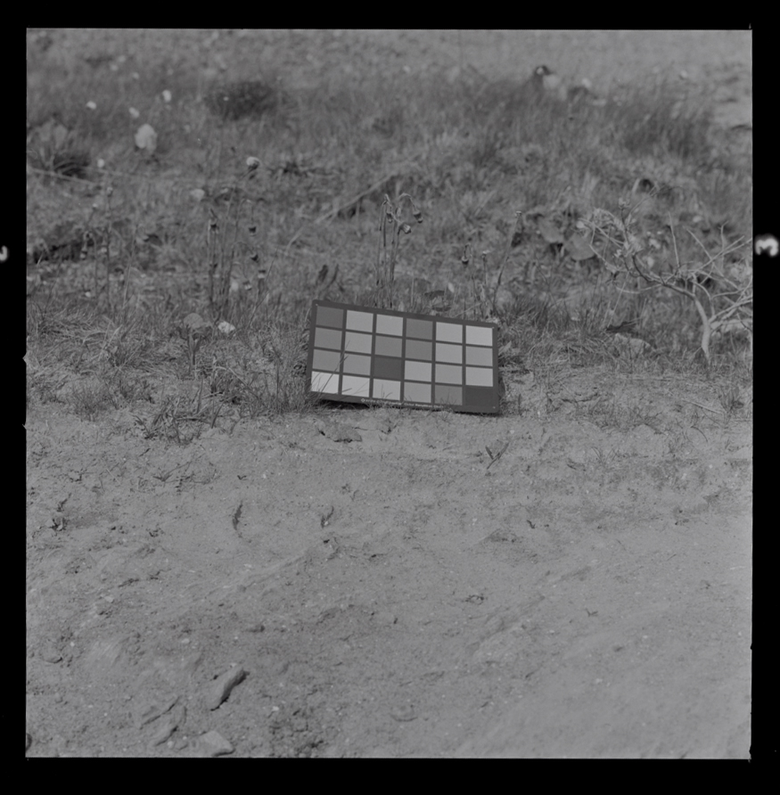

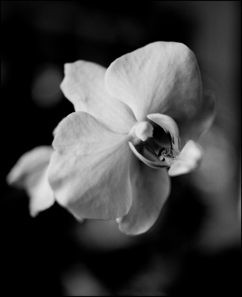

The test of Rollei Retro 100 tonal
The tested film is in 120 and 4x5” format. The film is tested against AGFA APX100 in both the formats. The testpictures is not of a resolution chart but a colourchecker. The distance between the camera and testchart is about 3 meters.
The 120 fomat film is tested with a Hasselblad and a 80mm f2,8 Carl Zeiss
The 4x5” Is tested with a Crown Grapic and a Sneider 135mm f 4,7
All of the test films are shot at ISO 50 and developed in Rodinal 1+100 in 18 minutes. Both the 120 film and both the 4x5” sheets are developed with interventions in the same drum. 3 litre of Rodinal 1+100 was used. The camera settings was F11 1/125 s
This test shows only pictures at normal exposure. In a later post i will show pictures of both films in – 1, 2 and 3 stop under exposure and + 1, 2 and 3 over exposure.
The developed negatives are scanned at 6000 dpi on a ICG 365I drum skanner. Later the negs are adjustet to treshold in Photoshop and the colourspace is sRGB. No other adjustments are done. The pictures are on a external server so 100% crops could be done. One un-cropped picture is added here, so you can all se the distance between camera and colourchecker.
Notice from me:
I have now tested a few rolls of Retro Tonal. Devloped in Rodinal and Rollei RLS. In all the 120 films i have tested i get strange white spots all over the picture in all frames. Its not dust. Its there with both tested devlopers. In 4x5" i have not seen this white spots/specs. You can see them in the pictures from this test also. Since both the 120 films and both 4x5" sheets was developed together in the same drum, its the film who causes this spots. But i really dont know what it is. On the 4x5" sheet i got water drying spots a few places on the Retro sheet, not the APX sheet. After washing with a cavitation washer the film was one minute in Kodak Photo Flo 1:200 for a minute. Dried in a cabinet.
Here are the testpictures:
AGFA APX 120: http://www.tmax100.com/photo/apx_tonal/agfa_norm_exp.jpg
Rollei Retro 100 tonal 120: http://www.tmax100.com/photo/apx_tonal/tonal_norm_exp.jpg
AGFA APX 4x5": http://www.tmax100.com/photo/apx_tonal/agfa_lf.jpg
Rollei Retro 100 Tonal 4x5": http://www.tmax100.com/photo/apx_tonal/tonal_lf.jpg

I fixed the broken link, but the files seem to be corrupt. You might try re-uploading or uploading them here as links (which may entail posting smaller crops).
I don't know that processing and exposing two different films exactly the same way is a good comparison, unless you want to find out if they are in fact the same film sold under two brands. It might be more useful to do the normal Zone System speed and development tests, expose for the same exposure at the tested speed and develop to the same contrast, and then compare the images.
I've also moved the thread to the B&W forum and deleted the duplicate thread. "Feedback and Discussion" is for feedback and discussion of the APUG website.

The links are working fine on my computer. this simple test is more about grain, sharpnes in my standard developing set up for APX100. Rodinal 1+100 in 18 minutes. Film at 50 ISO. This is to se how this film reacts when "used" as APX 100 in my system. I have plenty of this film and can test what ever the audience here ask for.

I'm not surprised that APX 100 looks sharper and finer grained in these tests, but to be fair, the Tonal 100 looks like it needs longer development time and maybe slightly more exposure to have the same density range as APX 100 under these conditions, though judging from shadow areas in the scans (like the shadow underneath the color chart) it looks like the exposure is pretty close--maybe the Tonal 100 could be rated at 40 instead of 50, and then you would just need to experiment with development time. It's hard to judge sharpness when the contrast is different between the two samples, and it's hard to judge grain when the density of the patches to be compared aren't the same. One way to do this would be to make a few clip tests on the same roll bracketing exposures in 1/3 stop increments, and then bracket development for the clips in increments of 10% development time, and then choose the frames from each film that best match.

It's interesting to see in your examples that APX is obviously a lot sharper and has much less grain than the "Tonal". If David is right and the latter is developed too short, what will happen if you develop it longer? Even more grain will be the result. You used Rodinal and Rollei RLS, both are developers that accentuate sharpness, but the "Tonal" still looks pulpy. So, you can't make it look sharper by choosing a developer with even higher acutance, and if you did you would probably get even more grain. So, your examples obviously show all the sharpness you will ever get with that film.
Maybe it's a much more adequate test if you compare this film with something more similar, perhaps Fortepan 200 in Rodinal to achieve a similar amount of grain? It's hard to get that film nowadays, but a film around 100 ASA with similar grain and a similar lack of definition will be hard to get these days. If you compare it with the only popular orthopanchromatic film, Acros 100, the Fuji film will win hands down comparing grain, sharpness and tonality (and price is good, too).

Although the 120-samples are hard to compare due to the variable contrast between samples, some points are clear to see and just as expected in 4x5: More grain with PO100c, less sharpness and a darker red-patch on the color-chart. Contrast is about equal judged by the white-to-black-patches of the chart which are shown in the picture. Have a look here if you don't know what I'm talking about: http://www.xrite.com/product_overview.aspx?ID=1192
Tonal obviously is not a suitable substitute for APX 100 as Robert already clarified over on the rangefinderforum: http://www.rangefinderforum.com/forums/showthread.php?t=90046
Quote: "The only thing they have in common is they are iso 100."
Robert, thanks for clarifying this!

Sorry my brain was in print land. I had figured it had extended red response and hence more density but this is a negative

My contribution.
I have just exposed my first roll of Retro 100 Tonal @ ISO 100 and developed in rodinal 1+25 for 9 minutes at 20°C.
In my opinion, grain is not very thin, but it is very well defined, and tonality is beautiful.
I think that we do not have to compare it with APX but with Acros 100. I'll do the test further. And I'll test other developers too.

The Rollei product looks muddy compared to APX100. Longer development might help some, since contrast is part of the issue, but I can't see it curing the problem. As mentioned by others, grain and sharpness also seem to be inferior.
